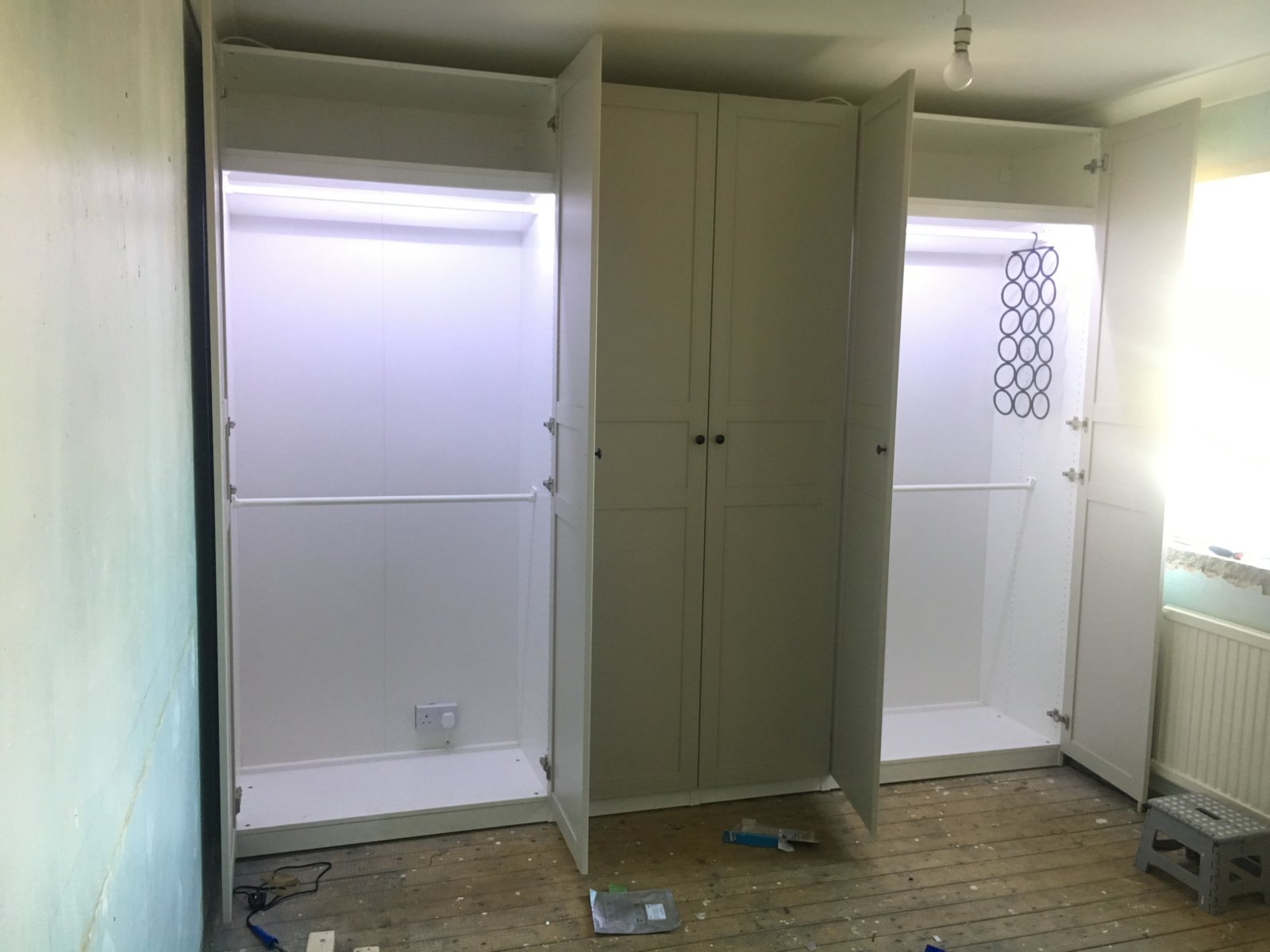

Just to be sure... if I use the wiring diagram that Flameport drew then I'm not leaving anything powered 24/7 am I? This is a nice way to do it? Yeh/nah?
I would certainly say so (and there would certainly be nothing powered 24/7), but I can't speak for everyone!
Kind Regards, John

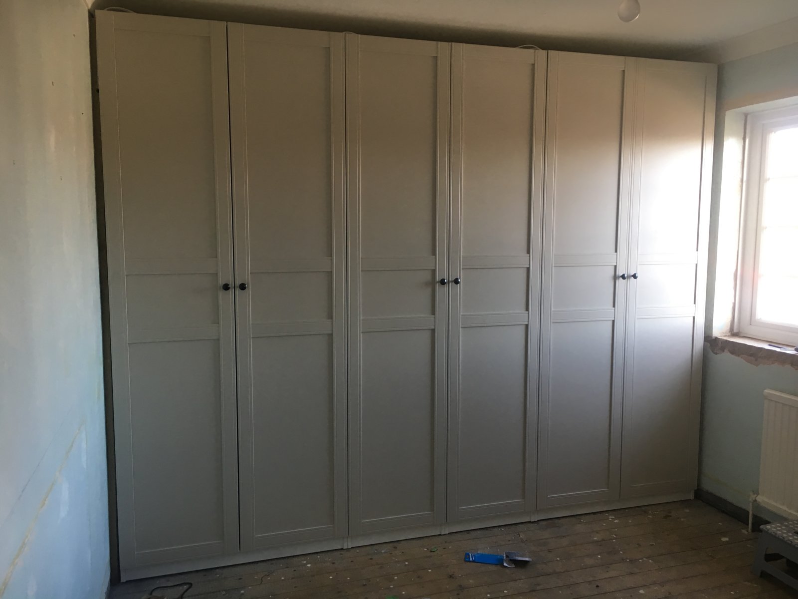

Thanks for all the help, worked out really well!

... so how did you decide to do it, in the end?
Kind Regards, John
I basically followed the diagram that Flameport drew. I got everything from TLC. The switches are all on the 240v side so the driver isn't left permanently on
Thanks for the update. That's certainly how I would have done it.
Kind Regards, John
