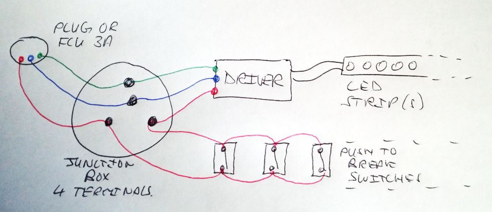

okay so ive realised that certain shelves would get in the way of my LED lighting idea SO im only going to put two 1m strips in beneath a shelf that sits above the hanging space in two of the wardrobes. Just to make sure I've figured this all out... does this make sense now?
PLUG ----> DRIVER ----> JUNCTION BOX ----> SWITCH ONE ----> LED STRIP 1
l
l
-----------------> SWITCH TWO ----> LED STRIP 2
My understanding is that I need the correct wattage driver allowing an extra 20% and that I also need switches that will cope with being permanently live and not burn out.
yay or nah?
**** my makeshift diagram has come out wrong, the "switch two" is supposed to come from the junction box
I thought you wanted
lights which come on when any of the doors are opened
The above will give you two lengths of strip, with one of the 6 doors turning one on, another door turning the other one on, and 4 doors turning nothing on.
Also, check with the maker of the power supply that switching the load side will be OK.
Ah yeah in my haste I forgot about that! So yeah you're right I want BOTH doors on two wardrobes to operate their led strips. Will refer to your diagram and make sure to wire them in parallel on each wardrobe. Think I've got it now (finally lol)
Colours in the diagram:
Green - earth
blue - neutral
red - line
2 core flex to connect the switches. Add more switches in the same way if required, one for each door.

thats perfect thanks mate. So I'll do it that way but need to make sure the switches are suitable, seeing as they are on the 240v side of the driver?
