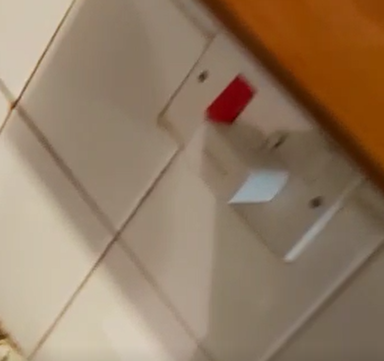

I am replacing a oven under a gas hob (cut into the worktop). I purchased an oven which requires a 13 Amp (Requires hardwiring to a fused spur) connection.
The old oven was connected into a cooker switch via a 6mm T&E cable.
I didn’t realise that the new oven doesn’t come with a new cable and instead, used some 2.5mm T&E cable that I had. Is this adequate?
Thanks in advance

The 2.5mm isn’t flexible but it seems to have fitted ok and tucked behind the oven.
Also, I didn’t notice any fuse in place. There’s a cooker switch above the worktop and this feeds a connection point (no fuse) behind the oven and I have wired my 2.5mm cable straight into here - in the way the 6mm cable was connected.
It's a lot more pliable than 6 mm !!
Heat resistant flex would be better ,but I doubt you will have any issue with T&E. Its not as though the oven gets moved very often.
If you have a 'connection point', easiest thing may be to replace that with a 13amp unswitched fused connection unit, and from there use some 1.5mm2 3core heat resistant flex.

The old one was probably sufficient large enough that it's power draw was too large for a fuse connection so the protection was at the RCD
You need a fuse now as the oven doesn't draw enough power so should it fail it will have no protection and is a safety issue.
Previous oven probably only needed the MCB.
The size of the MCB is not really significant, as at a guess it something like 32 amp.
Fitting the unswitched fused connection unit would be easier than finding and fitting a smaller MCB, and will satisfy the manufacturers instructions if we care, and also allow you use 1.5mm2 flex, which is possibly easier to obtain than 2.5mm2 flex (for a DIYer at least).
