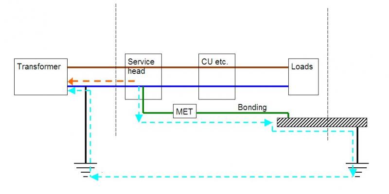

That is true, but it is also true with a single-customer TN-C-S supply. The path to earth back to the transformer via bonded items is in parallel with the 'proper' route via the supply N/E conductor - the return current to the transformer will therefore be shared between the two paths. If, as can happen, bonded water supply pipes provide a very low impedance path, a substantial proportion of the total 'neutral' current can flow via that route - hence the requirement for larger bonding conductors with TN-C-S installations.
Thanks. You last point is the only one I don't follow. I think I will need to draw it out, and maybe that will make it clear. Or if not maybe you'd comment on my drawing. For the moment I can't see how E and N form a parallel circuit - within my installation N is completely separate from E. The two would join at my end of the supply cable (assuming TNCS). The supply PEN in turn only connects to true earth at one point, at the supply transformer. How does any of my neutral current make it's way off the PEN to seek an alternative route?

See diagram - the two dashed lines show the two parallel routes whereby return current can get from the loads in your installation back to the transformer. In my installation, the impedance of the path via bonded pipes is about 0.3Ω - which means that if I had TN-C-S (which I don't) a substantial proportion of the 'neutral' current from my installation would probably try to go via that route.
Does that help?
Kind Regards, John

As I've just illustrated, if it were TN-C-S you could well have 'some power' if there was a fairly low impedance return path (such as I have) back to the transformer via bonded extraneous-conductive parts.
If you didn't have such a low impedance parallel return path, you might appear to have 'no power' (no current) - but, if you had any load connected to your installation, all of the exposed-conductive parts within your installation would rise to a very high potential relative to true earth - so you'd have to hope that you really had engineered an equipotential zone within your house! Of course, the most obvious reason for not having a low-impedance parallel path would be the absence of main bonding - in which case you really would be at very significant risk (and a risk that an RCD would not protect you against).

Thanks, the drawing makes it clear, can't believe I couldn't see it without (I hope you didn't have to draw it specially). I'd be pretty amazed if any of our metalwork has that low an impedance back to the transformer via earth, but can't realistically measure it so will have to assume the possibility. I'm really hoping the DNO will confirm TN-S.
You're welcome. It didn't take long to 'draw'.
If they are just ordinary domestic outhouses, it's very unlikely that they will provide a very low impedance to earth (hence the transformer). It's generally bonded water/gas supply pipes (if metal) that can do that. If you had a clamp meter, you could measure how much current flows in your main bonding cables when you have large loads (e.g. shower+cooker!) switched on to give you some idea.
