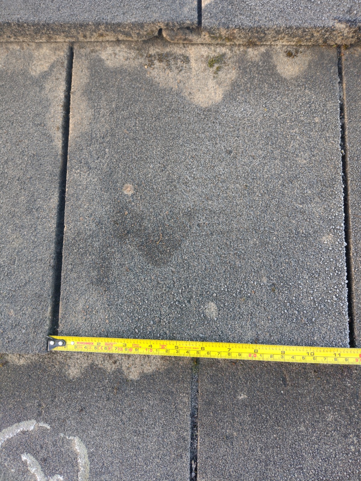

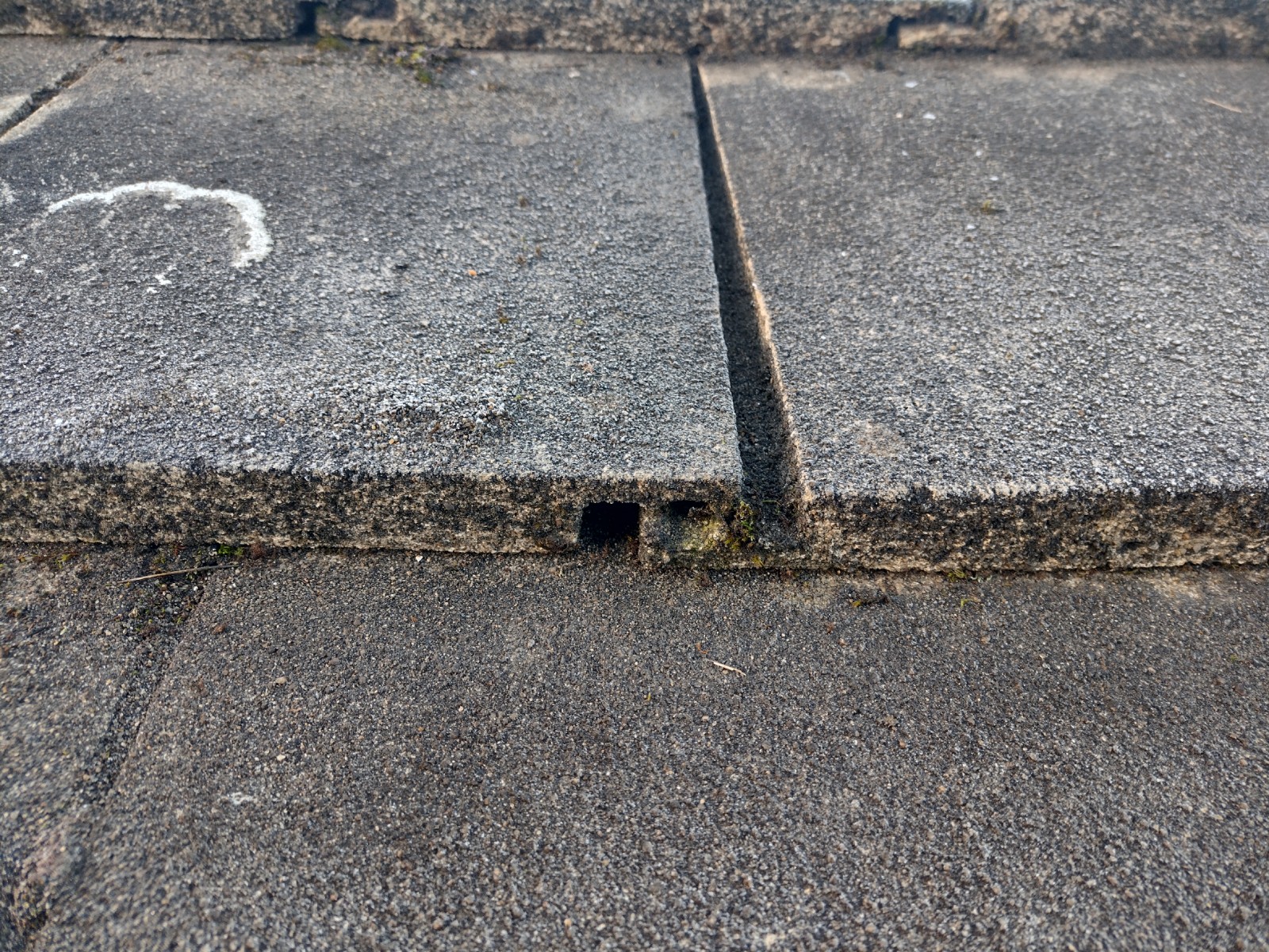

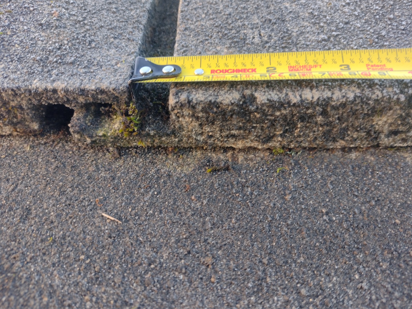

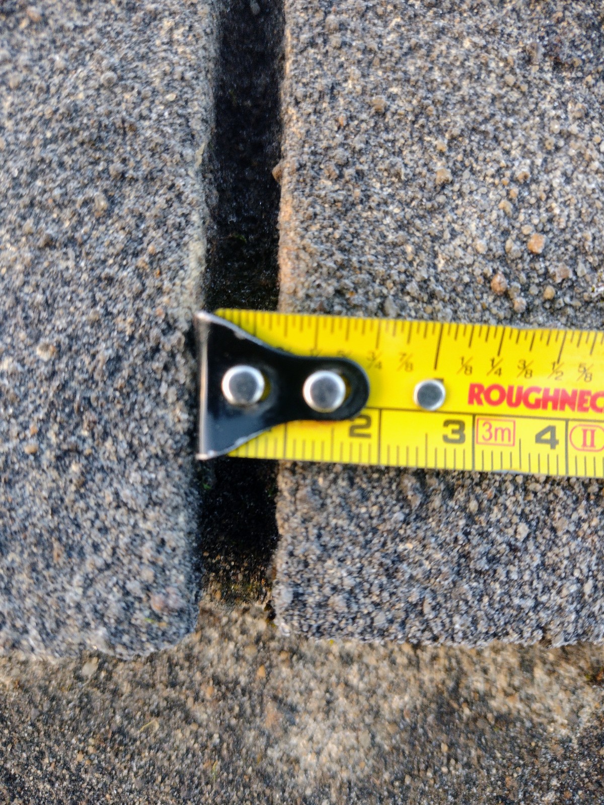

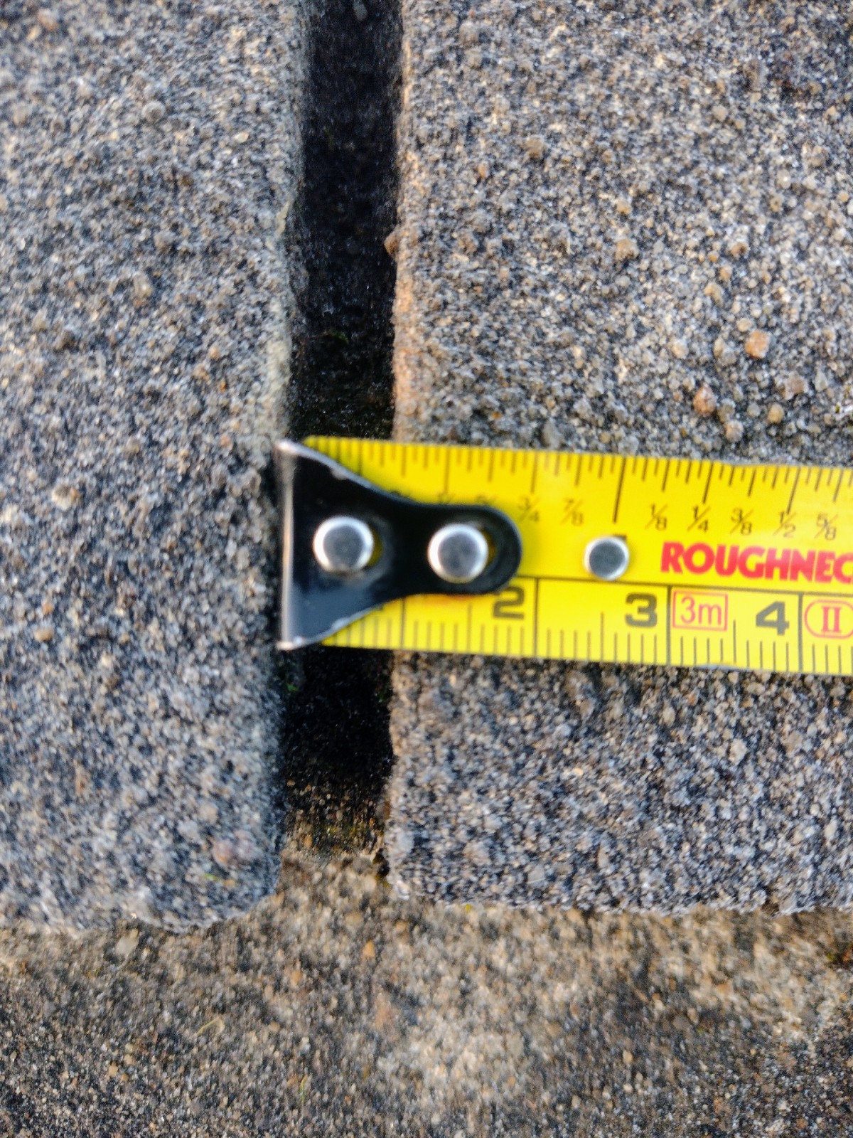

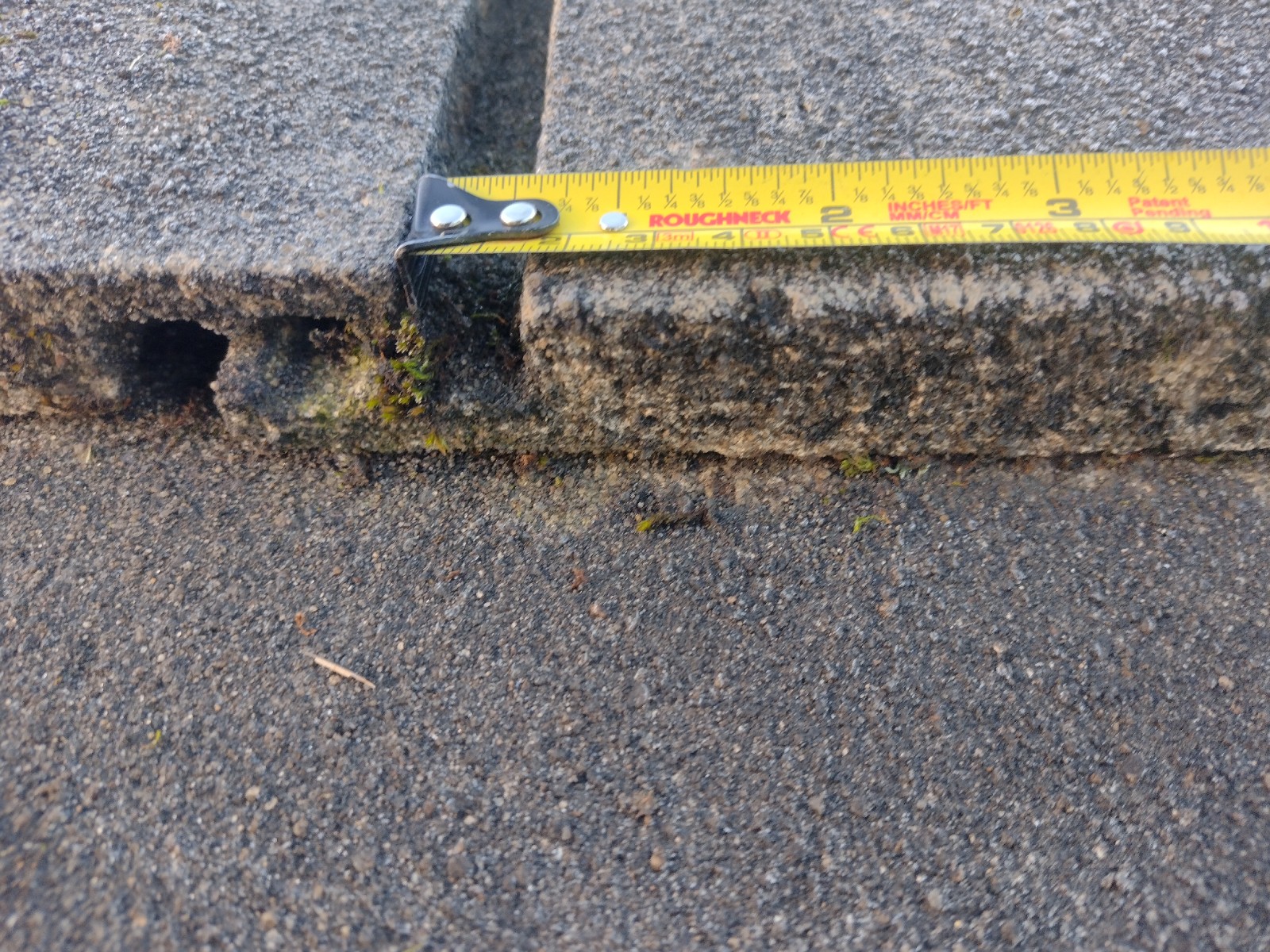

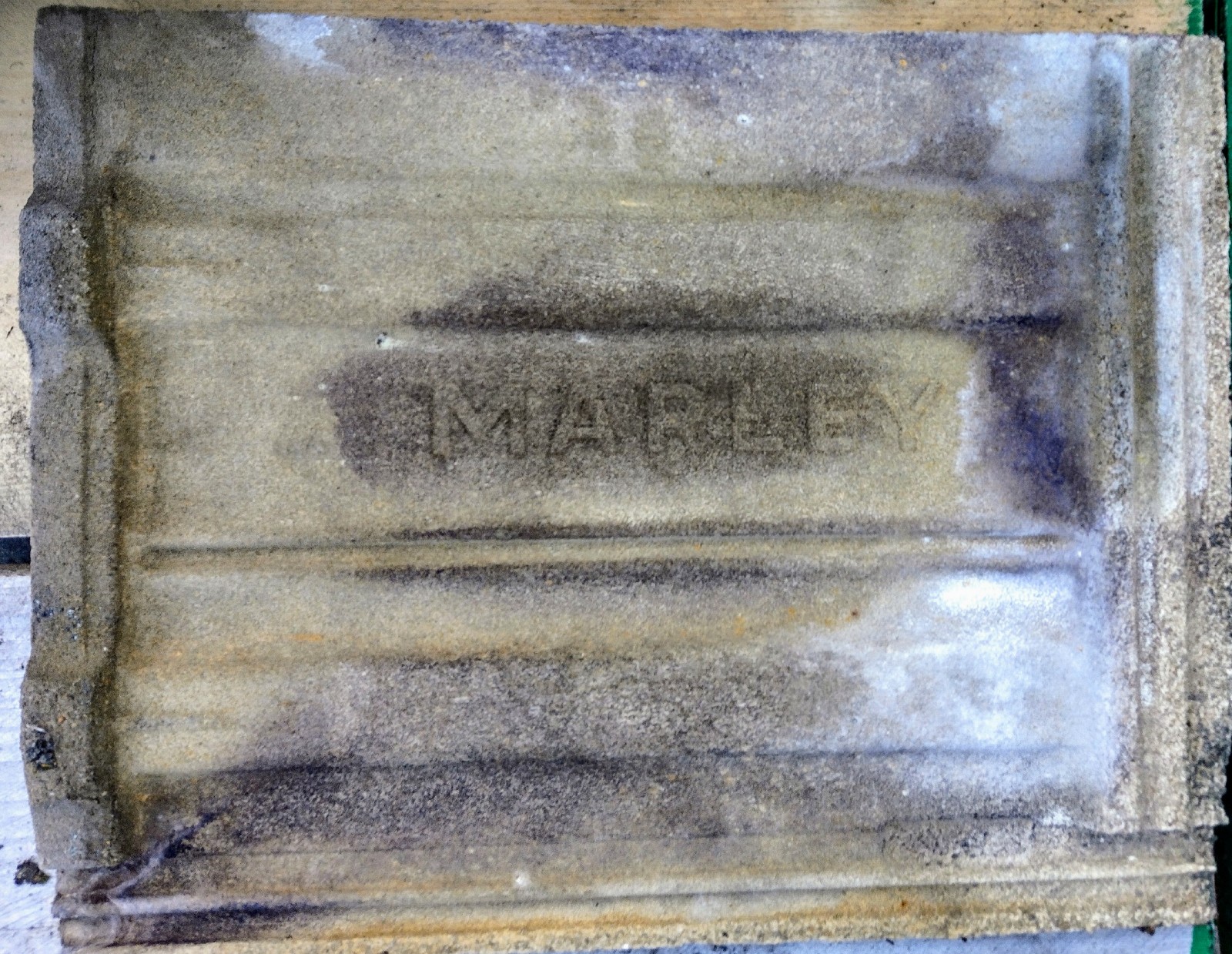

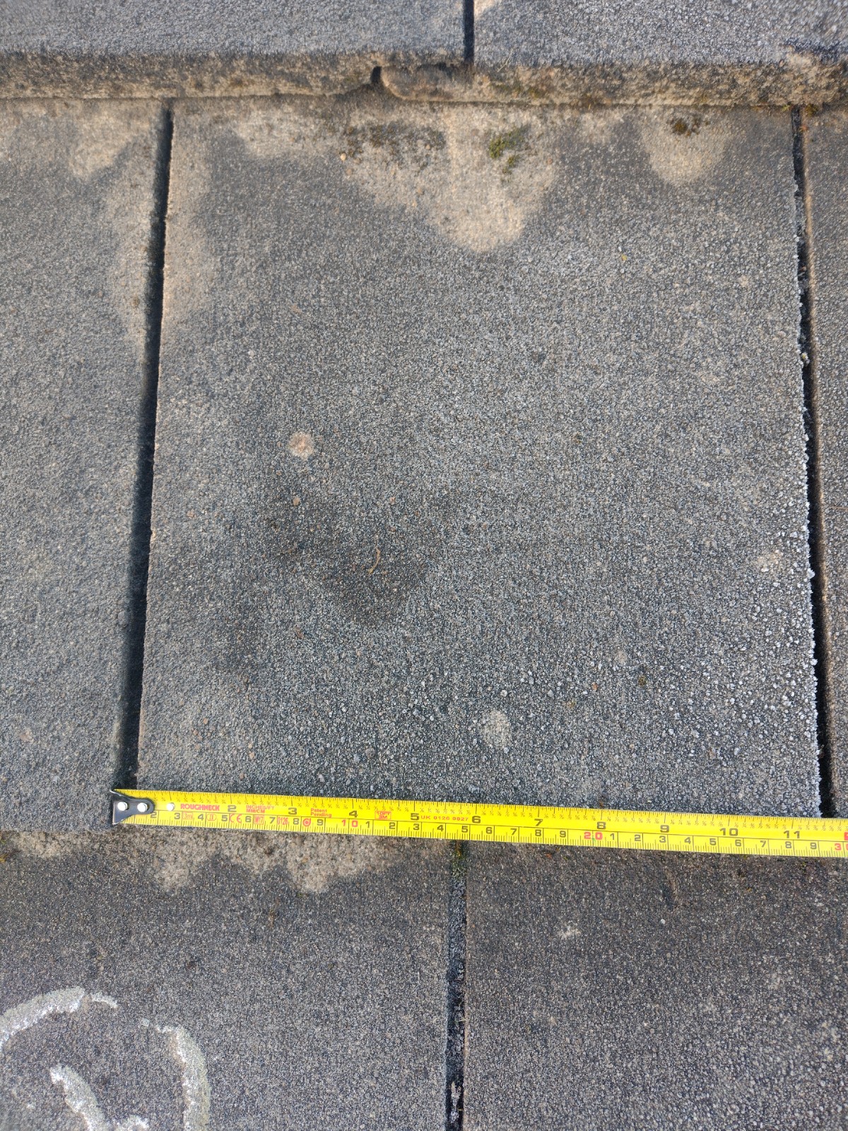

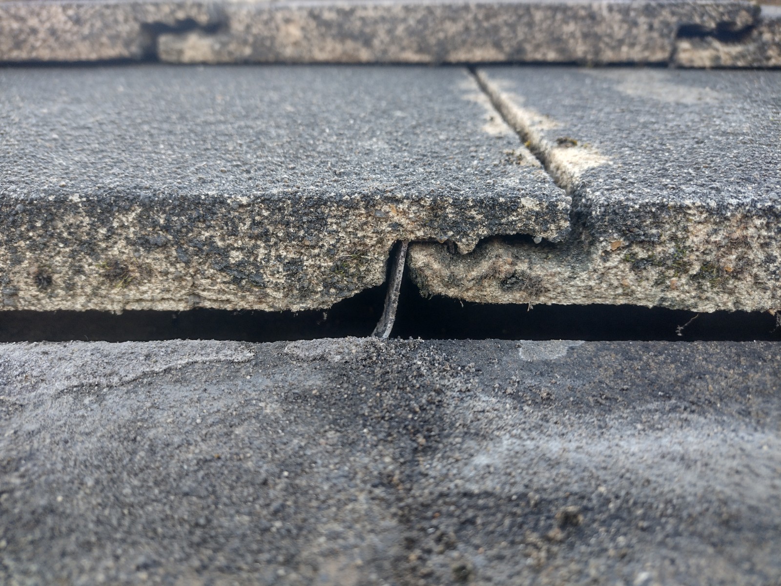

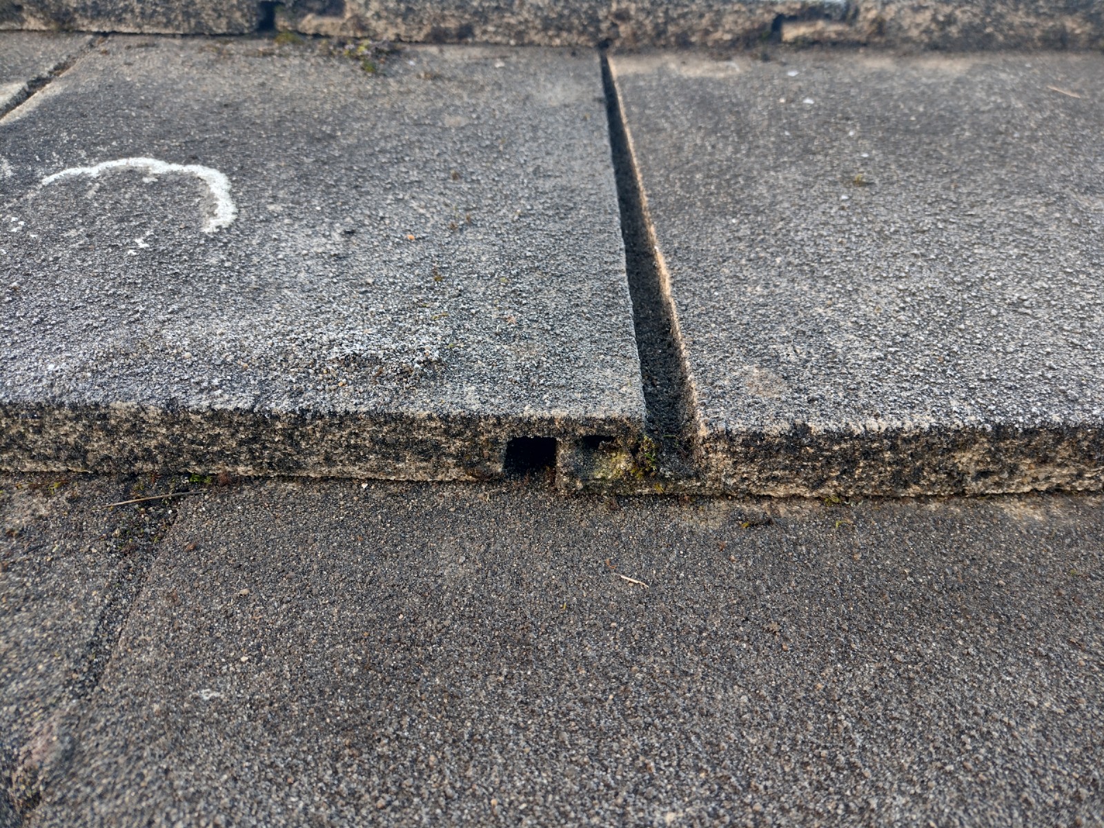

The Marley interlocking roof tiles appear to have a worryingly large gap (10mm) in many places (pics attached). Should I be concerned about this?
Many of these gaps were filled with moss/ dust and soil. The neighbours (terraced houses) also have the occasional large gap

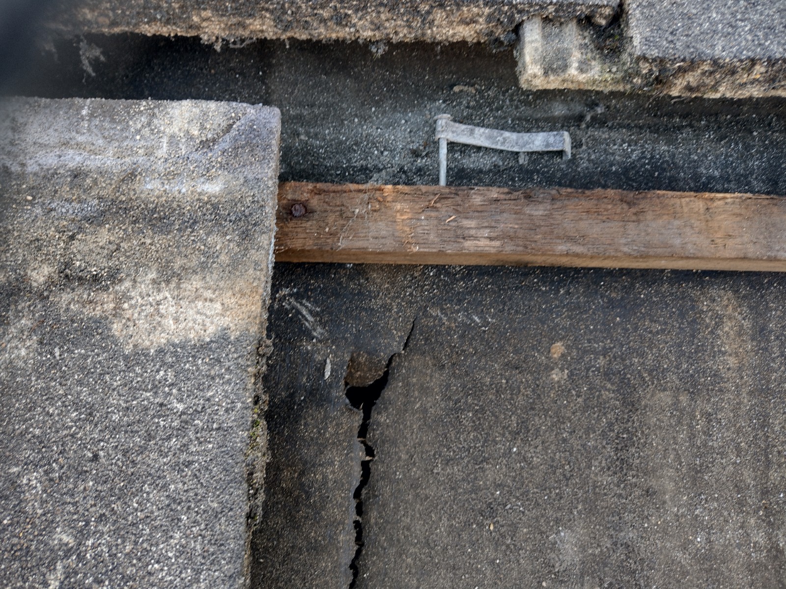

Removing the tiles, I noticed an interesting detail. The installer of the roof appears to have hammered a nail into the batten and then the metal piece, ties into the groove of the interlocking tiles (pics attached).
Was this normal back in the day? Is the purpose to keep the tiles locked in place?
Is it important to keep this detail?
See page 58 of the Marley installation guide I linked you to
Perhaps one of the two tabs at the top of the tile, that keep it on the batten, has broke off and the tile has slip rotated. Or perhaps the batten isn't straight or rafters are not coplanar. When you install new battens and repair/replace the roof things will (can) look better/more uniform

So according to the Marley guide, the ‘eaves clips’ are optional (i.e. installer can either nail tile, use eave clip or both). Also, if fitted, eaves clips should be installed on the eaves course tiles.
Given the above, it is baffling why the the existing roof tiles have eaves clips installed on rows of tiles above the eaves course?
Given the pic/size of the gap between some of the tiles (ie. 10mm) could this be a cause of the water ingress?
Or would you expect water to still flow down the groove of the tile even if there is a gap?
