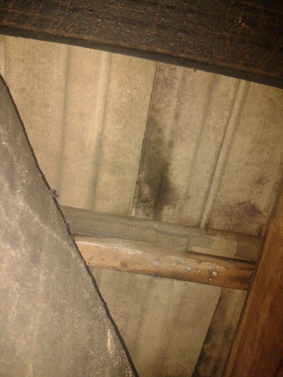

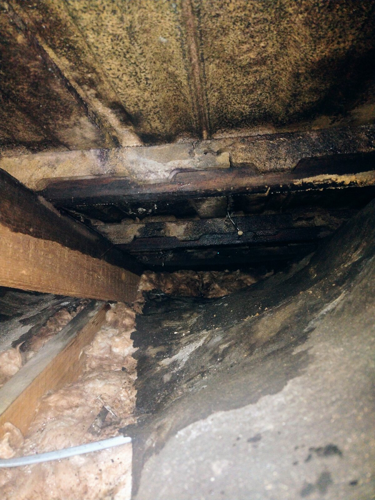

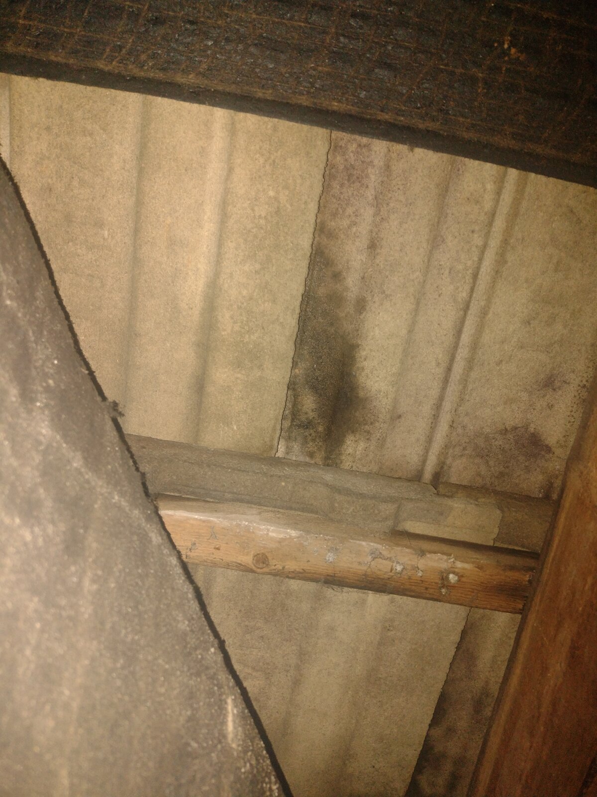

We had some rain and when I removed the tiles, the back of the tiles were wet as if rain has penetrated through and the batten (at least in the lower half which o exposed were wet.
Is it a no brainer that these roof tiles will also need to be replaced?

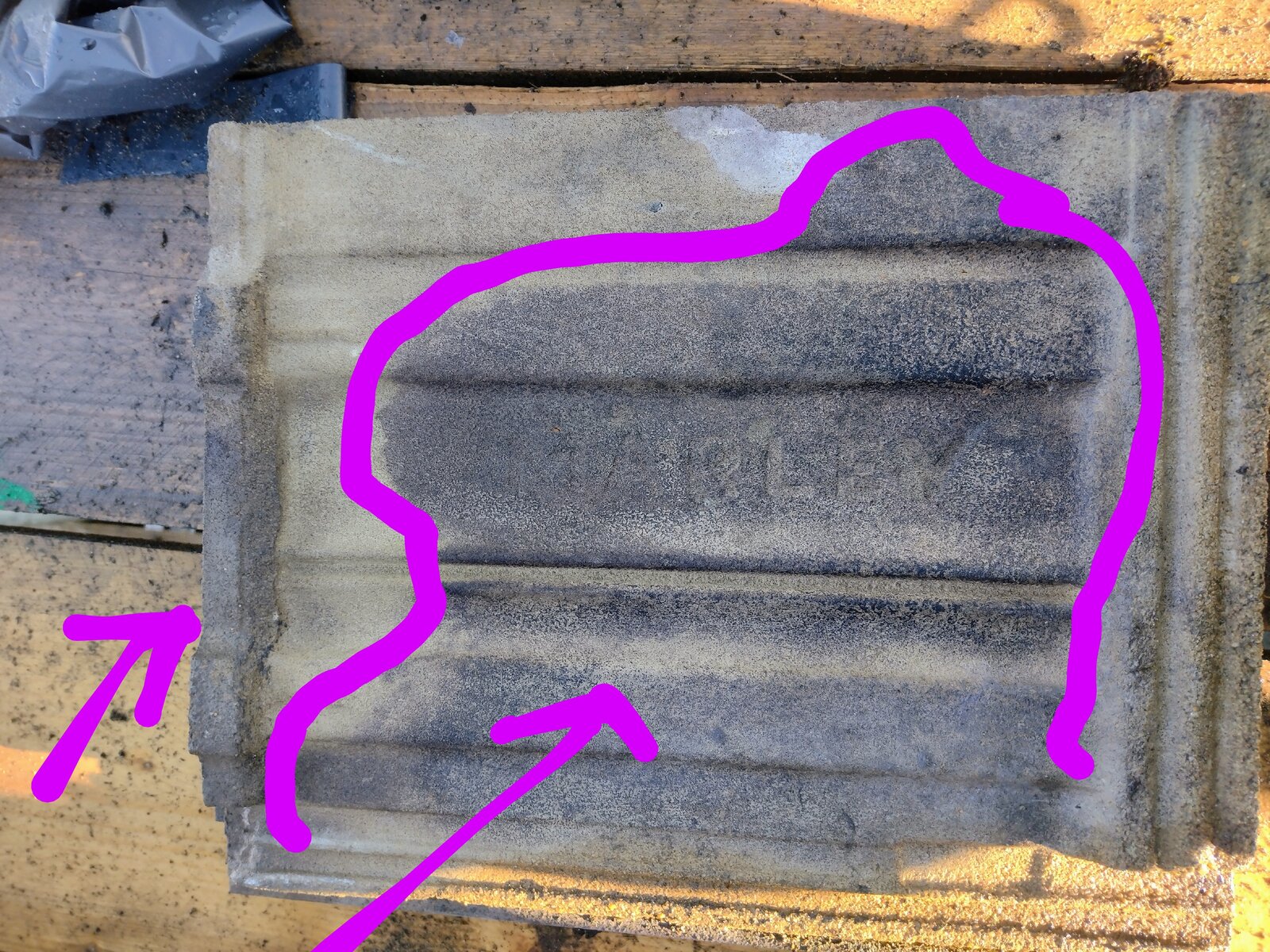

Concrete tiles can degrade and become porous; lay one flat and see if you can get a puddle on it or make it into a shallow bowl with sealant and fill it to see how bad it is. If the underside is becoming damp with water soaking through then come cold weather trapped water will start jacking the tile apart if it freezes, accelerating the degradation. Tiles showing signs of being porous should be replaced
Might not be sound to assume that water on the back of the tile is rain though; if the tiles were cool and there is warm moist air in the loft space from human activity in the house the damp on the back of the tile could be condensation. Check independently whether water is coming through the tile in a more controlled experiment

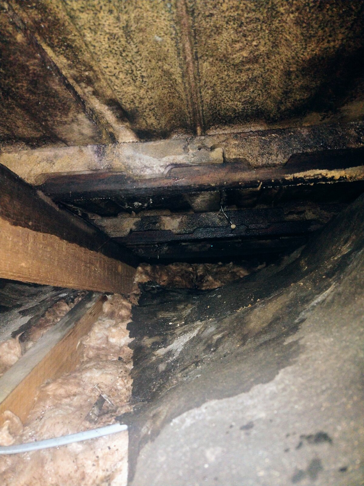

I very much doubt this is mainly condensation, given the water ingress in lower portion of the roof.
In the first pics, the underside of one tile (not a problem area) is mainly dry. There is a tiny bit of dampness where as seen where the tile is dark. But no water ingress here.
However in the problem area, the batten, and underside of tile is soaked. The batten is very dark and I have coloured the areas where this is tile is wet.
I may just replace these as it will be a quicker job and i will have piece of mind knowing that these tiles are new/defect free.

Many of the old tiles in the problem area seem like they are defective (allowing water to penetrate through), so will probably replace these with new Moderns although given the slight size difference could this pose a problem?
