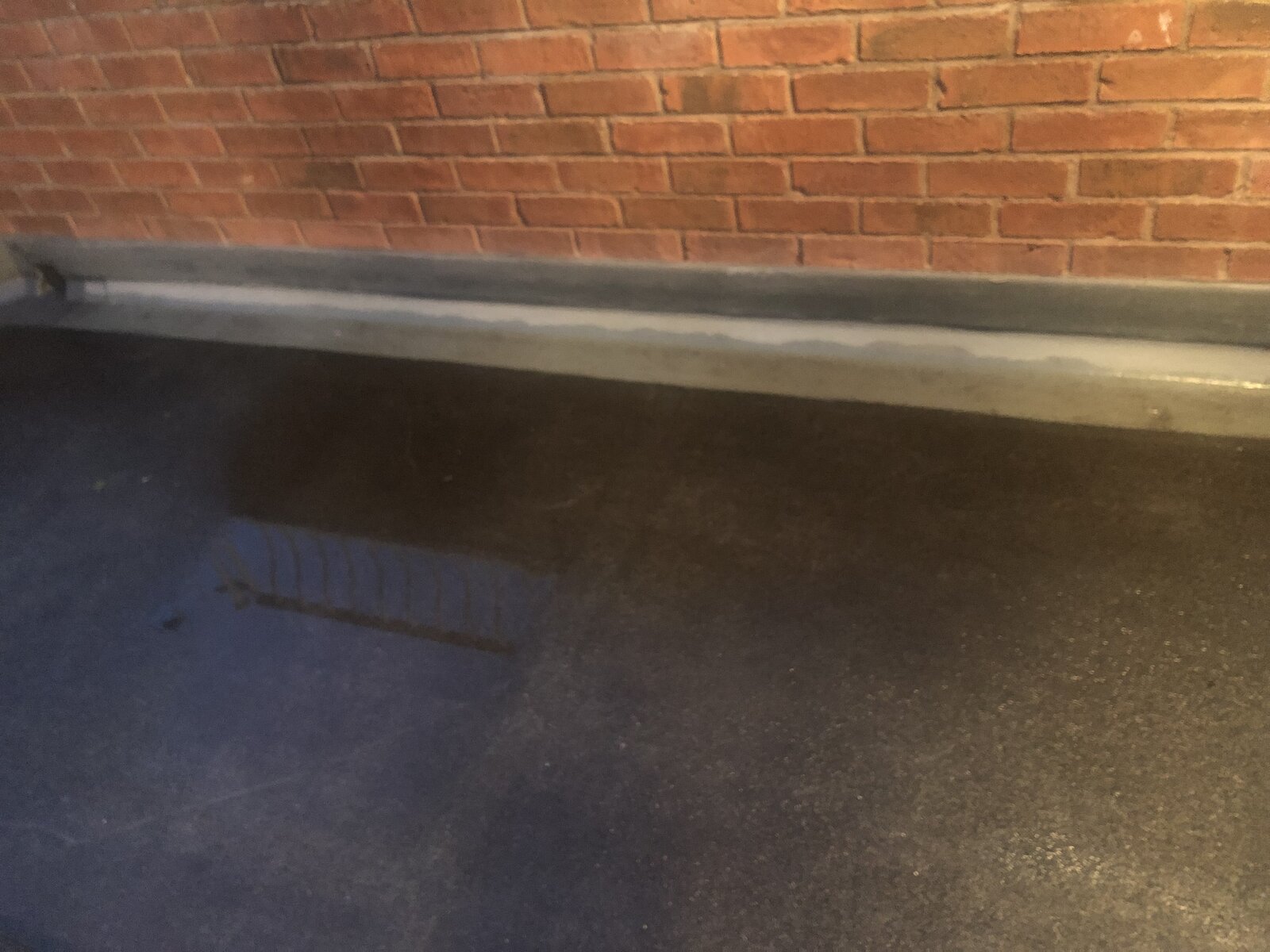

Can faulty coping stones cause major internal damp
Trays should exist on a cavity wall like this one appears to be . Not just over windows and doors .
Pointing around the railings won't help slot as the metal will expand and contract.
On the inner skin mitred corner is a cut brick joint vertically water could get in there .
Assuming , the grp roof is intact then the water will be going through the brickworks

Ok … so it appears I need a builder to check if there is a DPM within the balcony wall, deal with mortar issues , especially at mitred internal corner, Check condition of vents in brickwork and possibly replace coping stones to allow more overhang . Remove railing to check how they are fitted within brickwork. Is that correct chaps?
This has been an eye opener as without this advice I was about to have spent up to £9000 stripping out a balcony floor , etc. The roofers did not give any credibility to the notion it could be to do with the wall and coping
For completeness , if anyone is still reading this , after a little rain last night this is the typical pooling that now occurs on the part of the balcony floor over the damp ceiling area below . No visible damage to surface covering but slight lifting if you push it down compared to rest of balcony. I have sent out a request for a builder via the internet. Any further feedback to help me at this stage gratefully received .

Yes you can get pooling on flat roofs.
