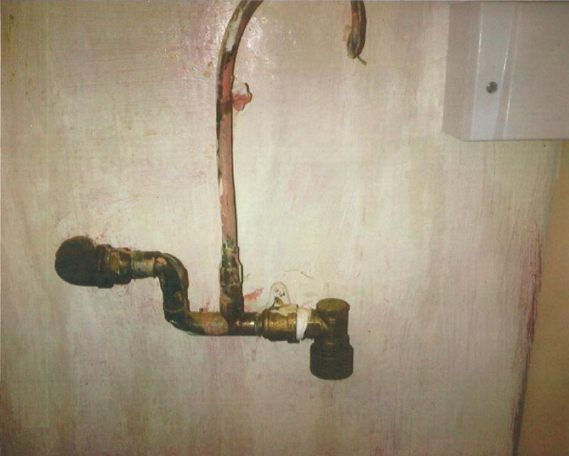

Look at the pic above, this is how you left it, yes?

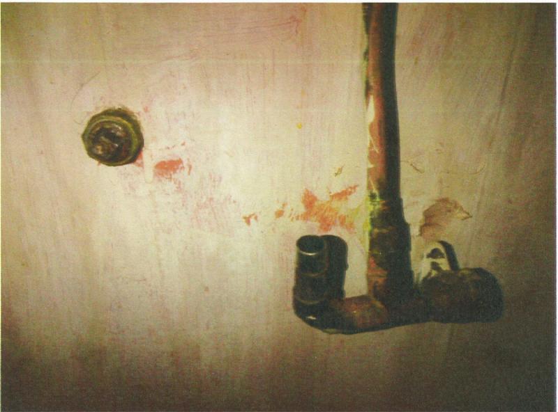

Now look at this picture, the outlet and pipe work is still attached and in situ but a small section of pipe has been taken out, looking at the breakdown of fittings you can safely assume that the soldered elbow has been unsweated and then the whole section has been pulled up and out of the fitting and then unscrewed out of the theaded joint in the wall, the pipe in the wall (the section that comes out of the leaking fitting) was not gripped or supported while this was getting unscrewed ( evident due to the fact that there is no damage to the wall in the capped off photo.
Likely scenario
The engineer, heated up the joint to unsweat it while gripping the section off pipe with a tool such as pipe grips or similar
The heat from his torch melted the solder in the joint but being in close proximity the heat traveled up the pipe also melted the solder in the joint in the wall. He then proceeded to lever the pipe up and out of the fitting and then carried on unscrewing the whole section out off the fitting in the wall and in doing so weakened the joint in question causing it to leak.
I'm sure most will agree

In the opinion of all the RGIs here, its most unlikely that any leak would have been made by knocking a PROPERLY made pipe.
Even so, we all consider that spending FIVE hours working there was totally excessive, even allowing for taking so many pictures ( evidence of someone who knew it would be questioned ? ) and most of us would have said about 1.25 to 1.5 hours with perhaps 2.0 hour for the slowest person.

OP is that the highest resolution pic you have of the pipes laid out on the floor ? as if we could get it as big as you have we could look at the small piece of pipe of where the leak was to look at the solder.
I still stick to my orginal posts IMO there is no way by you removing your electric cooker could you have caused that leak, i also agree that the tightness test is being done incorrectly with his Anton

plus for the OP to have caused this leak there would be damage done to the plaster around the FI/copper & as the pics clearly show there is no damage to that wall at all.
Any judge with any sense would throw the HA case straight out it is so full of holes it is laughable
