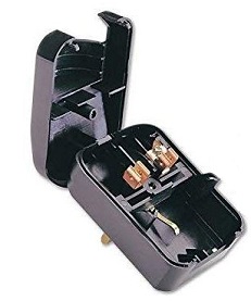

Can I cut this plug off and replace?
Status
Not open for further replies.
UK electrical systems are different to the rest of Europe, where sockets are connected to circuits rated much lower at 16A, as opposed to 32A in the UK. Therefore in the UK our plugs incorporate a separate fuse suitable for the appliance / cable connected to it.
As this plug is designed for use with a lower rated 'European' electrical system, it doesn't incorporate a fuse
And as far as I can tell, neither does this; in common with a lot of similar devices.
Which means that when used in the UK anything connected would only be protected by the 32A overload device in the consumer unit. :eek:
I work in the UK for a large German company and we often get kit with European plugs on, which we simply cut off and fit a standard UK plug with a suitable fuse.
That particular adapter does incorporate a fuse.
But the fuse is to protect the cable not the device on the end of it.
OK thanks, I can't see it in the photo. Most I have seen don't.
