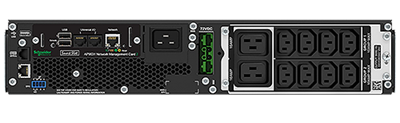

The starting point for this question was an image of the back of the unit:

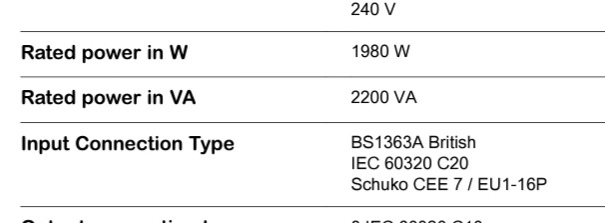

According to the specifications the input is a "IEC-320 C20, Schuko CEE 7 / EU1-16P, British BS1363A".
Output power capacity is: 1.98 KWatts / 2.2 kVA
This would imply a 13A fuse in the appropriate lead would be ok.
I think this lead would be fine.
Thanks.

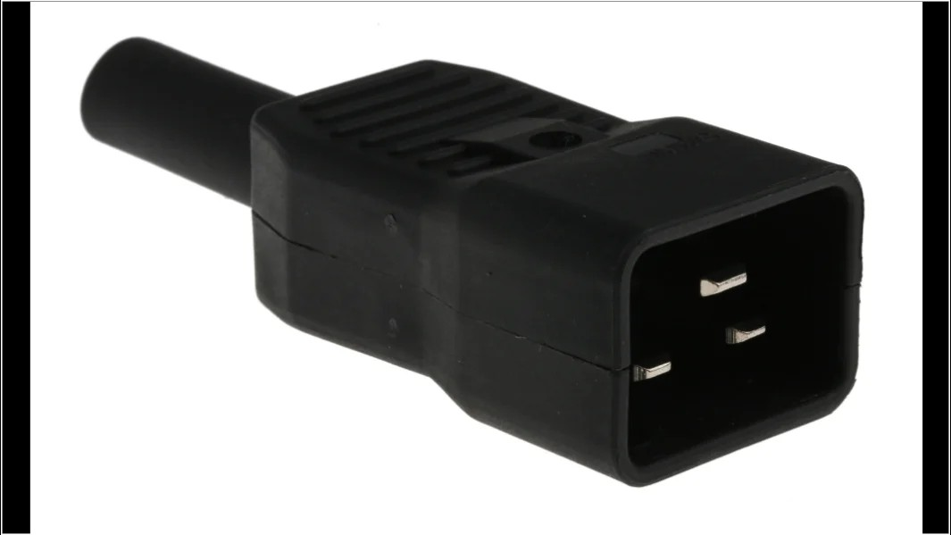

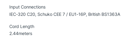

Which means it comes with three leads* - one with a Schuko plug, one with a C20 plug... and one lead comes with a standard UK plug.
There is no need to worry, it will plug straight in! :)
*Confirmed from the datasheet..

. So you think one of the leads is just a 2.44m C20 extension lead.
And yes.
I looked at the URL of your image, and it reffered to the SRT2200RMXLI that does seem to be ok
Note however that the larger 3000VA model from the same range has an explicit warning about supply from 13A plugs.
RISK OF FIRE, RISK OF DAMAGE TO EQUIPMENT OR PERSONNEL
The SRT3000XLI, SRT3000RMXLI, SRT3000XLW-IEC or SRT3000RMXLW-IEC UPS should not be
continually operated at full power below an input voltage of 220 V when powered using the BS 1363 (UK) to
C20 cable.
Failure to follow these instructions can result in minor or moderate injury.
