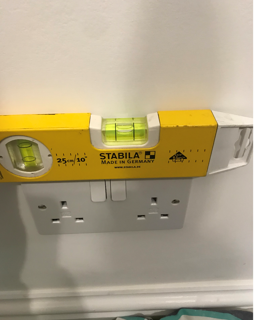

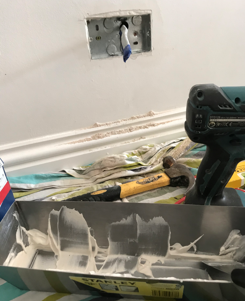

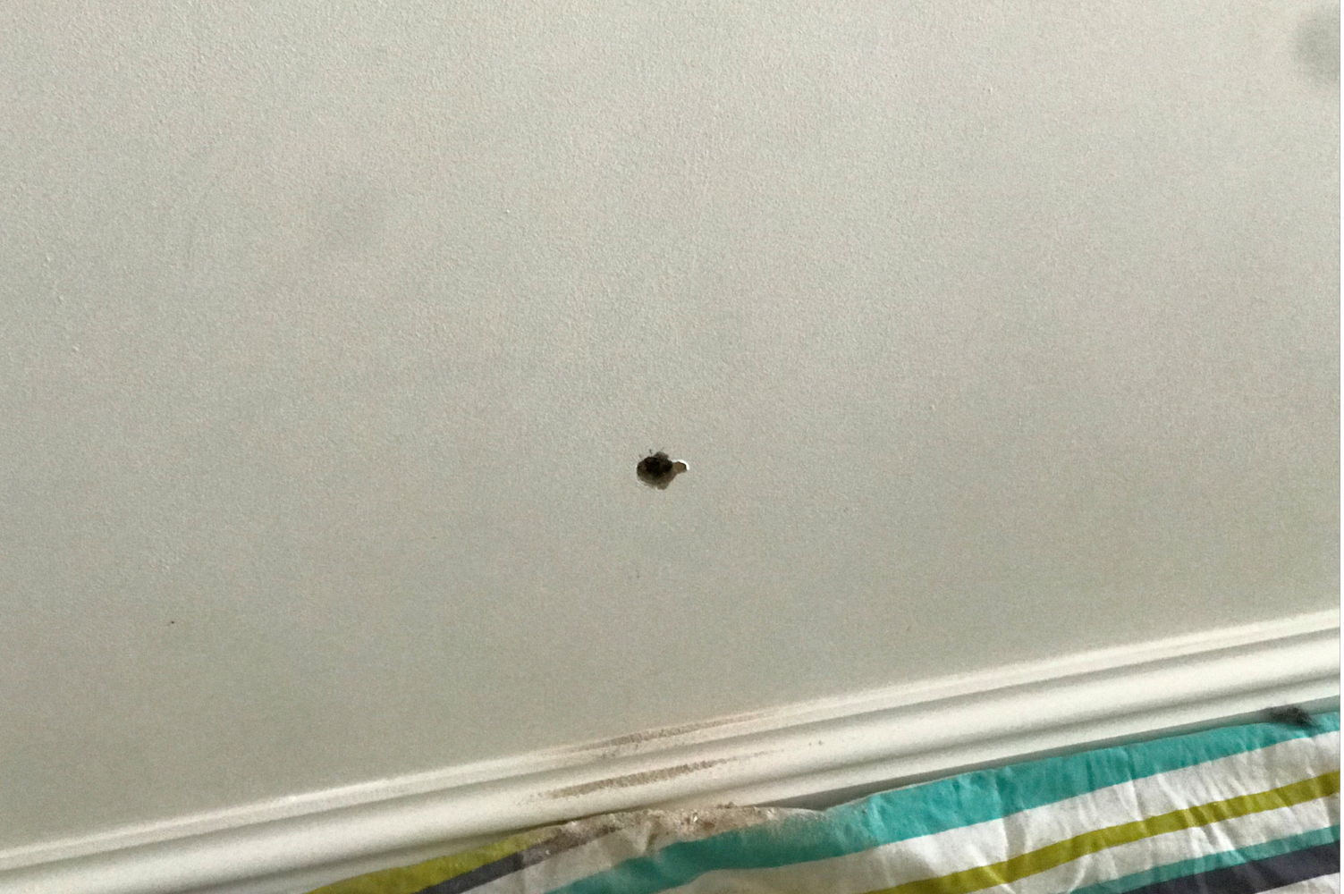

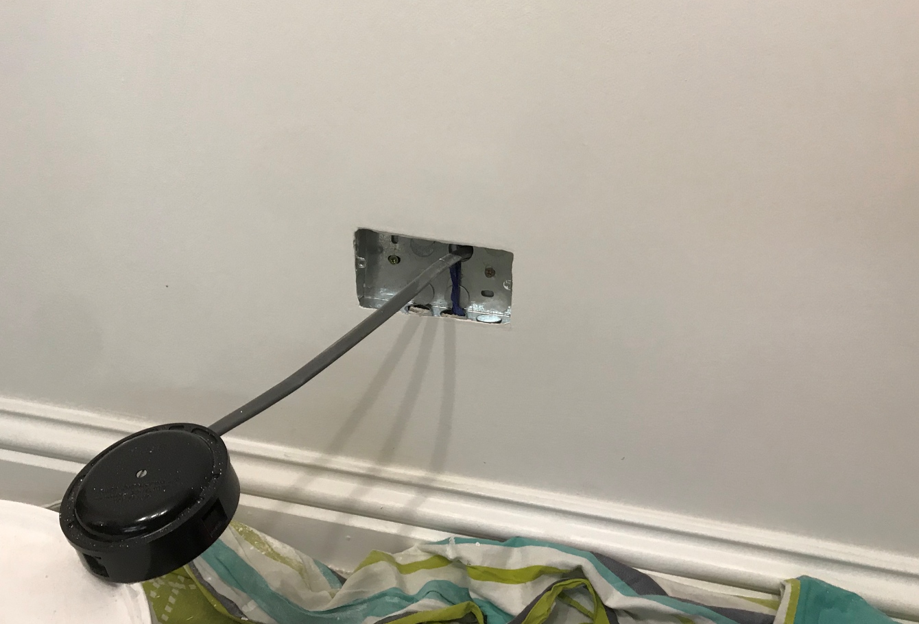

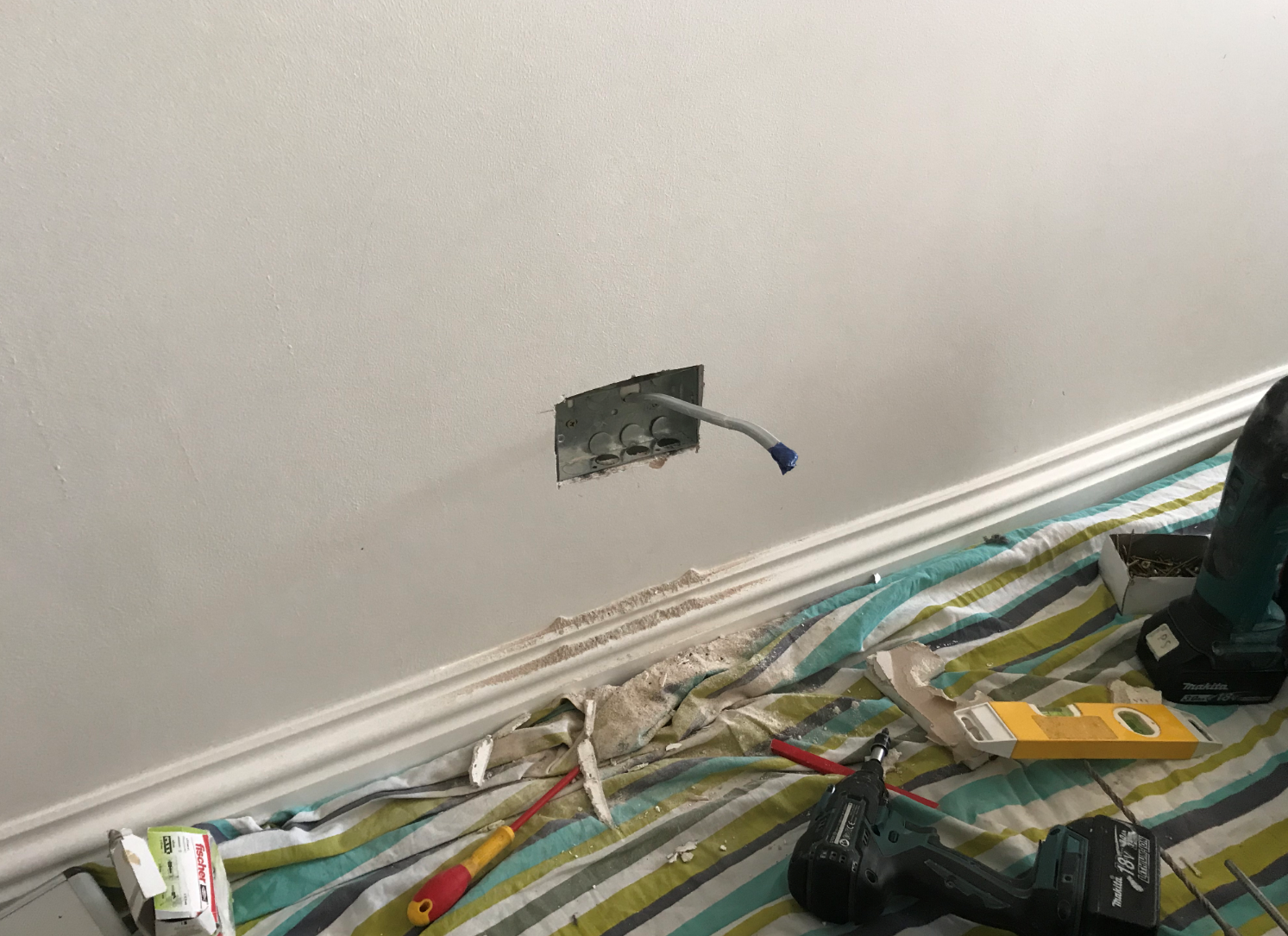

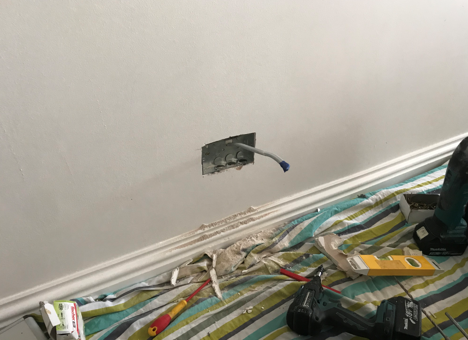

Thanks all. I struggled with getting 3 x 4mm cables into the MK socket I purchased from Toolstation. I used 2.5mm for the spurred socket to overcome this.
Some pics from this project:
Thanks again for all your help.
P.S. I've noted a missing grommet and would welcome any other feedback.

Ah. In my experience, MK sockets have at least as great terminal capacity as any other make (more than many makes), and I (like others) have certainly had no problems getting 4 x 2.5mm² cables into the terminals with no trouble, and would have expected 3 x 4mm² to fit. Twisting them together will make the situation worse, rather than better.
However, the specification of (current) MK sockets certainly claims that they should take 3 x 4mm². Do you perhaps have an 'old' one'
Kind Regards, John
For what it's worth I recently changed a K2948PCR as fitted in an 18 month old kitchen. Usual problem of MK plug on washing machine welded into socket.
I found 3x 7/0.029 ring and 1 harmonised 2.5mm² in a 47mm back box some ½" behind the tiles surface. Plenty of slack to work with etc.
I cant remember which but one terminal accepted the 4 wires with total ease but the other was a real no go and a total surprise.
In another similar socket I found 2x 7/0.029 ring & 1x 6mm² spur [old colours so I suspect it was the original cooker cable] and swapped the sockets over with ease.
Even now it doesn't make much sense as the 2 didn't look any different but the size of one terminal was obviously enough different.

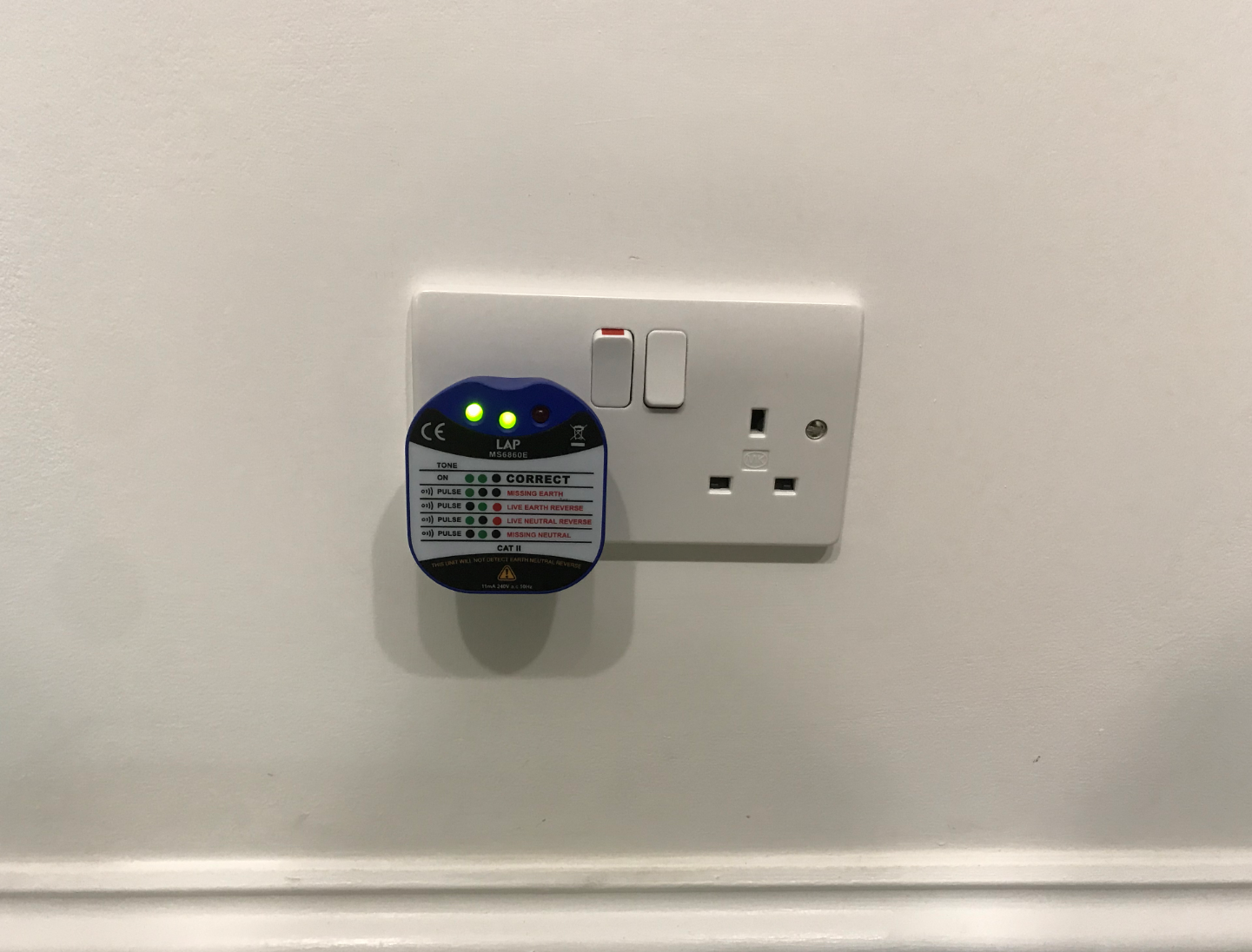

I just looked at that LAP tester. Now, I know it’s cheap, but my first glance was that there was a fault!
Any decent tester would show all greens for a 100% OK test.
But Don’t like to complain…
That was also my first reaction, but ...
I suppose it's fair to say that all the lit LEDs are green. The difference between this one and some others are that they are single-colour LEDs, the one on the right being red - which one would expect to light up (red) only if something was 'very wrong' (which they apparently do, for L/E and L/N reversals). Others have two-colour LEDs, facilitating the "3 greens" indication that you would have preferred to see.
Kind Regards, John
My Martindale has just the 2 greens too.
Just under the LED's is the descriptor showing: green green black CORRECT
Yes, I understand. Maybe its because the ones I'm used to Shout at you, or flash or change colour is there's an error.
Yes...
I thought I had the box level but then learnt that it needed some further jiggery pokery. Nothing that Toupret couldn’t bury
How would this tester behave if only 1 of the 2 Live cables were connected to a socket on a ring main?
