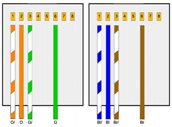

So it is perfectly feesible to add an ethernet socket beside your master and the first extention sockets and just use those 2 pairs (orange and green with their whites) This will only give the option to have one ethernet point at the location of the first extention socket.
Additionally it is feesible to use a double ethernet socket at the 2 locations and the second wired using 1/2 (blue-white/blue), 3/6 (brown-white/brown).

Thanks Eric, the only bit I'll correct is the ringing current is AC not reversev polarity.
And thanks for the pics, my suggestion for 2 sockets on the same cable:
