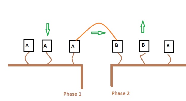

Ok, to skirt the interference issue, which I'm not concerned about, perhaps pretend that I am linking two routers on separate phases with an FTP Ethernet cable. Can anyone see an issue with this?

But regarding them being on different phases, YES IT WILL WORK.

Surely for the adaptors to communicate with each other, they have to be on the same conductor
Hence the data bridge that Mecca has created.

The data link between System A and System B is a weak point as the two items in close proximity but operating on different data channels may mutually interfere creating lost packets and the necessary repeats.
If the data link system A <-> system B is constructed with PLC units that have only a two pin connection to the mains supply then the risk of voltage breakdown across the isolation barrier in the PLC units is increased. Base line potentials for system A on Phase 1 and system B on Phase 2 may differ by over 400 volts when the isolation barrier withstand voltage is designed for a 230 volt base line potential
( Two pin mains connections deprive the item of an earth reference for the data circuitry. As a result the data circuitry may assume a base line potential somewhere between the neutral potential and live potential )
Thanks bernardgreen. This kind of makes sense. The TP Link provides a reference to earth so this isn't an issue. You mention that proximity could be an issue, which I don't entirely understand but I'll bear that in mind. So far nobody has said 'OMG, you can't bridge two phases with a data link' so perhaps it's not something I should be concerned about.??

Happens in pretty much any medium to large office anywhere surely? So it won't matter.
There'll be a data room(s), which itself would be using all three phases in the server cabinets. Or maybe a large 3 phase UPS, supplying various servers, network switches, all of which be interconnected on the network .
All the PCs, laptops, networked printers/copiers etc in the office space will all be on various phases, etc, etc. Again all connected via switches on usually (ie 2 out of three times!) other phases.
But, as others have said, avoid those cr@ppy powerlink thingys!!! Is there not even a phone line running from the house to the guest house, I'm not suggesting paying for two broadbands, VDSL adapters can be used to network over old phone lines. Higher initial cost, without the ongoing cost of paying for two broadband packages.
