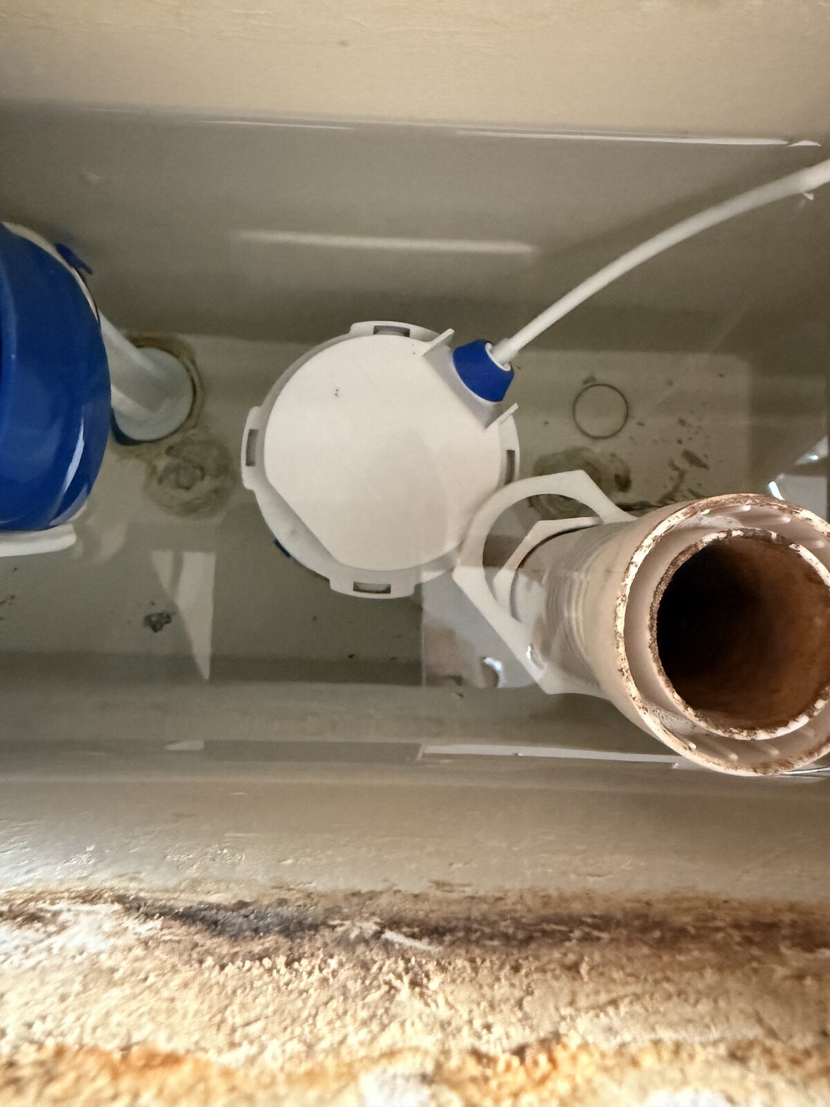

Can my WC flush valve be repaired in situ?
Show me a picture and I can show what you need to fit or to adjust.

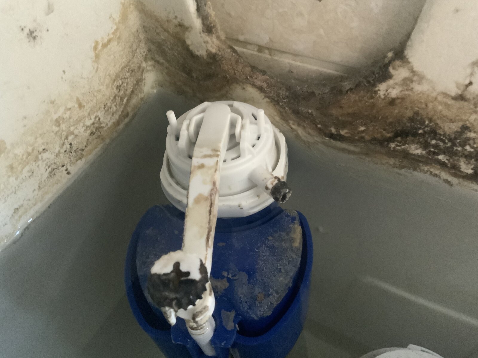

Whoops, forgot to add pictures in last post.

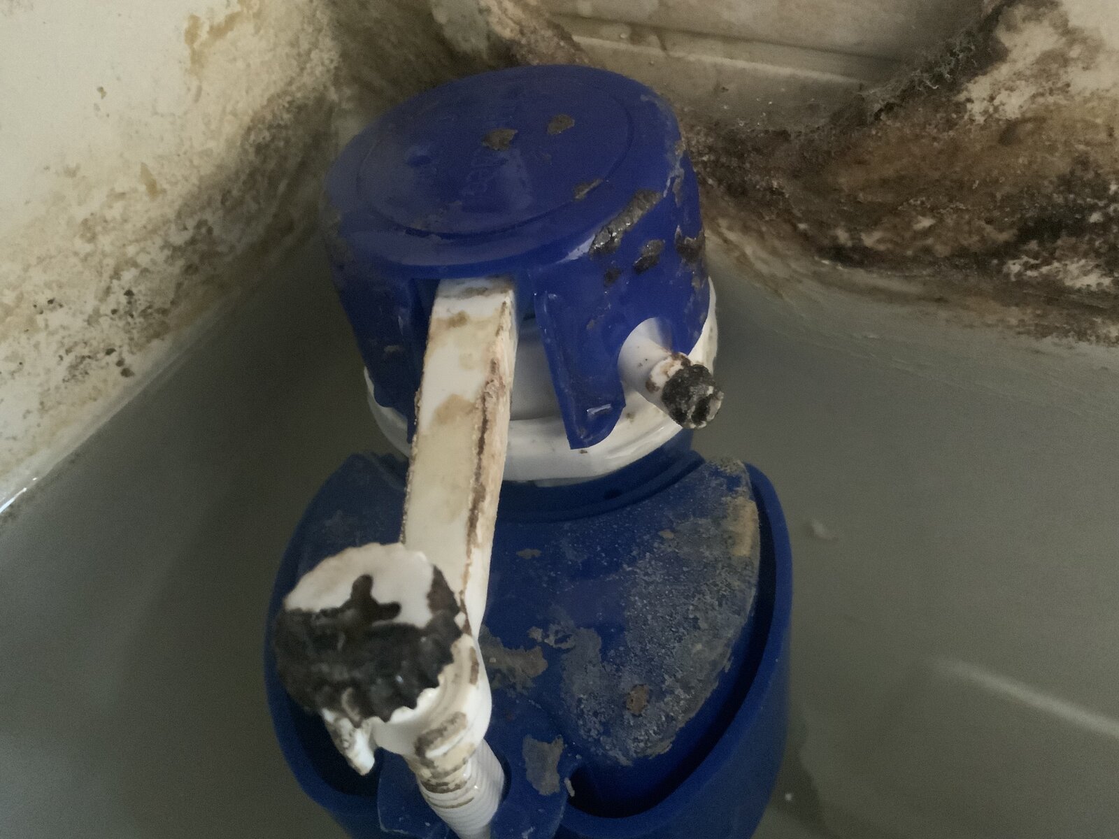

Ok, turn the water supply off, lift the arm up and turn 90 degrees. This should then make the top part come off, check and clean out the washer, you made need to replace the washer.
Or buy a new valve and fit this one, but it means pulling the toilet out:
Make sure you get the brass bottom.
