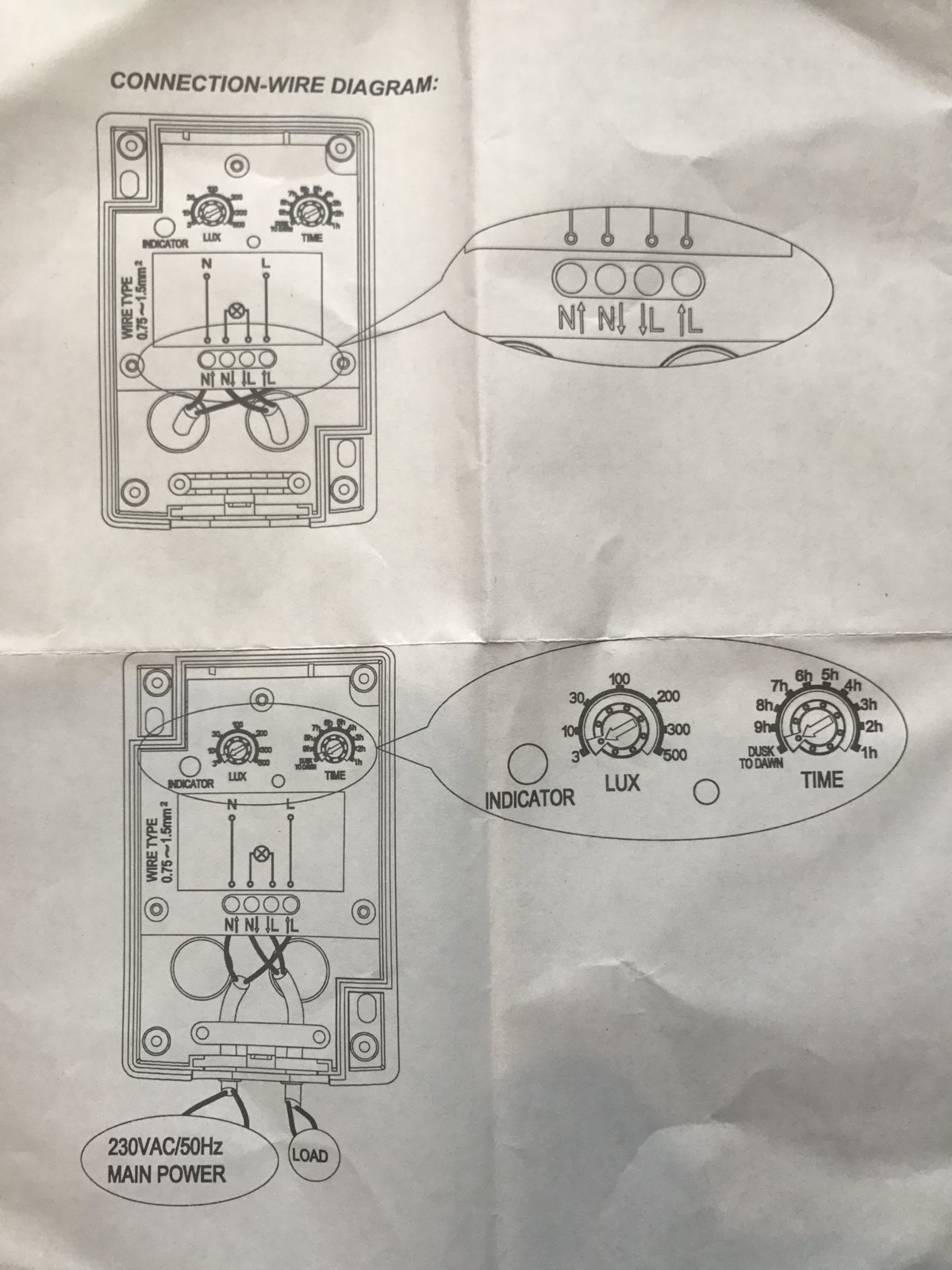

You should wire the incoming L & N to the rightmost and leftmost terminals, and the outgoing L to the 2nd from right.
Only you can tell which cores are used for which in your cable - nobody here can do that.

Can I just clarify that I'm right with the following per the diagram and available wires...
1 (N) Grey
2 (N)
3 (L) Black
4 (L) Brown

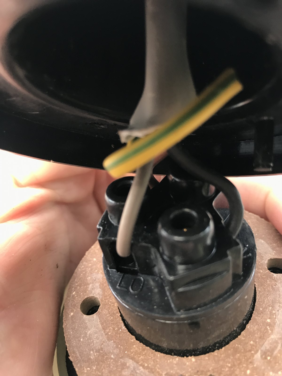

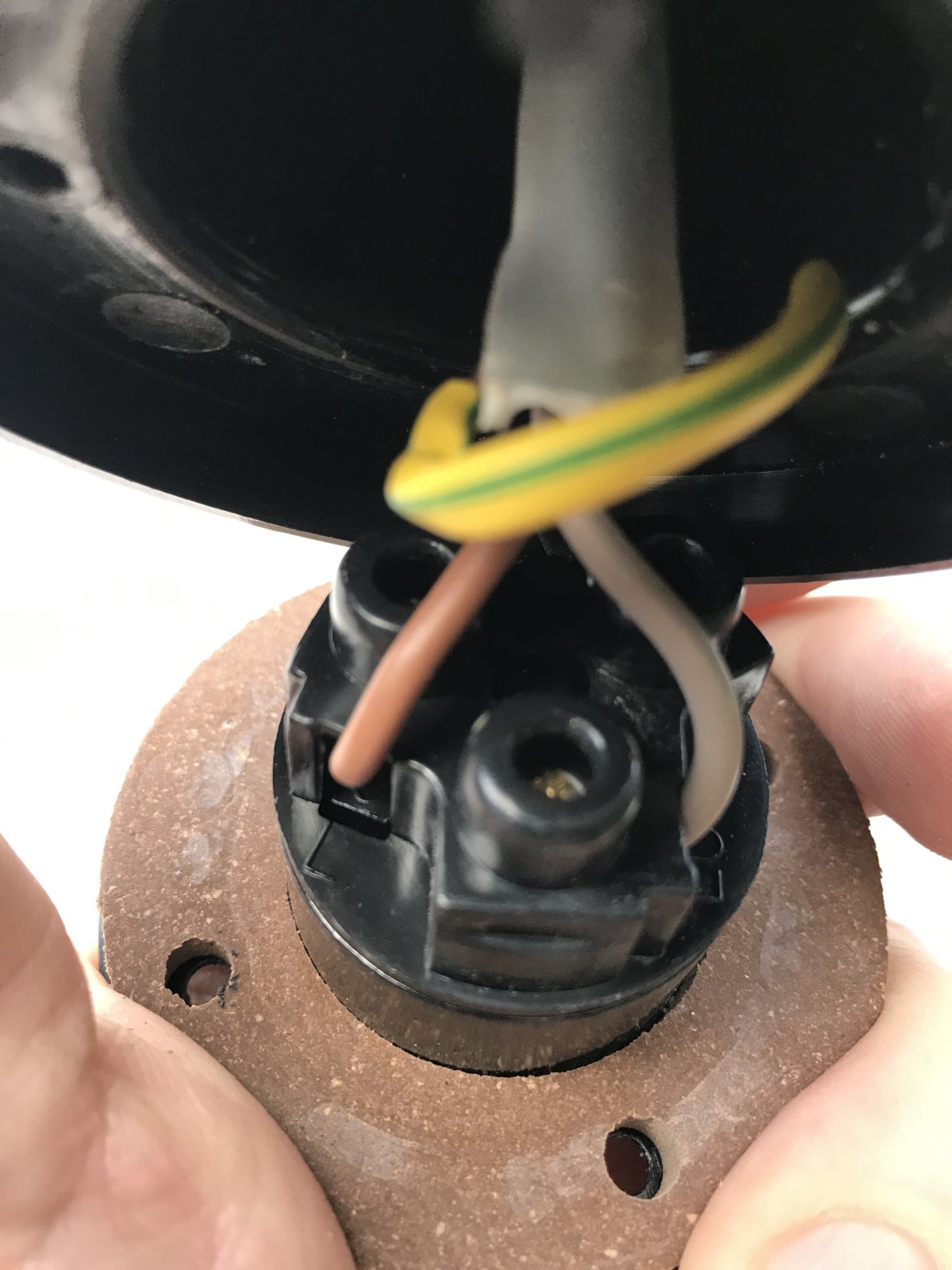

The old one fits a Nemo socket , the connections on it are marked
Li for live in
Lo for live out
N for neutral.
If you note what colours are on what and match it with what Ban all Sheds wrote, then you should be ok

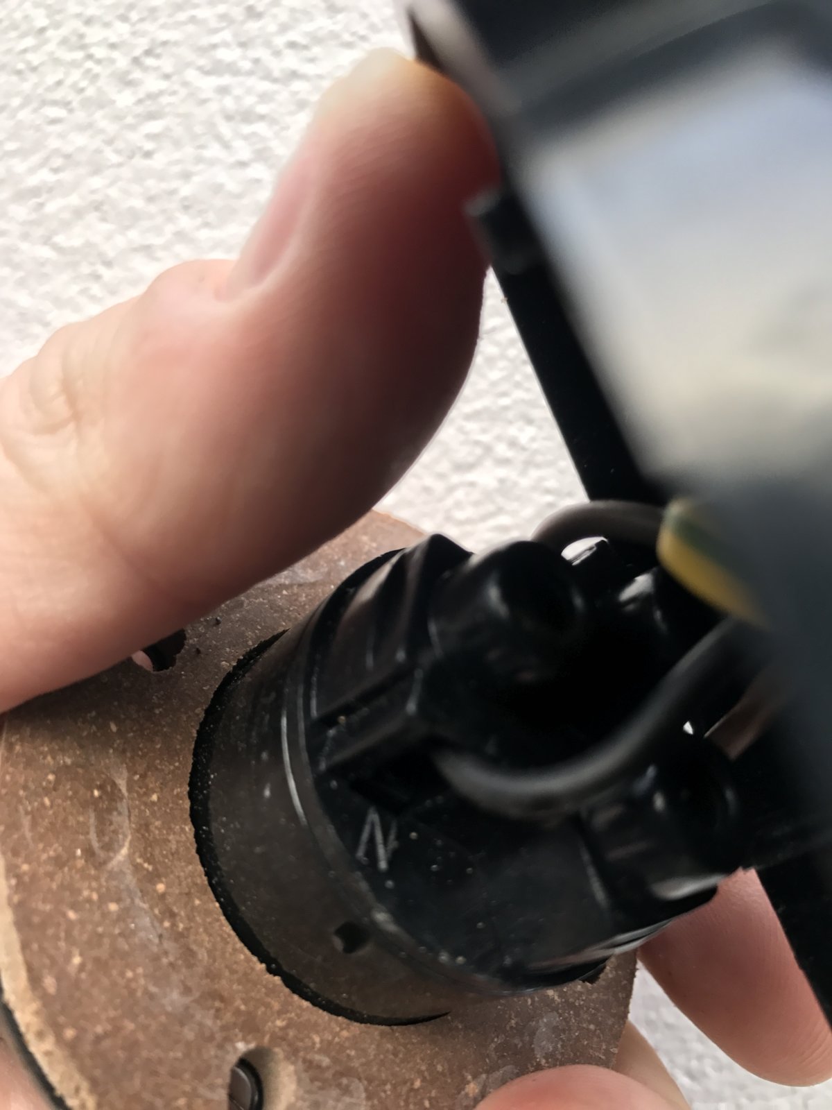

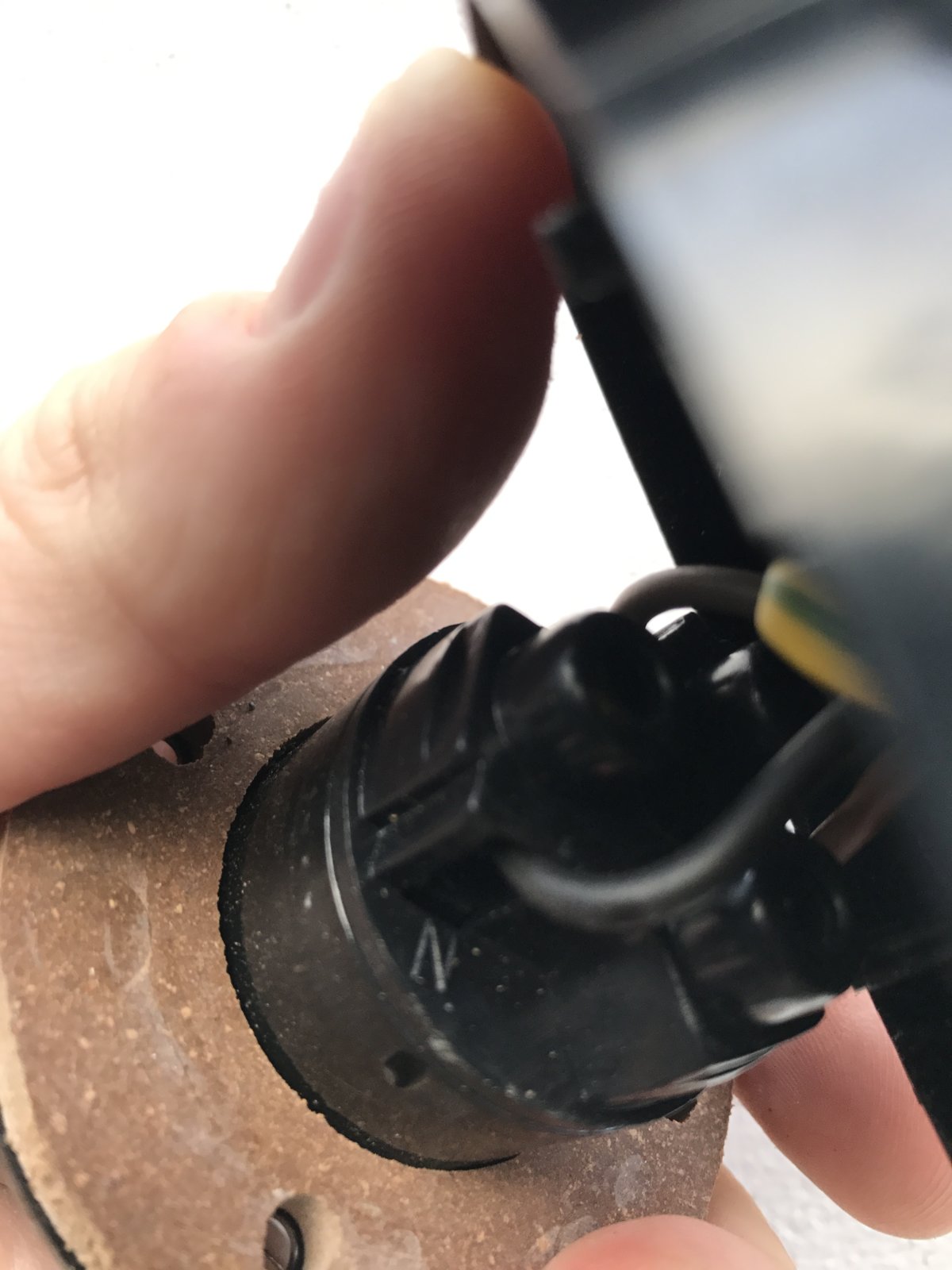

Okay I've just had another look at this and below you will see how the existing wires were connected and how I have connected them into the new unit.
As far as I can tell this is correct and have masked off the sensor to try and trigger the light but it didn't work :(
Any suggestions chaps?
Thanks.
I don't want to be mean, but -
why do you think there are four connections on the timer if it would work with only three?
Plus, you haven't even followed the diagram with the three wires that you do have.
I cannot follow the layout.
Where are the two ends of the Brown,Black,Grey cable?
It will work without using it to switch the N as well as L.
L and SL look OK.
I wonder which N terminal the black wire goes to?
We're only seeing one end - when it was in the old switch and now when it is in the new.
The other end must be in a light fitting/rose/JB somewhere where it gets L&N and returns SL.
As to why it's not working, possible reasons include:
  • Wired wrongly
  • Broken
  • White tape not simulating darkness
  • Light itself not working
  • No supply
  • Cable fault
As ever, going back to basics and positively identifying conductor function and continuity and the presence of power is the way to proceed.
What am I missing?
He has wired the timer with the suppy cable but has no cable going to the light.
