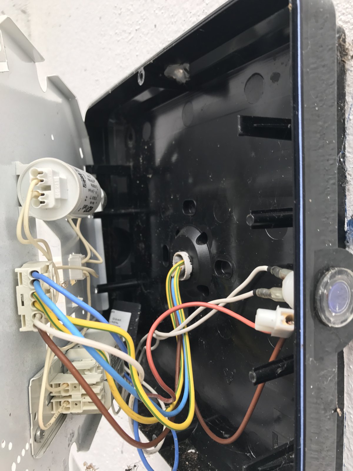

...I turned my attention to the light and what I thought was a wire blank turns out to be a photocell! Therefor the unit that I have replaced on the wall must not have anything to do with the light! (I have no idea what it does, can only assume that its an over ride for some other outside lights that are controlled via a timer.)
Back to my initial problem, how can 'I' make this light only stay on for a period of time?
did you try simply covering up the photocell and then see if the light came on and off with the Brown and Grey connected, if it did then keep your new timer and just take the Lights senser out of circuit

So I recall the 4 core has power but appears not related to the light and the other cable end is unlocated.
The light has power and works on the internal photocell.
I think the easiest way Is to refit the old sensor and leave be.
mount your new timer box near to the Light, but so the units light sensor is not affected by the light output, link between the two with a peice of 4 core flex
Then with the forums help do the connections within the light so as it runs via the new timer and the internal photocell is bypassed
Thanks Rocky, I did refit the old sensor so back to square one!
Where the light is located I'd rather not have wires running from it so feel I'll have to swap the full unit out for something else.

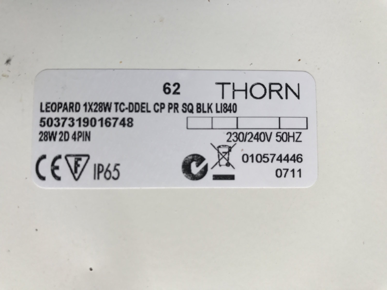

Do you happen to know where I could get a light with a built in timer sensor? Do they even exist?
Cheers!
Thanks mate but isn't that the same as what I already have?
It has a timer built in which will turn the lights OFF after a time so that they are not on all night. ( which is what I thought you were looking for )
Yes, it is what I want to do however. I originally thought that I could swap out an existing sensor with a timed version. That turned out to be not possible.
My understanding is that I would need to fit this to the existing light a distance away? (Is that the case) That wouldn't look good on the house.
So I wondered if there was an alternative light with this function built in?
