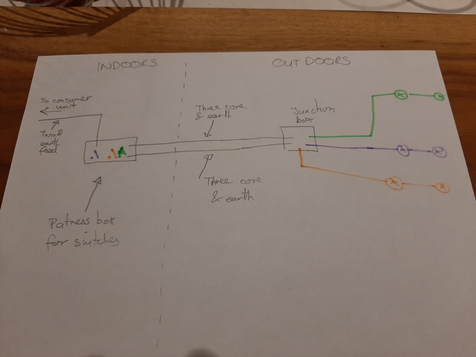

Can you use two three cores for three circuits?
My concern is eddy currents, if flow and return/ live and neutral do not follow exactly the same route. Low current garden lights will likely not produce much of a problem, none the less it is very bad practice to separate the two.
Basically - any current flowing through a conductor creates a magnetic field around it, which in the case of ac current is how a transformer operates. Any steel through which such a lone cable passes can have an eddy current induced into it, generating heat. Having both flow and return adjacent to each other, cancels this out completely. Basically, you never drill a hole in iron or steel and pass just the flow or return through it, always both through the same hole. You never run either flow or return by itself in a conduit, always both flow and return to avoid this issue.
This is all totally correct, however how many times recently have we seen questions on here relating to single and earth? I raised the interference issue [eddycurrents] not many years back and received criticism from many posters and not a single defence. As an AFILS installer and user I'm very aware of the issue and all of a sudden I see agreement with my thoughts.

How are these cable run?
Are they very close together or even in a conduit?
Also, what do you mean by 3 circuits, some applications are easily catered for with what you have?
More details please and pictures always help.

That changes things, you only have 1 circuit and 3 switchlines, providing the Neutral and E is in the same sheath as 1 or 2 switchlines, thats fine
Essentially up to 4 switchlines and 2 N and 2 E

Diagram attached. The stuff in pencil is what is currently there. The green, purple and orange felt tip describes what I'd like to add: ie three sets of lights, each set on its own switch inside (where the feed is) .
The two 3 core cables follow the same path, and were laid at the same time.
But I can't tell how close they are together as they run behind the interior wall before emerging in the garden.
Edit :They are not in a conduit while running through the wall because I can see where they emerge in the garden before going into an armoured bendable pipe.
Edit 2: see a couple of posts below for the image

Great. On one of the switch lines can I have two 'spurs', one for 240v fittings and one for 12v with a transformer? (all turned on and off at the same time by a single switch of course )
Edit:excuse any incorrect terminology, eg wrong use of the word spur

The fact that you guys have just found me a fourth line gives me an idea.Perhaps I can use that fourth one to put a light in my shed. In that case though, The switch for the shed light would be in the shed (ie downstream of the external junction box) rather than with the other switches indoors. Would that still be OK?
