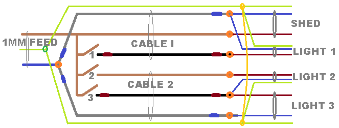

Can you use two three cores for three circuits?

As has been more recently discussed, I don't think that there is even a theoretically problem provided that each 3-core cable contains switched lives plus the neutral to the lights supplied by those S/Ls. In other words, as has been said, two 3-core cables could service 4 lights - with two S/Ls and the corresponding N in each cable.
If one wants to avoid the 'theoretical problem', the only thing one has to avoid is any cross-connection (at the downstream end) between the two neutrals.
Kind Regards, John

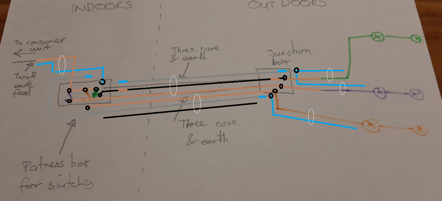

Yes, thank you all. Definitely happy now that I can have my three (four!) switched lives.
Does this help?
I've shown the earths linked, in reality all 6 wired should fit in a single connector block
Yes. That's great. Got it straight in my mind now.

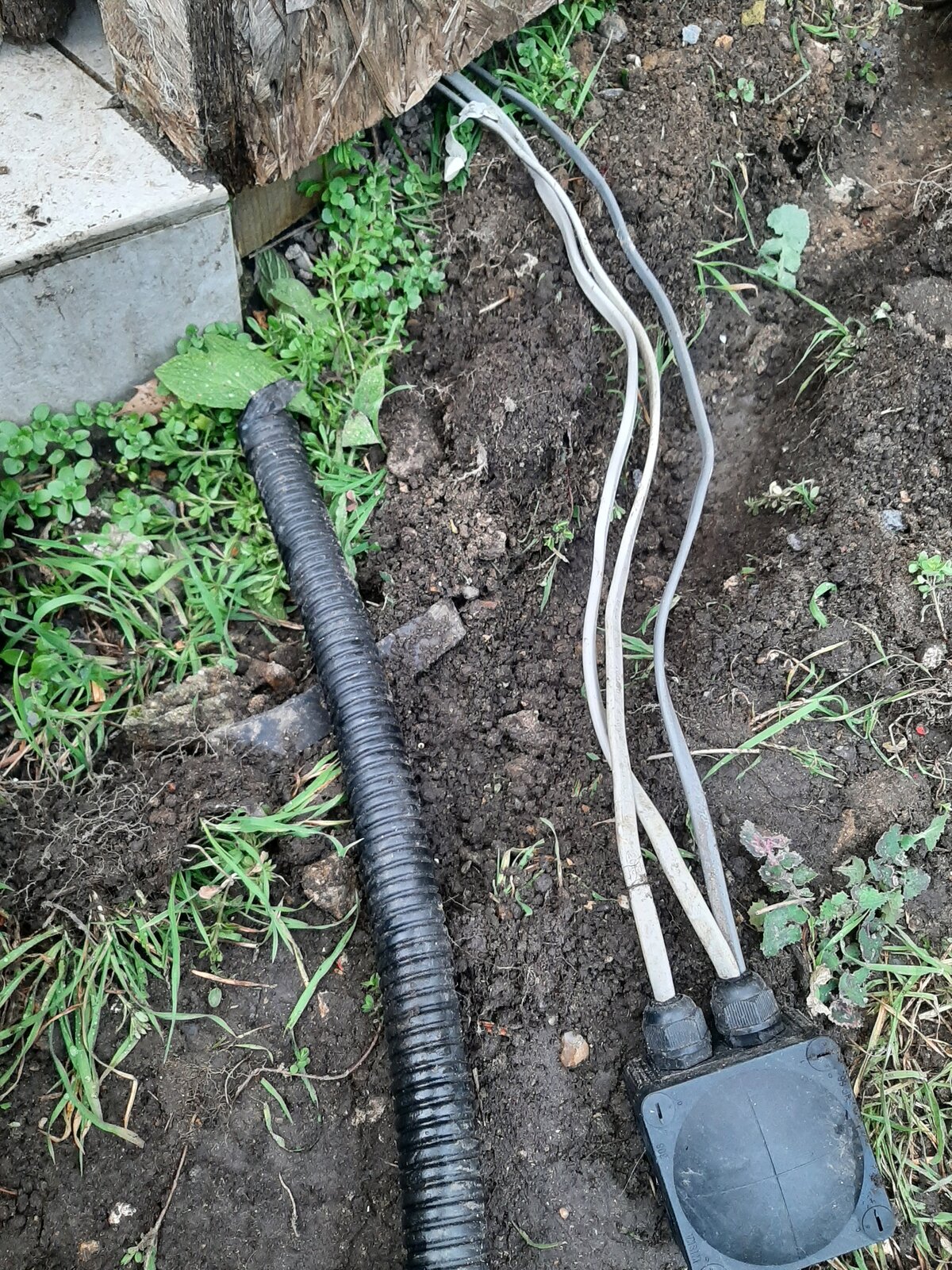

The one thing that I find strange though is how the original electrician left the grey PVC cable coming out of the wall into the garden. It emerges from the wall and then goes into a wiska box after about 50cm. He'd slipped some metal Flexicon conduit over it, but there arent any glands or anything actually connecting the conduit to the wiska box.
How should that first bit of grey pvc cable be protected before it gets to the wiska box?
Here's a photo. Landscaper must have taken the flexicon off today. Not sure why.
Edit : none of these cables are live. They are yet to be connected.
