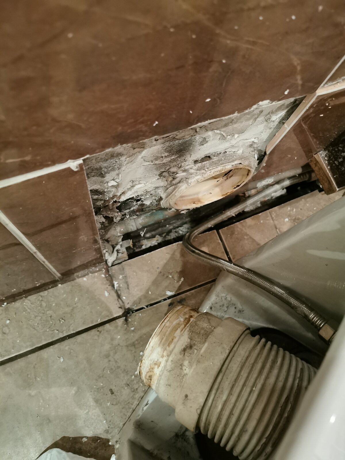

Thanks for the helpful replies again guys.. I've never done anything like this before so all comments appreciated.. OK so the waste pipe looks like the pic attached.(apologies in advance, tbf not as bad as I thought, definitely no smells, lol) .i think the toilet literally slotted into the hole in the wall.. The pan connector from toilet to wall.. Will that just slot in?

Can't tell what exactly what that is in the wall ,it's possibly a ring seal fitting. However , you have a flexible pan connector with multi finned rubber seals at the end that goes into the pipe / fitting at the wall You need a new one .The new one will be ( or should be) a tight fit into the pipe in the wall ,use washing up liquid to lubricate the rubber multi finned seals before inserting the pan connector into the pipe . Do NOT put any on the other end that fits onto the WC pans outlet .

The pipe on the wall , there is no room for movement really as it looks pretty well stuck firm.. The connector I guess will just slot inside the pipe in the wall and not around it?
Could you please link a pan connector I need as there are several ones. Would I need to apply any sealant to the end of the connector?
