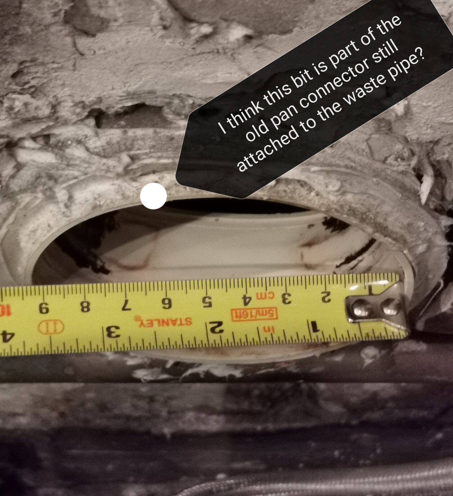

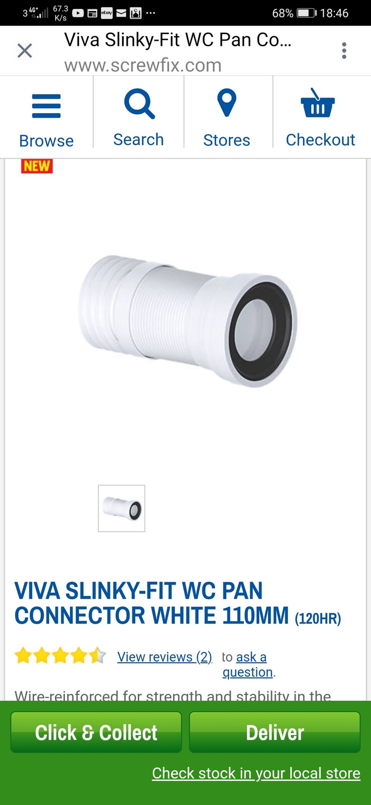

Yes I was hoping to replace the existing flush system that has 2 rods from the button to something newer that has the cable attached to the push button..
The pipe on the wall , there is no room for movement really as it looks pretty well stuck firm.. The connector I guess will just slot inside the pipe in the wall and not around it?

The one you linked to should do ,however ,measure the length of your existing one compressed ,and also when extended. And ensure the new one has the same adjustable lengths.
You should stick to a flush valve that is operated by the rods ,as you have now .
I think my measurement for the waste pipe in the wall didn't account for the end of the old pan connector still attached to the pipe as it only measured just over 90mm and the connector I've seen is 110
Yes ,the multi finned seal is still in the pipe. It all looks like a bit of a lash up at the wall. You really should see some of the pipe into the room. Maybe carefully chip away at the plaster ,to expose the pipe edge,just to see how far back it is set into the wall .
I've pulled off the little bit of the finned seal..the pipe edgeis pretty much flush with the wall..
Thanks for your help guys.. Managed to fix it in the end..
