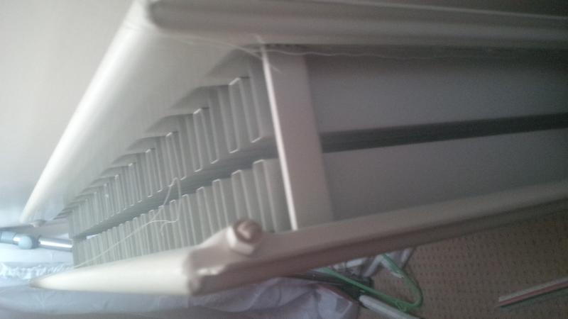

Can't get the this valve to turn wo. Rad key doesn't fit, flathead screwdriver doesn't work, is the valve at top of pic? Any ideas?
Assume you are trying to turn anti-clockwise to bleed?
if the bleed key won't fit (unusual) is there paint on the bleed point stopping the key fitting?
Can you get a pair of grips onto the nipple?
don't understand "too shallow"
Can you get a pair of grips onto the head?
Yes, and it's the small bit in the middle that turns.
Those ones are a PITA :evil: I`ve had success with a small file - remove the round flange that sticks up alongside the square vent plug - and try a key that has been flattened across the open end - there's too many rounded surfaces with those vents ;)
