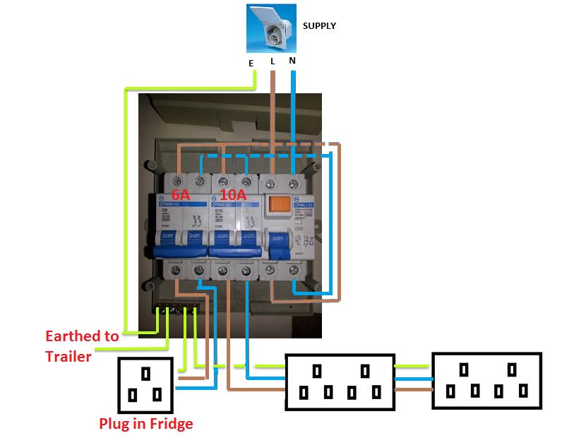

Hi,
I am looking to add 240v mains to my caravan. Currently it has no power. I looked at buying a kit but got such a good deal on a second hand unit on ebay i thought i'd wire up myself. Only thing is i have no instructions. It has a 25A RCD and 2 twin pole MCBS (10A and 6A). Please could someone advise if my diagram for wiring it up looks correct/point me in right direction.
Thank you
