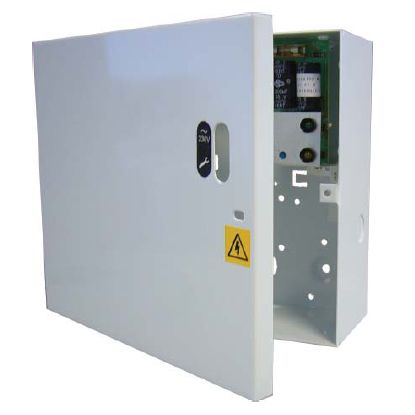

whats the Maglock being powered from in the first place ? If it’s an alarm psu with battery back up then it’s running at 13.8v dc anyway
It's just listed as a 12V PSU. Though we didn't buy it yet. Why would it be 13.8 not 12?
Ah I see. I think this is a mains -> DC converter PSU. There is an optional battery but I assume that's just a lithium battery.
It's not an alarm system or supply, outside normal hours there will be a physical lock
Mag locks are typically powered from an alarm system style PSU with a lead acid battery backup. It's common to use alarm cable and cat5 from my experience (I prefer alarm as cat5 isn't really ideal in screw terminals). What sort of control unit is being installed?
It won’t be a lithium battery it will be something like above ....don’t forget with a maglock ....no power then the gate will be unlocked ...
