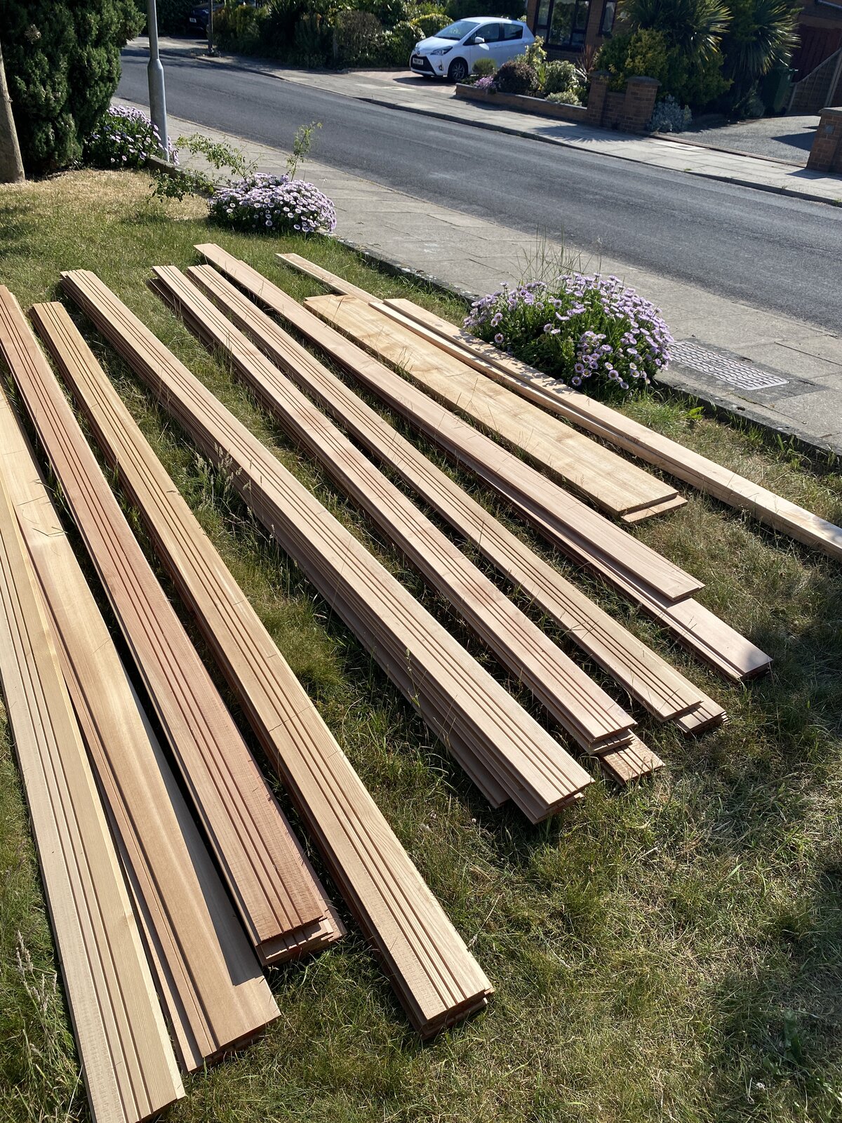

Got it all delivered last week, it’s apparently “air dried/green” but doesn’t appear to be particularly wet apart from one board which feels a bit on the heavy side.
Planning on keeping them in the garage to acclimatise for about 3 weeks before treating all the end grains and fitting it. Called osmo tech support and they definitely recommend having it fitted and exposed for several weeks before going on with the UV oil (front face only obvs).
The bloke seemed pretty knowledgeable to be fair and talked through the whole thing in a lot of detail.
Reckon the 3 week acclimatisation thing is ok/overkill/not enough? The only reason I’m doing it is to avoid any change in dimension after I’ve fitted it which would look noticeable. It’s mentioned in a few places like the Silva cedar install guides to acclimatise it, wasn’t really aware it was necessary tho.

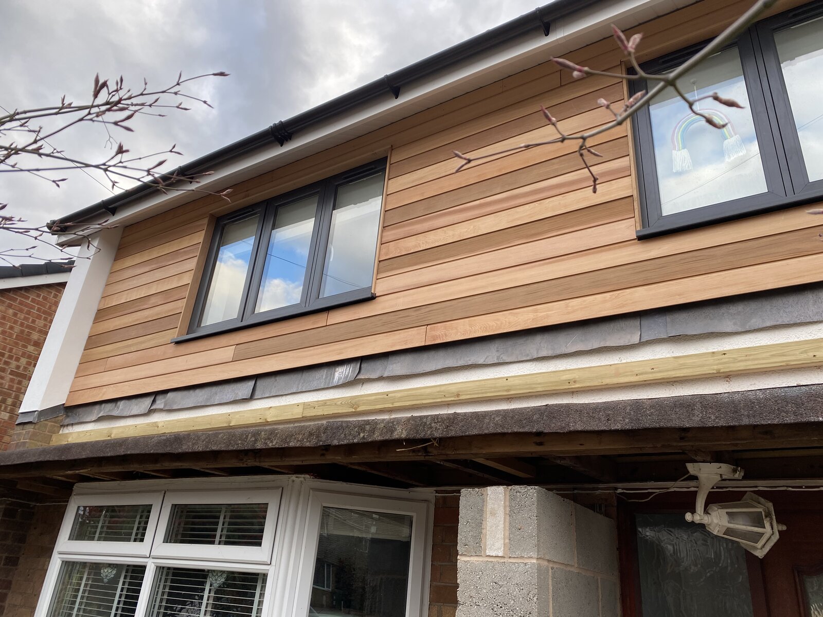

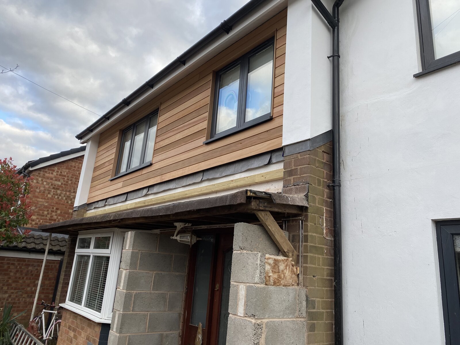

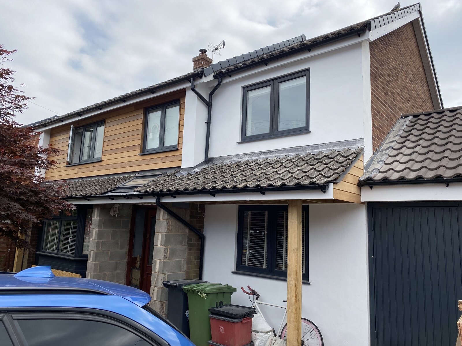

Put it up today, happy with the look. Next challenge is try and get the UV protection right

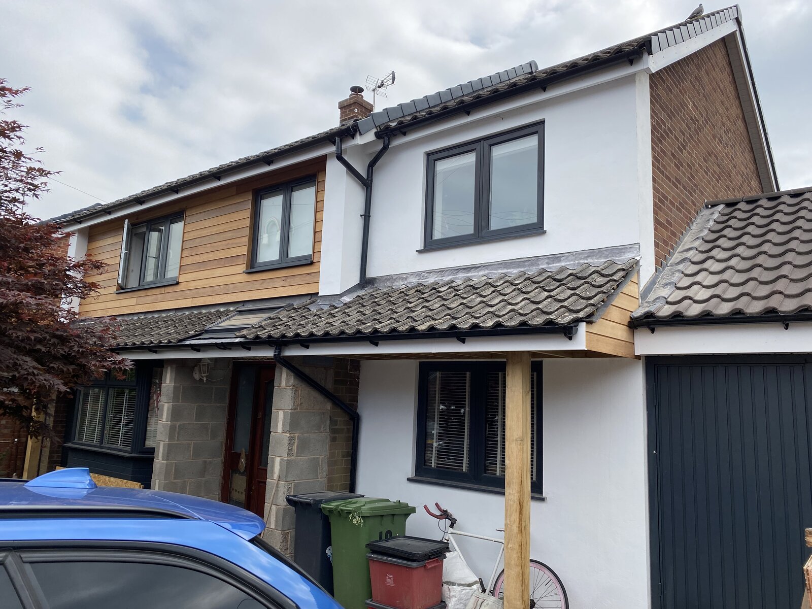

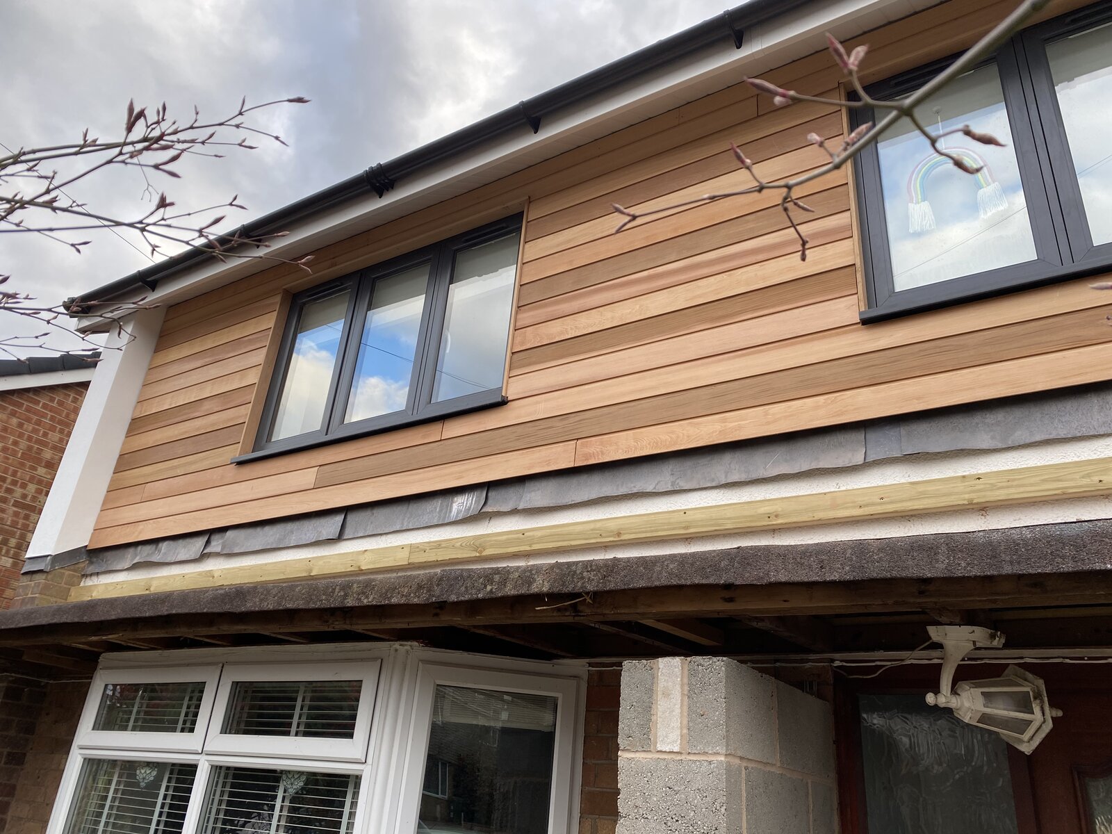

Gave mine 2 coats of osmo clear this week after leaving it untreated on the wall for a couple of months. Had some spare so found a use for it on the lean to gables. Bit of a faff working off the new roof to apply it but Happy with the look (y)

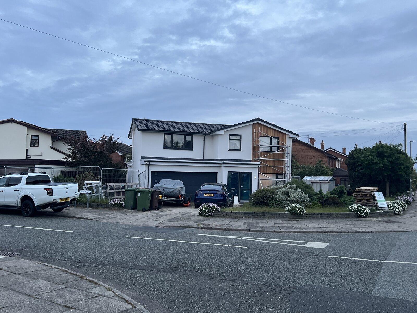

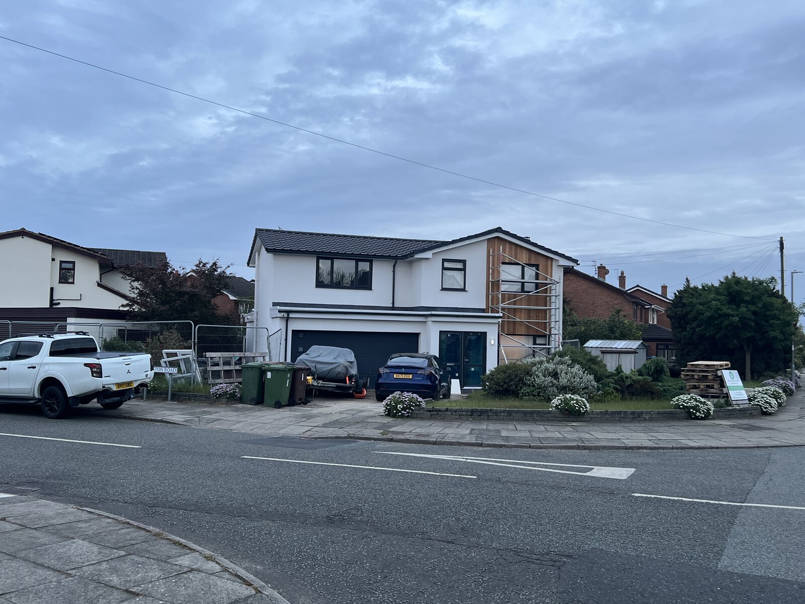

Well it sat in the garden for a year, but I finally got mine put up on the house.
Probably saved myself a grand by ordering it waaaaaayyyyy to early given the price of timber now :D
