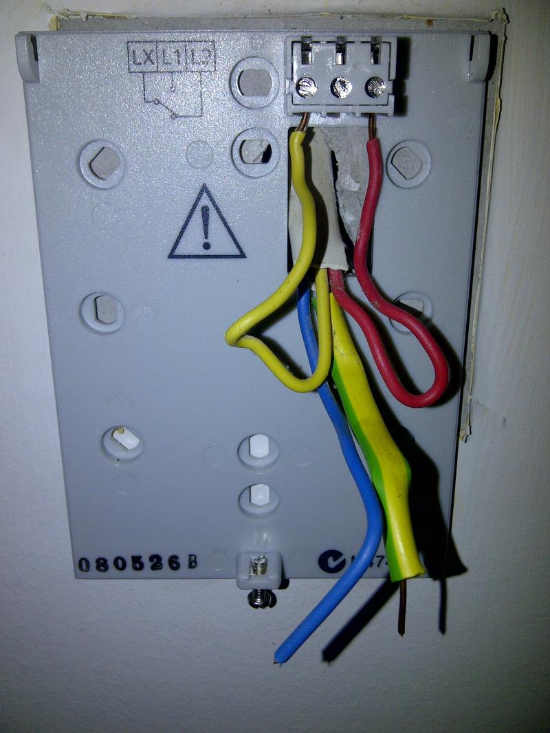

Also - will be installing this much better looking thermostat whilst sorting this mess out.

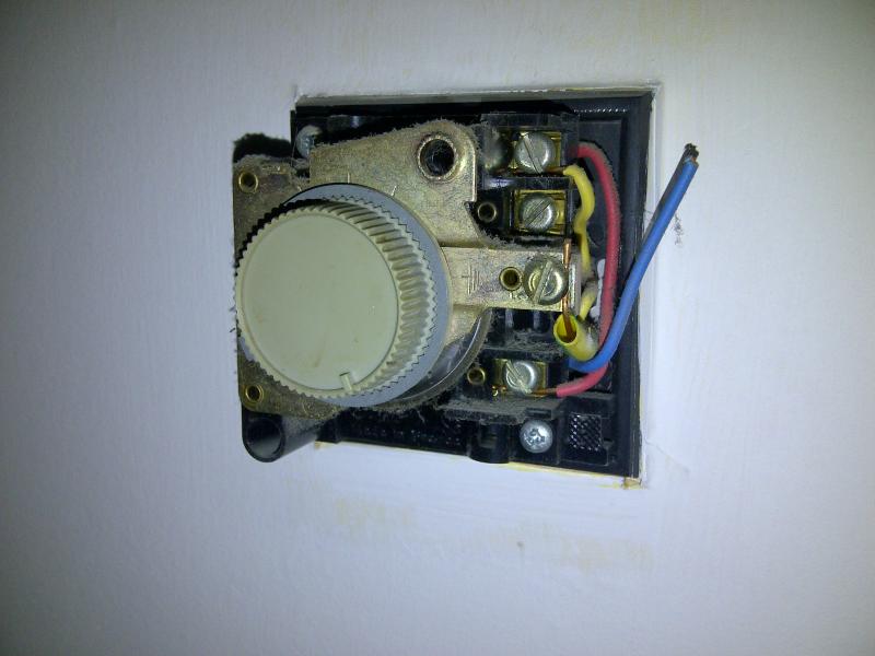

I've pulled off the thermostat cover of the old one, and have posted up a pic below:
As you can see, the yellow and red wires are the only ones wired in, along with the yellow/green earth.
This is how I think I should use the same wires in the new backplate of the new Siemens thermostat - is this correct?
Key questions are:
1 - is the wiring correct?
2 - should I just leave the yellow/green earth wire unconnected along with the blue one?
Thanks very much for any replies....
