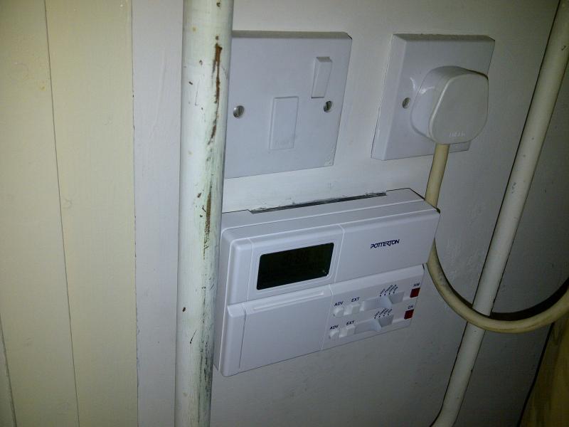

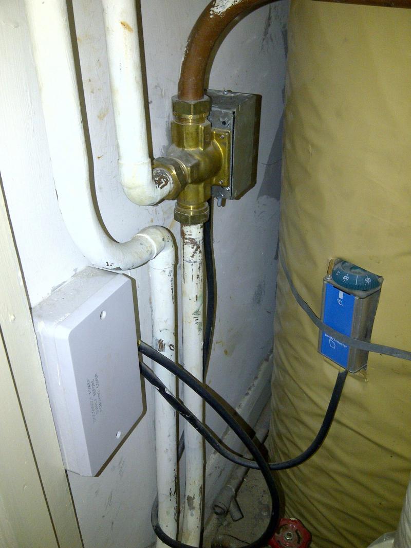

There is some sort of intermediary box between the EP2002 and the valve. Have uploaded some pics here....
Close up view of EP2002 (brand new)

Longshot view of everything in the airing cupboard

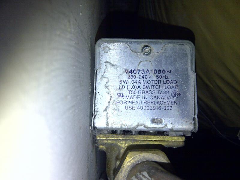

Close up view of text on the motor valve
Diverter or midway diverter, I assume yours is V4073A mid way?
I know less than you do! I'm assuming from the last photo of the text on the motorised bit of the valve, that it is in the "A" version - midway diverter....

Am ready to tap with the hammer, and twist with some pliers once the old head unit is off, which will hopefully free up anything that is stuck. If not, looks like a plumbers going to have to come in and drain the system down to replace the brass valve element.... Gggrrrrrrr.....
