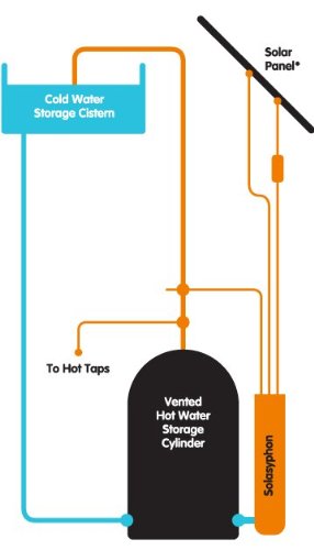

Are you talking about the Wilis system? this
fit at the side of the main cistern, can also be used with solar
it seems common in Ulster but never really caught on in mainland UK. The idea is it heats from top down so minutes after switch on you get piping hot water, and the longer it is left to run the more of the tank that is heated.
