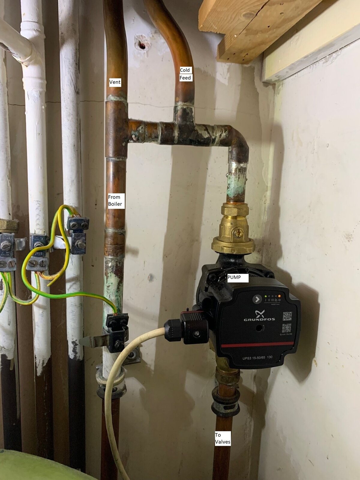

Can you post the pump make/model/mode/setting, also is your system something like this, where, from the boiler (flow) you have, Vent, Cold feed, Pump, post a photo of your set up.
Is that a pic of your system? I thought you had a combined feed and vent.
3 things I'm not keen on
1. Pumping downwards is non-preferred.
2. The cold feed pipe should enter the circuit from underneath via a U-bend.
3. I wouldn't have open vent across the top of a tee, as it gives a head start for flow up the open vent, increasing the risk of overpumping. Better to come off a horizontal section.

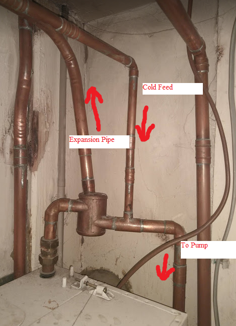

Interesting my feed system is more or less the same (except for air separator) and no such issues
I wasn't trying to say it would cause immediate problems, just that if starting from scratch I wouldn't do it that way, unless unavoidable.
Does your F/E tank get warm? The horizontal run might help reduce convection.
Can't see your pump, is it downwards?
You may also have an 'H' pipe setup like the one in @Johntheo5 's pic or have an air separator, as per @Dereekoo 's setup, they tend to be more typical in an OV
