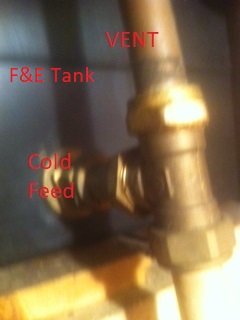

Central Heating F @ E tank feed pipe gets too hot

My 30L capacity F&E cistern is 300mm high so 10.0mm/litre, my system contents are around 90L so would expect the expanded vol to be ~ 1.5L so cistern level should only rise by 15mm, but assuming a 22mm cold feed of ~ 0.28L/M I presume the feed pipe should be very hot right up to the F&E cistern?, is this correct?
My figures are slightly different, but not enough to argue about!
And assuming my cistern contains ~ 15L normally, then the expanded vol of 1.5L will only raise the cistern temperature by 4/5C?.
Yes, so wouldn't expect too much of a problem. Though that's each time the system heats up, and if the F/E tank is well insulated there could be a cumulative effect.
I never seem to have noticed this on the odd time that I've felt the cold feed.
Some of the expansion occurs while the water is warming, reducing the tendency for the whole pipe to get hot.
Is this on your combined feed/vent system? Presumably that is all 22mm, and off the top of the pipe, so convection doesn't seem to be a problem there. But many boiler manufacturers (where they say anything) show cold feed via a U-bend.
Also how does the convection occur where the feed is teed in off the top of the flow pipe, does HW flow up one side of the feed pipe and cold/cooler water flow down the "other" side of the same pipe?.
Yes, and the scope for it clearly increases with pipe diameter.

Do you mean the open vent pipe? The reason is because whatever the expansion volume, most of it will go up the cold feed pipe into the F/E tank, as the area of the tank is much greater than the vent pipe.
I have heard of a number of systems like the one above, mounted high up in the hot press where there was pump over especially when stopping/starting the circ pump leading eventually to air ingress, a few changed exactly to my system, no more problems, I don't know why, the dP between the vent & cold feed 125mm apart on a 22mm pipe at a flow of say 15LPM is only ~ 10mm or so.
I have the circ pump pumping into the boiler at a 3.6M head, (= actually a PP head of 4.6M), a very old rad in the upstairs (converted) attic bedroom runs with a very very slight negative head but never a problem, if you stop the circ pump, water will immediately flow from the vent screw.

The pipe that's drippng is the overflow pipe, a bit strange though if its only dripping during boiler operation, can you look into the F&E cistern when the boiler is running for awhile and check the level.
That UPS3 setting of CC1 is excellent IMO, its a max of 4.2M and probably running at ~ 3.6/3.8M at a flowrate of 16 to 18LPM.
