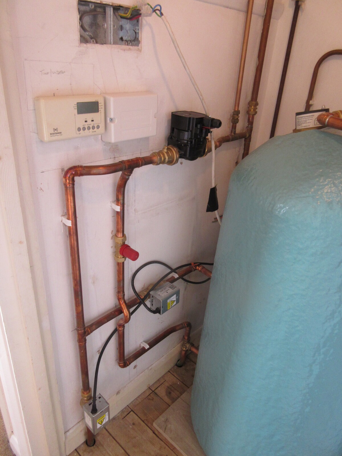

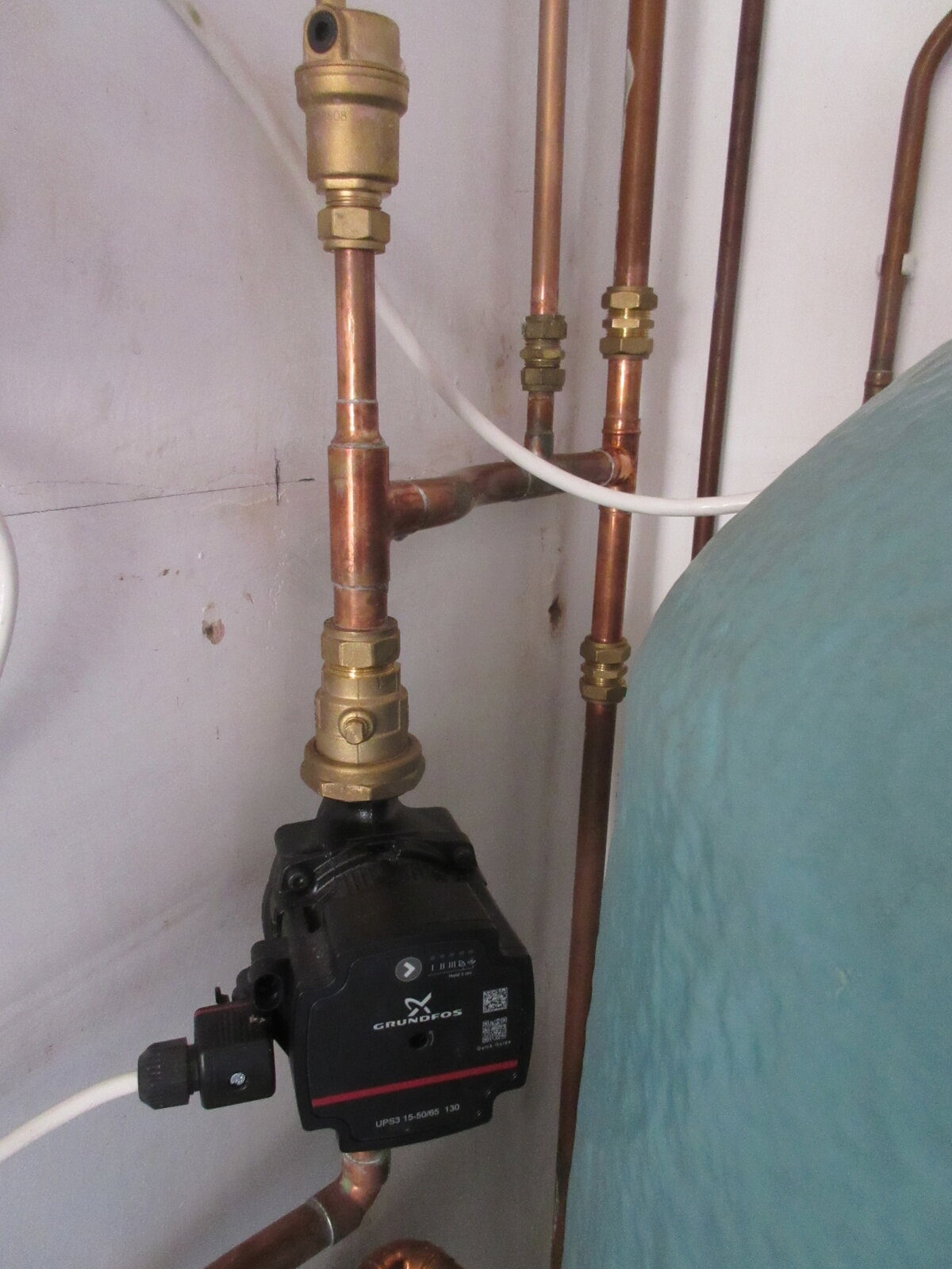

Is that a pic of your system? I thought you had a combined feed and vent.
3 things I'm not keen on
1. Pumping downwards is non-preferred.
2. The cold feed pipe should enter the circuit from underneath via a U-bend.
3. I wouldn't have open vent across the top of a tee, as it gives a head start for flow up the open vent, increasing the risk of overpumping. Better to come off a horizontal section.

Does your F/E tank get warm? The horizontal run might help reduce convection.
Can't see your pump, is it downwards?
It does get a certain amount of warmth but not to any extent to give visible issues, pump pumps downward as its situated in bathroom airing cupboard. The F/E pipe is about 1.5 m long so you may be right

This is the current "H" layout on my airing cupboard.
A bit more background.....
I recently had a new Vaillant ecoplus boiler fitted. I cleaned out the system properly had all the radiators (18) off and cleaned them thoroughly. Replaced all the airing cupboard plumbing and originally had the pump horizontal and obviously no air vent!
I was forced by legislation to get a "recommended" and "gas safe" person to fit the boiler or my insurance would be invalid. This person had trouble getting the water round the system and removing trapped air so he altered my pipework to make the pump vertical and stick in this air vent (on the wrong side of the pump).
True the water gets round ok and all the rads work fine. but the fact remains that hot water is still migrating up the 15mm pipe and making the header tank 36 degrees. Loads of tank condensation and annoying drips out the pipe.
I just find it a puzzle that the 15mm feed pipe gets very hot up to the ceiling but the overflow pipe only gets hot up about 12 inches.
