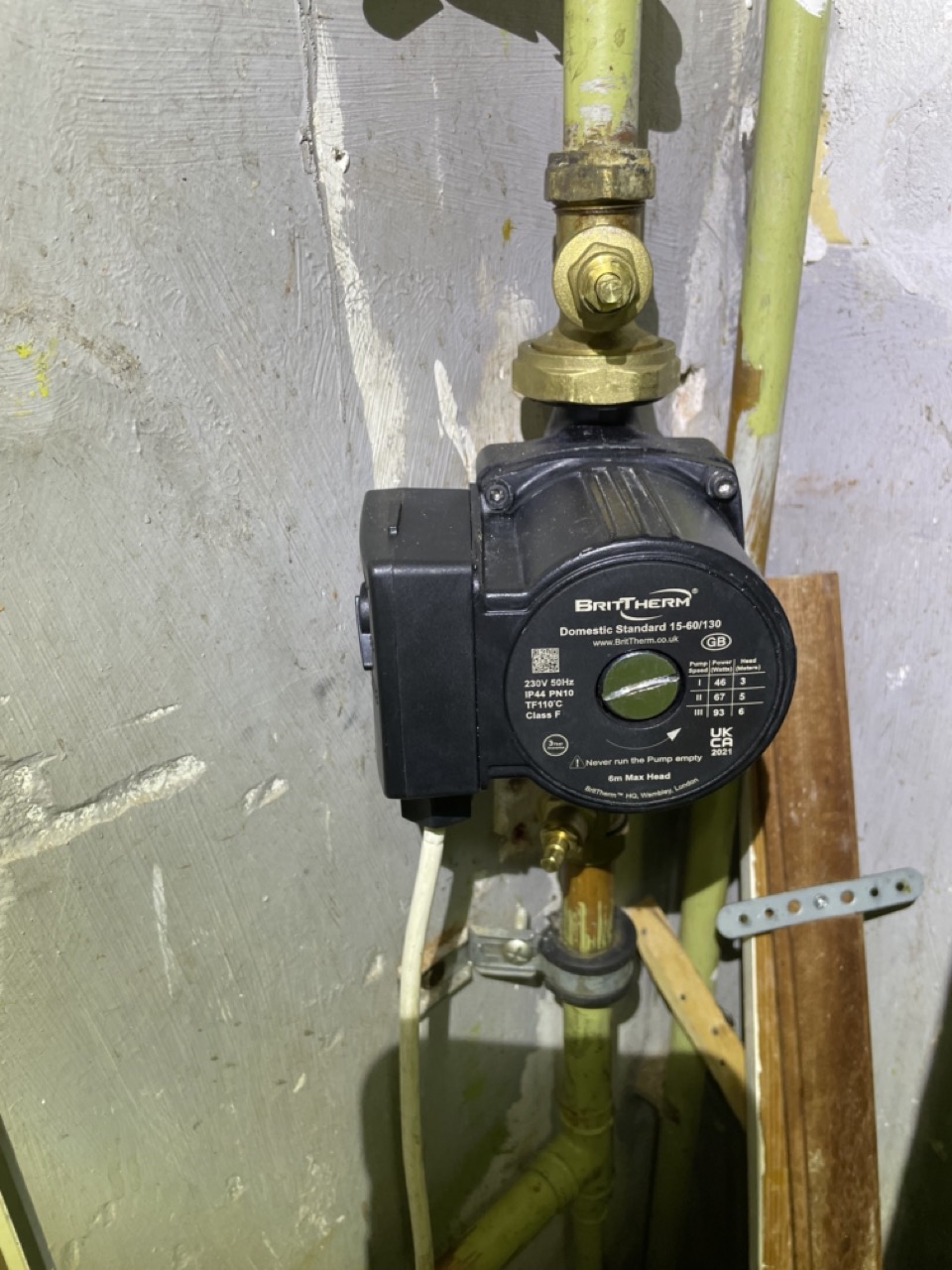

A few other easy items to check out, check that the arrow on the side of the pump body is pointing towards those 2 port valves and check that the pump is set to speed 3.
The pump is set on speed 3, but I can't see an arrow on the side of the pump body, perhaps because it's on the side I am unable to view
If the 2 port valves are on the pipe above the pump then more than likely pump pumping upwards, correctly.
Hmm. They're actually on a pipe that tees off the down pipe. This was one of my concerns with the plumber fitting it, as it took him a couple of tries to get it 'fitted correctly', and he didn't seem totally confident with this particular task. Also, I don't think I mentioned earlier, but the new pump has a variably noisy hum, and occasional clunking from the area where the pump is installed.
But if it was installed incorrectly wouldn't it be the case I'd get no output at all?
Beg, borrow or steal a mirror so you can extablish 100% which way that pump is pumping, presuming that the pump is on the boiler flow then IMO wrong IF pumping upwards, you will have to establish that as it may be pumping correctly downwards and the plumber just turned the pump head through 180 deg.
