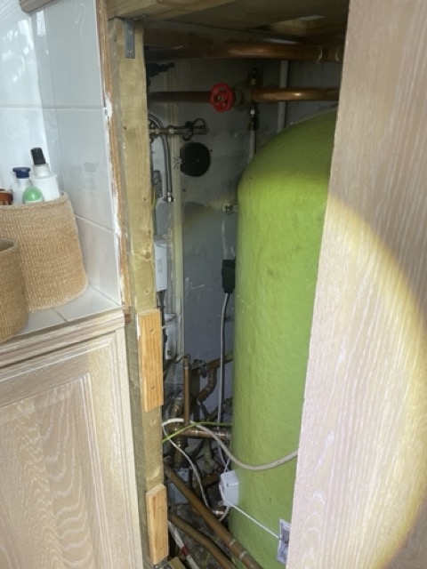

Seems obvious it's circulation:
Boiler stat is ok, boiler doesn't kettle and the pipes at the pump are too hot to hold so boiler is neither too hot or not hot enough.
If the plumber used the pump valves to change the pump and they operated alright it's not the gate stuck in a semi closed position.
Take a picture of the pipework before the pump, the other side of where the valves are and the arrangement, could be blocked at the cf/vent connection.
Do you know if the system is piped in plastic?

I can see two valves like the 2 port one you posted, near the HW cylinder and pump.
I think thats called an 's' type system. I have that setup and I used to have a Potterton Profile 60e boiler. With that setup (as opposed to a 'Y' type system with a three way valve) you must have an automatic bypass valve. If that is set incorrectly or is faulty, heated water from the boiler will go back to the boiler, get too hot resulting in the boiler shutting down with the pump running on until the water cools down and the boiler fires up again. You need to locate your ABV and see whether it is letting heated water back to the boiler from cold. Mine only opens when the heating or hot water is satisfied and allows the system to keep pumping for around 5 minutes with the boiler not running to cool down before shutting down.
As follows, although you can't see the pump itself here - that you can view in an earlier upload I made
Apparently not, according to my plumber. I asked him an hour ago, and he said 'no'. I asked him a 2nd time just to be sure. He also checked that the pump installed by the Powerflush plumber was installed correctly and working, and it was. Also confirmed the boiler thermostat working ok.
His suggestion is to leave the Sentinel x400 in for another 2 weeks and see if there's any improvement. If not, floorboards up and pipe replacement.
Maybe you have a manual bypass valve? I know with a three port valve you don't need a bypass but when I had my system converted to a sealed one with unvented hot water, they removed the three port and fitted two 2 port valves and a automatic bypass. When your heating or hot water reaches its set point, does the boiler just switch off and the pump stop running? I'm not a heating engineer but that doesn't seem right to me.
Do you have a sealed system - looks like a fill hose hanging there in that picture?
Yes and no - boiler switches off, but pump is constantly running
The hose is loose and not part of the system. I haven't yet established if I'm sealed or not.
If a sealed system, you will have a red expansion vessel somewhere, if so, you could have a semi sealed system where the feed & expansion tank (small tank) is retained with a non return valve in the cold feed and the addition of the expansion vessel.
