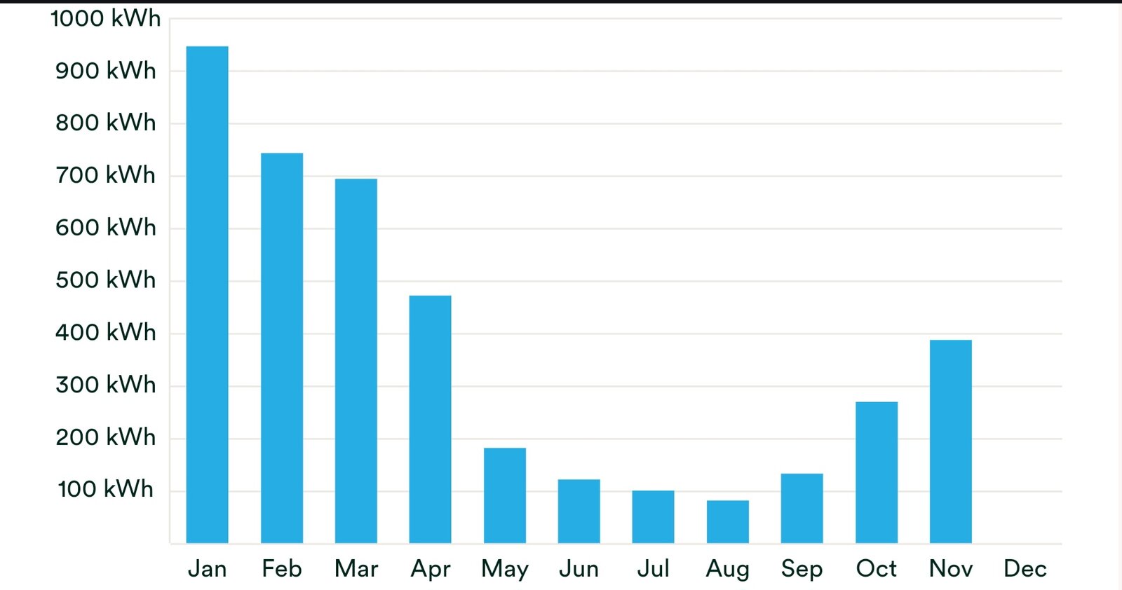

We didn't start heating the house until late October, that was the first time that the temperature dipped below 18C (apart from the perfectly insulated party walls, the rear wall is south facing and gets an appreciable amount of solar gain).
Here is our gas usage, according to OVO (and I'm excluding 100kWh/month as the average standing amount of gas used for water heating and cooking - probably an underestimate)...

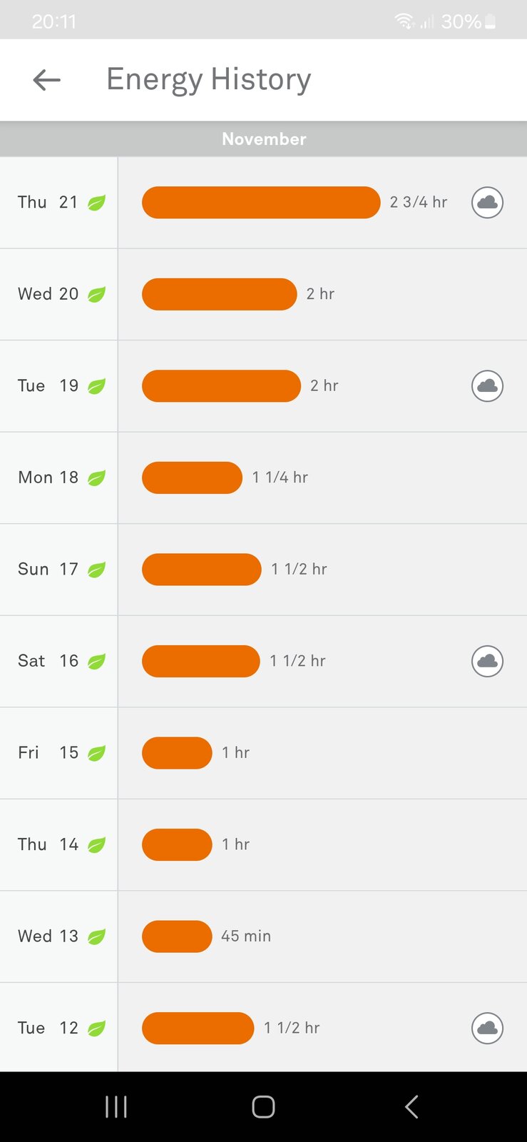

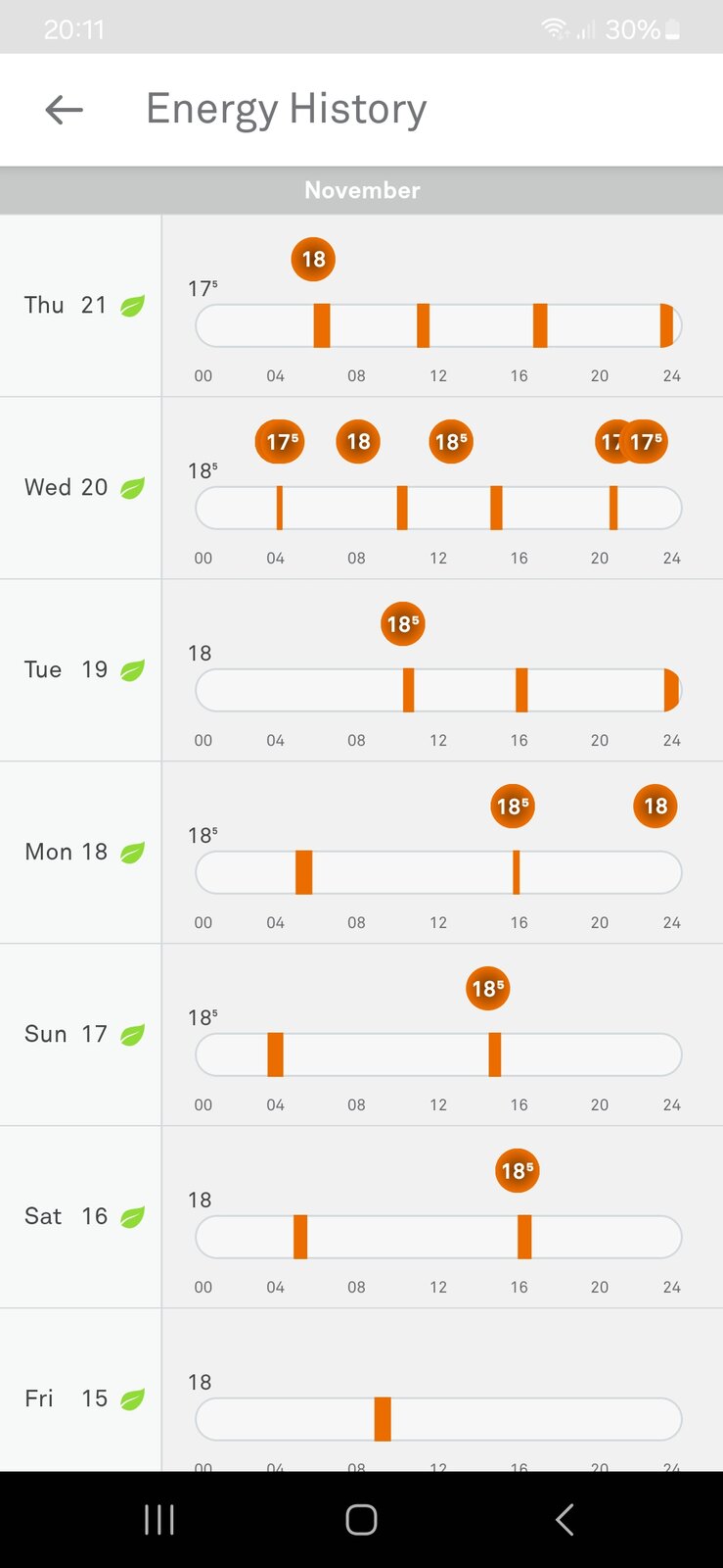

The Nest thermostat doesn't give the best information, but it does give a record of the amount of time it is calling for heat; here is last week's "Energy History"...
Even this isn't the full picture.
Nest may be calling for heat, but it doesn't mean the boiler is constantly firing; if the boiler return temperature was above the boiler thermostat setting, the pump would continue to run without the boiler firing.

Yes, that's essentially the 'qualification' I presented, and more straightforward with a simple on/off non-condensing boiler. Even if your heating is 'on' for 12 hours per day, the stat will be calling for heat for a lot less than 12h and, as you say, even when it is calling for heat, the boiler will not always be firing - which therefore may happen for only a small proportion of those 12 hours.
However,what is interesting is that 'averages are averages'. If one assumes that your heating system is 'on' for 12 hours per day, 6months of the year (probably not unreasonable assumptions), then your figures suggest that just one 1.5 kW radiator fed by a boiler that was running (and firing) continuously (no thermostatic control) should deliver as much total heat to your house as you present system is delivering - albeit not necessarily in 'the right places at the right times'!
