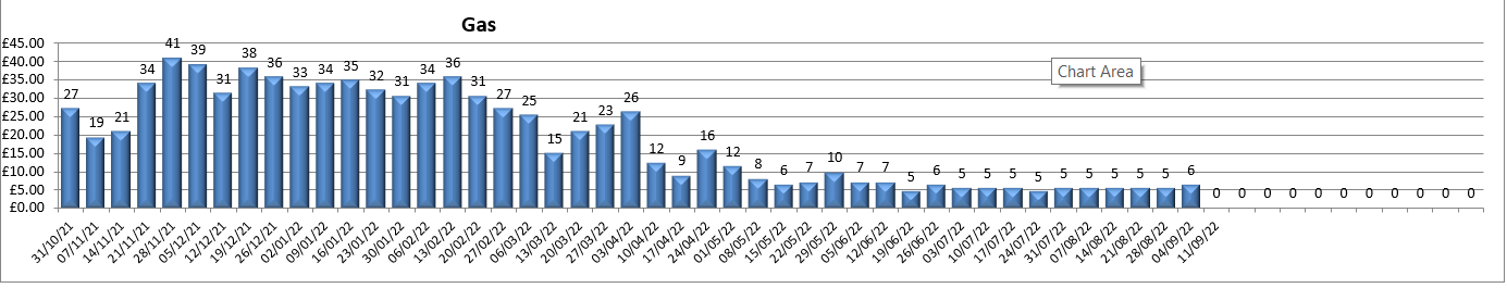

One interesting thing I discovered a while back. My hot water was always on for an hour in the mornings. I decided to drop it by 15 minutes to see what happened? In theory, not much should happen - the cylinder is high quality with V low standing loss - but in fact there was a definite drop in gas usage. Initially I thought I'd reduce it by another 15 minutes, but in the end I thought sod it, I'll reduce it to the minimum - 15 minutes - and put it back up if anybody complains about the hot water. Well, no complaints and the gas usage dropped again. That was about four months ago and gas usage went from an average of £1.15 per day to 60p per day. That is checked by energy monitor and there is nothing else in the house using gas, so is pretty accurate. That's two hundred quid a year saved. There are three adults in the house.

I think that will be top-up. It's very inefficient to heat a hundredweight of boiler, pipes and water for five minutes every time you run a tap ( combis are worse) and then let it go cold. Modern cylinders are usually big enough that they only need to be heated once or twice a day, with one sustained firing of the boiler. In this house, Summer gas usage is HW only. My last gas bill was less than 50p a day. Pipes are short and well-lagged.
As JD says, the only possibility is the boiler firing occasionally to top the temperature up. Cylinders always have some standing heat loss - the loss for good quality cylinders is stated in the specification. Mine is a good one and the standing loss is low, but there is always some loss. The pipework also dives under the floor and the floor is always warm - the cat loves it. The boiler is therefore firing occasionally to top up the loss - what is surprising is the amount of gas used in an hour to do that. As I said, I wasn't really expecting a measurable difference but it definitely is.
Dont forget the cold water entering your cylinder will be far warmer in the summer than it is in the winter so more gas required in winter to heat it which will eat into the savings you think you are achieving
