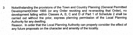

Found this on the original planning permission for the development - no mention of Article 4, but can someone please translate into plain English for me - does this mean absolutely nothing can be done without planning? I think decking falls into Classes A and E from what my limited powers of research can determine?

This IS an Article 4 direction, which you will often find on modern, high-density developments so that LPAs can control further development.
As you say, decking comes under class A, so regardless of the extent or height of the decking, it needs planning permission.
Correction: NOT an A4 direction - just a condition on the original planning permission for the estate, but has a similar effect.
Oh yes that's not good, sounds like you are on the wrong side of that restriction. The question is does the planner know about that? They seem to be focusing on the height rather than the restriction. Same goes for the neighbour, maybe they don't know. You can try to ignore that fact and fight it based on it being pd and hope they don't notice.

Haven't permitted development rights been removed so PD rules are not relevant :?::!: You will need to make an application for permission but there will be no application fee.
possibly but not clear this is understood by council
You might be correct in that the planning officer is unaware of the condition. However, if you make a planning application, the officer dealing with it will have to trawl through the records and it will come to light.
Class A of the Permitted Development rules is a very broad area, intended to include mostly extensions to dwellings, and the restriction on your property is there to ensure that the development does not become too high-density, with little amenity space. But Class A also includes decking and it's difficult to see how it would be contentious unless it's grossly overheight and infringes neighbour's privacy. Even if your neighbour objects after you making a planning application, the final say is still down to the officer dealing with it, and in practice, if an officer recommends an application for approval, it generally gets approved regardless of how many neighbours object.

p.s If you apply for permission it would be a pretty useless planning department that wasn't aware of permitted development rights being removed on the original permission for the development :!:
