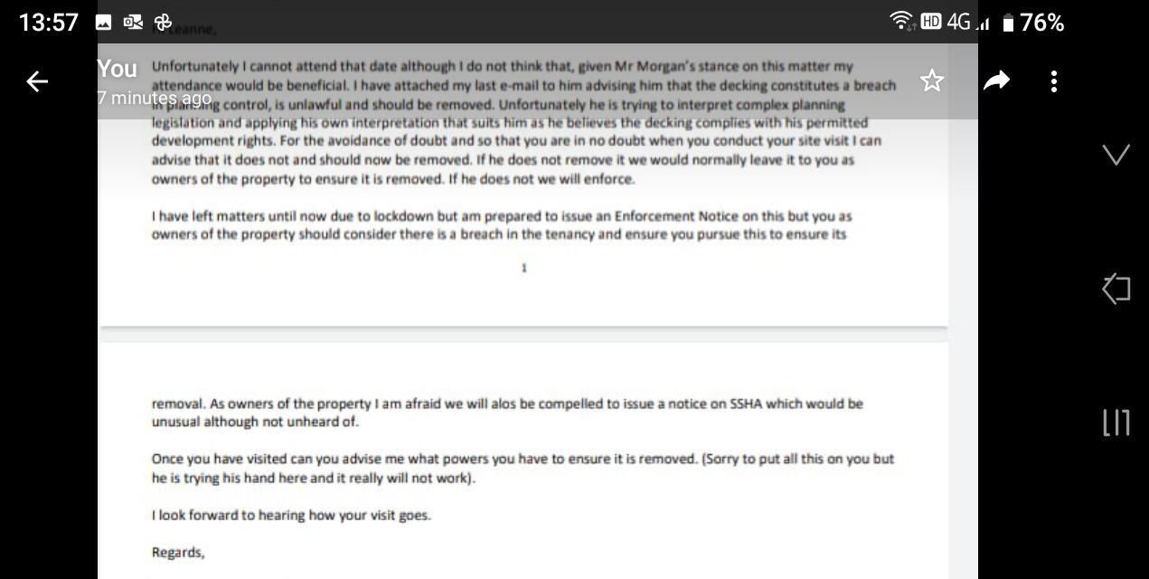

More bullying tactics from planning enforcement to housing association
If I were you (and I may be foolish) I'd be writing to Planning, openly copied to your HA, stating that you think they are wrong and that they should, if they believe otherwise, commence enforcement action so you can appeal and get a judgement from the Planning Inspectorate, which will provide a clear and unequivocal decision and a legal standing for the council/HA to take any necessary action.
You don't want a situation where a jobsworth at the HA is intimated into telling you to get rid just to get it off their desk.

Update ..
The council planning enforcement department are sending another officer to look.at it again to see if it's worth pursuing. Now that the bully tactics of informing the housing association did not work.

This letter is to the housing association
Hi #######
How are you?
As you will know ########### Senior Planning Enforcement Officer at ####### ######### Council visited us at 3pm on Tuesday with regards to the complaints about decking in our garden.
During this visit she measured / photographed the decking and spent some time in the garden as you did, having a good look at the area to ensure she had a full understanding of the situation and any potential concerns that the planning team had.
I have spoken to ######## over the phone today at 15:20, and she is satisfied and confident that we were correct to challenge #### #### her colleagues decision, and that NO planning permission is required for the decking in the garden, and they have no further concerns.
She also said that she has had fairly lengthy discussions with #### her colleague around how he has interpreted the planning legislation - however she said ####### does still remain adamant he is correct, but they are putting this down to a 'professional disagreement' (her words).
At the end of the phone call she confirmed that the council planning team will be closing this case, as no breach has occurred.
###### will be writing to the complainant to notify them of the outcome too.
I hope this settles the matter for you too. It would be really helpful if you could let us know in writing (email or letter) that you are satisfied, and have no further concerns regarding any of the complaints received about us.
Many thanks for all your time in these matters.
