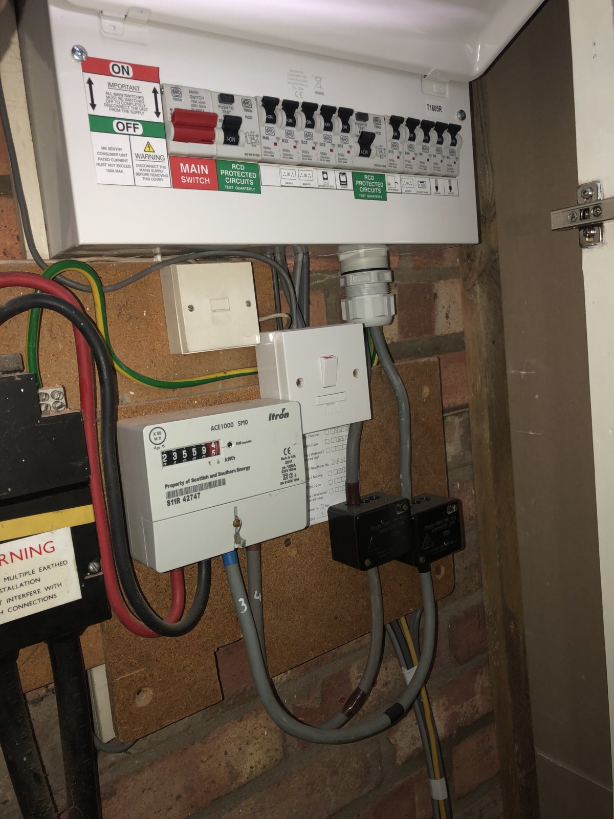

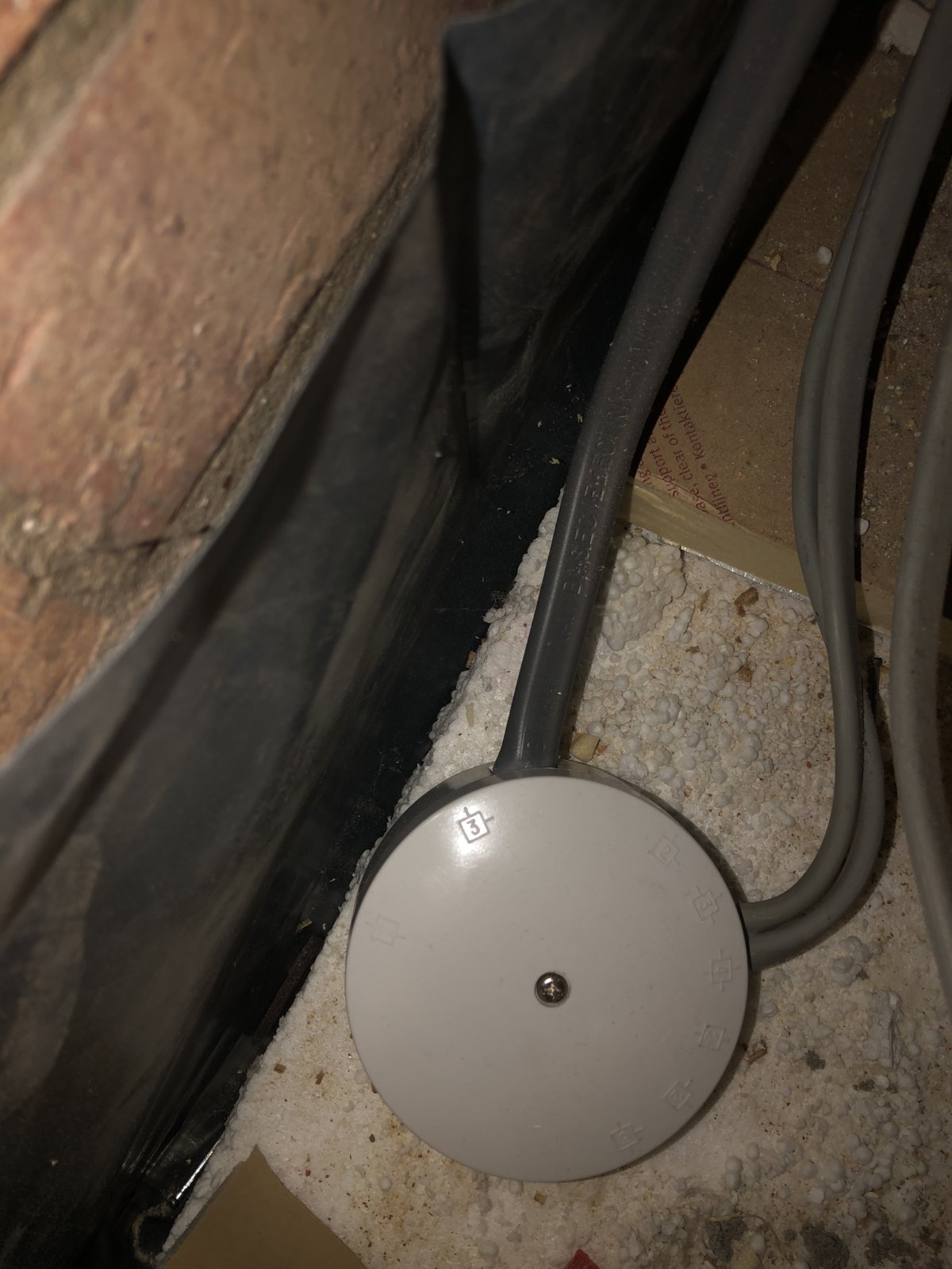

Below two images you can see consumer unit
And her 4mm cable (for whatever reason) split into two smaller cables ....
One goes to her double oven that’s gas (electrics required just to ignite?)
And one goes to a nearby socket

If the cable does not run through any thermal insulation nor any conduit, then 4mm² is adequate and satisfactory for 32A circuit.
This allows upto 15kW of cooking appliances to be connected.
At my new place - i've only got a 4mm cable that splits to TWO 2.5mm cables.
Then that is likely adequate for connecting an oven to one and microwave to the other.
and one goes to the socket - leaving only more - yet I need an oven and separate MW.
Oven on one, microwave and socket on the other.
OR
fit a second socket to the socket leg and plug in the microwave.
We don't have 16A fuses nor fused sockets - fit a 13A fuse in the plug.

Dave, I’m sorry, you need to get your facts straight before you waste anybody else’s time.
The circuit is 2.5mm and a 16A breaker on it.
So, to rewind a few days, you’ll need a new circuit, or a much smaller oven.
