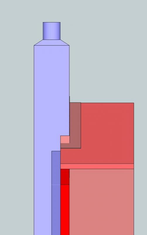

First, you need to understand some basic property ownership concepts
Here are two images showing the chimney between the two terraced properties. Yours is on the left in blue, and the neighbours on the right in red.
Everything in red is owned by the neighbour - so he has half the party wall, the roof above his property to the centre of the party wall, and the flashing to his roof.
Everything in blue is yours, and you can see how the chimney goes over onto his half of the party wall as it leaves the roof. This will be the boundary also. So yes, the chimney is owned by you.
The leak which was described earlier (by the EHO) is typical of a leak from flashing. I can't be 100% certain having not seen it, but that's what I am going to presume. And its what you are entitled to assume until proven otherwise [by the neighbour] via a full and detailed inspection
As such, the leak will be via defective flashing. This flashing on the neighbours side of the chimney will be the neighbours responsibility as it is flashing to his roof. In legal terms, you have given him the right to install flashing to your chimney to seal his roof
So that's the gist of ownership and responsibility

Personally I wouldn't worry about this, its a party wall is it not ?
The landlord is trying bullying tactics for you to pay for the work, where the neighbors roof abuts the chimney stack its their responsibility.
Have you been inside the neighbors property and seen the damage ?
If its the flashing on the neighbors roof that's failed hows that your problem ?
