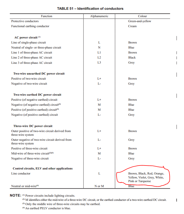

Being used to all black wires with physical tags to denote the wires function, I presume the colours as per my schematic are correct, but that ends up being a lot of brown sleeving in the boxes - any way I can reduce confusion on this by using alternative colours such as red/grey?
You may (are allowed to) use physical tags.

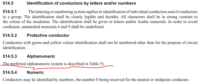

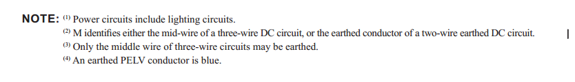

Huh... TIL, never seen it in a domestic setting, is there a widely-recognised/general convention as to the actual content of the label? E.g. '230v' or 'L' for the live?
I did see table 51 whilst trying to research this, but footnote 1 suggests a lighting circuit is considered as AC power and not Control circuit?
