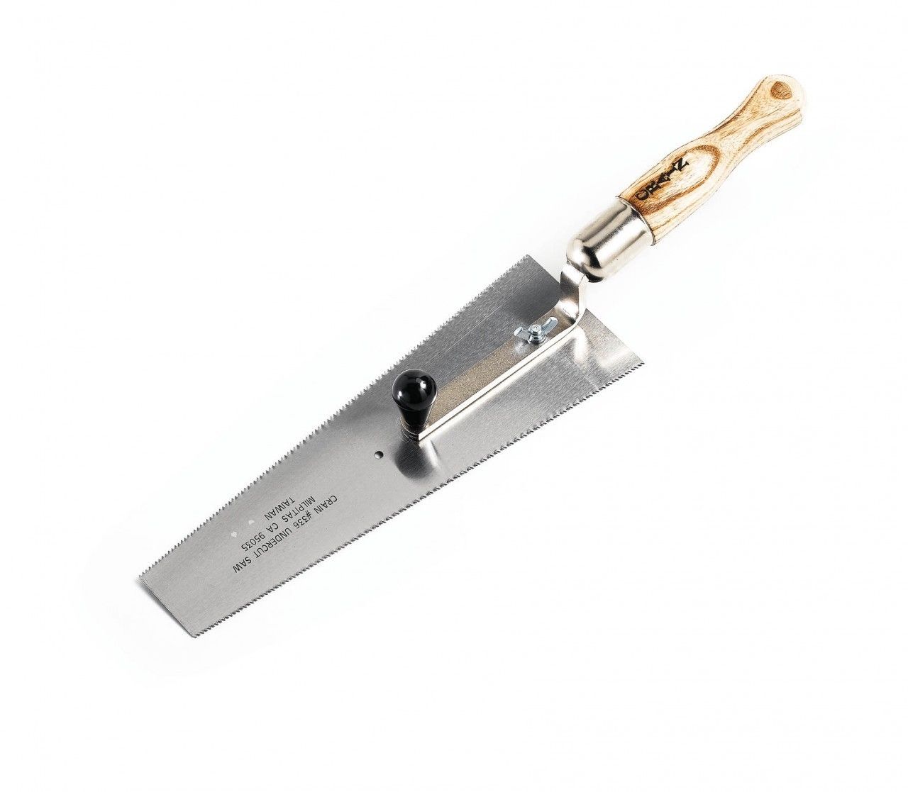

I was told you can cut the bottom of a door in situ with these? Really? I don't see how it can get to the extreme edges without cutting the casing.
You either need a Multitool or a Japanese flooring/undercut saw to finish the cut:
or you run the risk of hitting the door casing with the saw, even if the door is propped open. It's hard enough keeping the saw on the rail and the rail on the door, especially when you are doing multiples. A proper Crane or Roberts jamb saw seems a better proposition as they register off the floor itself
Thanks J&K, I cant see myself doing it TBH I'm happy removing them and taking outside.
