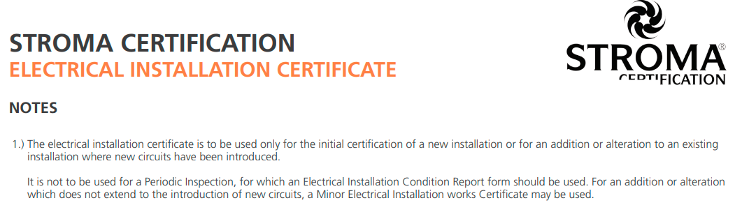

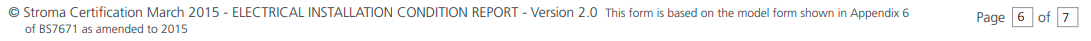

In any event, the OP's posted EIC (now seemingly disappeared from the forum) was a little odd, due to what appears to have been a 'printing error'. It consists of page 1 to page 7 of a "Stroma Certification" EIC report, all but one of which pages has a footer such as:
The one exception is page 6, the footer of which the OP brought to our attention. Although the page starts ...
.... making it very clear that it was for EICs, and should not be used for EICRs, the footer of just that one page reads:
... which presumably was just a 'printing error' on the part of Stroma (and, in any event, this page does not actually contain any 'reported material' - it's simply printed 'notes'.
For that reason , as I wrote to the OP, it clearly was, and was intended to be, an EIC, and not an EICR (despite that one footer).

But that contradicts what is on the certificate "This Certificate is intended to be issued only for a new electrical installation or for new work associated with an addition or alteration to an existing
installation. It should not have been issued for the inspection of an existing electrical installation. An “Electrical Installation Condition Report“ should be issued for such an inspection.

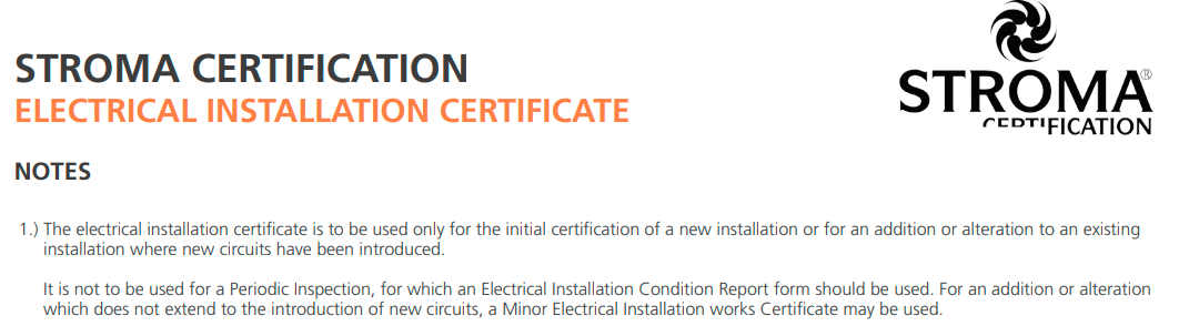

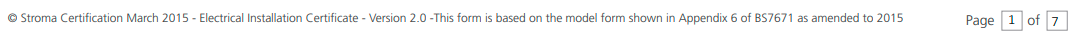

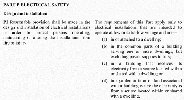

The BS 7671 is not law, the Part P regulations are law, so the Part P regulations allow the use of an EICR to verify work done by a third party, any it makes it clear the EIC and/or the EICR does NOT need to be given to the owner, if done the LABC can retain them without passing them on, only the completion certificate is passed to the owner.
Clearly not the same with scheme members and compliance certificate they do get the EIC but still it is the compliance certificate which is the legal document and is the bit that matters, not the EIC. So all down to what the compliance certificate says.
I made no mention of "unlawful".
You are doing it again Eric. Part P is THE LAW and is A one sentence vague statement.
Again - That's it; there is no more.
If you are referring to Approved Document P then you should say so. That is merely a guidance book written by someone and has no authority in law.
There are also many other Building Regulations which state all sorts of minor things.
