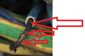

Copper oxides are cupric and cuprous one is green and one is blue but looks black on cables it is normal and will not build up where clamped so only a problem when the cable is removed and refitted when it can result in a high resistance, it means there is moisture in the air. There does seem to be issues, giving a F1 code is not really acceptable when there is full access, the inspector is suppose to be trained and should not need to phone his boss for advice, if he needs advice then the boss should have attended in the same way I can't with pictures say OK or not OK neither can his boss.

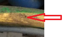

It looks like we can see the extent of the black is only on exposed metal.
The mucky deposit:
is not the usual dust I expect to see in a CU.
These added together convince me this is an atmospheric issue. How much black mould is there in the property?

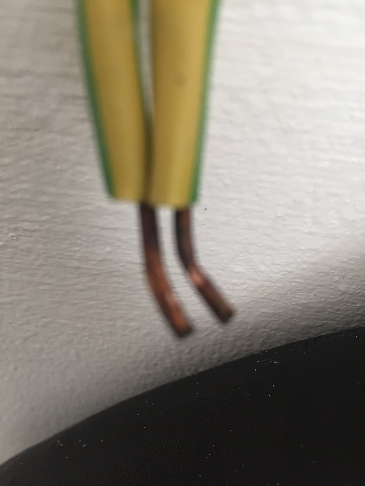

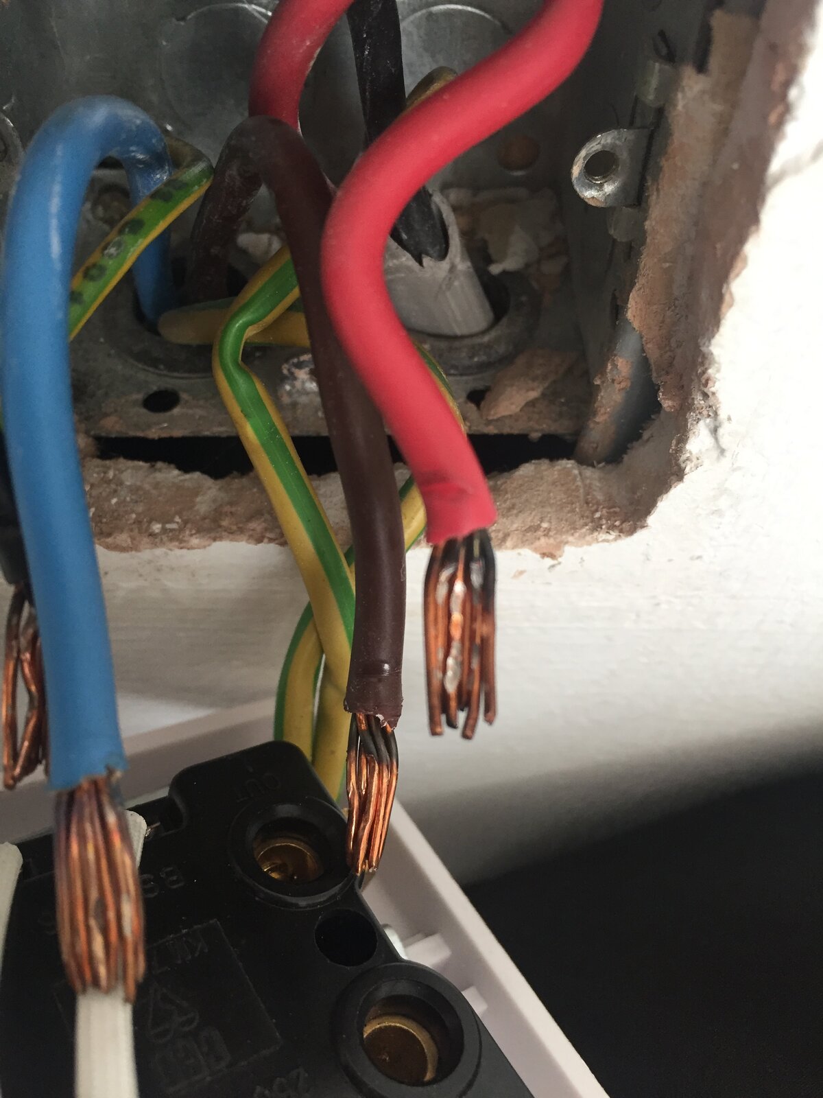

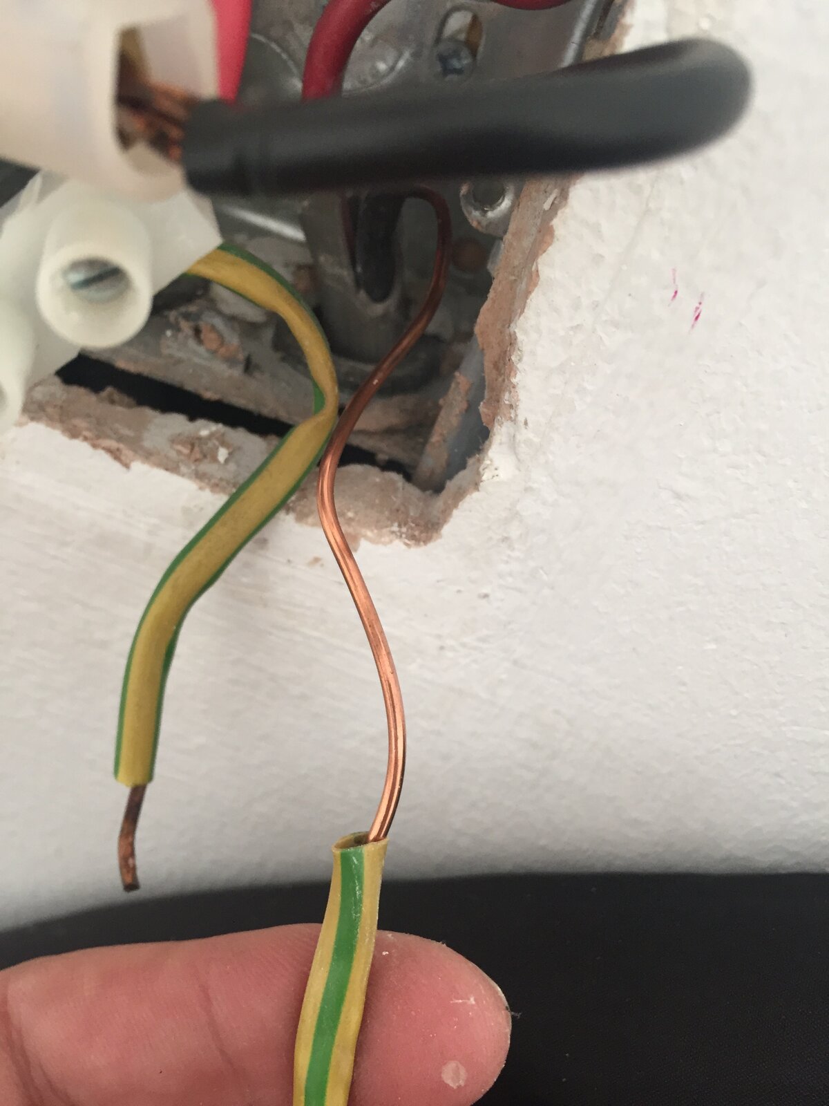

I also noticed the conductors in the shower switch are dark at the ends, but clear under the earth sleeving.
Surely if the earths are also dark it doesnt indicate overheating ?
Dark indicates moisture, it is copper equivalent to rust. Getting copper hot gets rid of the oxide.

Thanks, they gave “F1” code, “Further investigation to ascertain fault on circuit. on the black cables its “Further investigation to ascertain extent of thermal damage”
Ah, that's pretty sensible, then (for the blackened copper) - I might well have considered the same if it were me. It's so unusual for it to be widespread that I would certainly agree that one probably ought to get to the bottom of the explanation.
