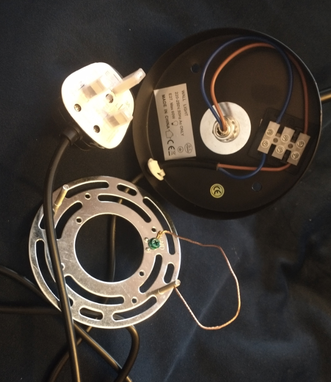

Bought a wall light from Amazon which I planned to install plugged in to a mains socket. Went to put it up today, but found there was no earth in the wiring, just live and neutral.
The light has a Class 1 label on it, so my understanding is that using it like this would not be OK, earth is required.
The mounting plate even does have a ground cable to wire into the connector block, but doing this on the supplied cabling would not connect the ground to anything (see picture)!
The product page on Amazon has a question from someone about this (the instruction sheet does not mention earthing at all) and someone else has replied to say that the earth wire needs to be connected if you are "hardwiring" (I assume they mean installing into lighting circuit) but is not required if you are plugging it into a standard socket.
I think this is wrong, can anyone with electrical knowledge confirm whether I am right? Am I missing some reason why earthing is not needed if using a plug rather than "hardwiring"..?!

The middle connector is likely on a metal tag connecting it to the base ready for the supply earth to be connected, so it should not be used without an earth.
If any parts of the fitting are metal, (and they look as though they are), then you need an earth regardless of how you are supplying it with electricity.
Send it back and make Amazon aware why you are returning it.

It doesn’t look as though the earth connector is actually attached to the metalwork of the light fitting which is a bit of a concern.

I believe all I need to do is replace the cable from the connector block in the picture back to the plug, and then connect the ground strap on the wall mounting plate to the other side of the connector block. Actually, this would be a very simple job... I don't have to change the supplied live/neutral wiring from the connector block into the light fitting, right?
Can someone confirm that would be a good and safe fix?
