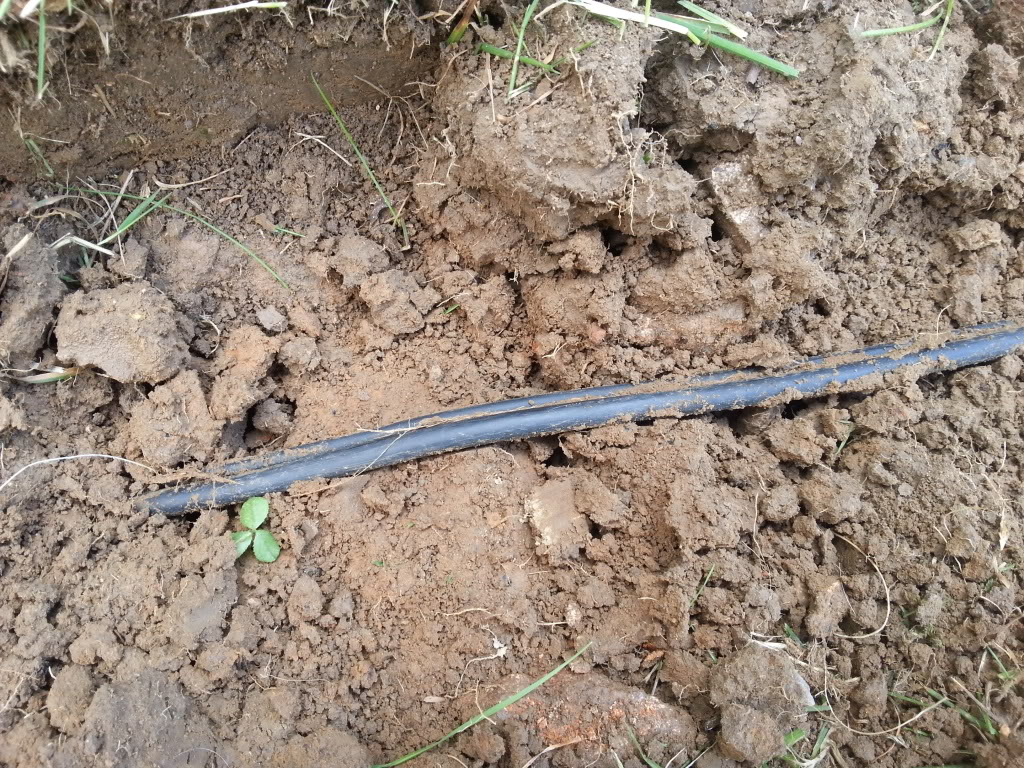

It was only when I was repairing a fence post that I noticed the neighbours identical wire stapled against it, otherwise I'd be querying this would you all also!
virgin duct is usually green. Black is usually electricity.
Black cable is also commonly electricity. Is it about the thickness of your finger, and shiny?
But a DIY duct is often done in what's handy, e.g. rainwater downpipe is often black.
Virgin cable (that I've seen) is brown "shotgun" cable shaped in cross-section like or sometimes like 8
Thanks for the info John.
As it was the exact same wire as next door, I stopped worrying about it. Like you say it could be a DIY job as I doubt Virgin would have dug underground to the extent. I might catch up with the neighbour and check if he knows what it might be.
I’ve an attached an image, it’s the same wire but in black.
Any ideas?

I just realised the pipe is being fed by the gutter downspout/pipe.
Question is, how best to protect the pipe? It won't suffer any real weight...would laying concrete around the pipe help at all?
Given it's leaking/broken you have missed the boat on protecting it from damage and now should replace the pipe and ideally dig out deeper. Unless you're using it as a soakaway. You won't really get a better opportunity than this to sort it out!
Regarding the concrete it's not recommended in case of movement and you're supposed to lay it on gravel to allow it to flex slightly.
