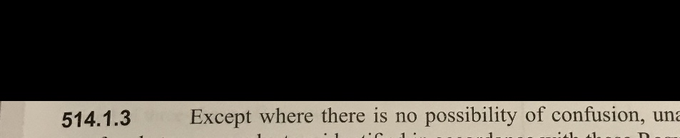

Can you prove this statement?
Here’s an actual photo of that regulation.
See how easy it is to provide proof to support a statement when it’s not just made up?
The regs do not say “do not apply brown sleeving if this may cause confusion” nor do they say “except where there is no possiblity of confusing an electrically competent person” .... The regulation says “where there is no possibility of confusion”

Here’s an actual photo of that regulation. ... See how easy it is to provide proof to support a statement when it’s not just made up?
Mine was a screenshot of a PDF, so almost as good as a photo to demonstrate how easy it is to 'prove' something!

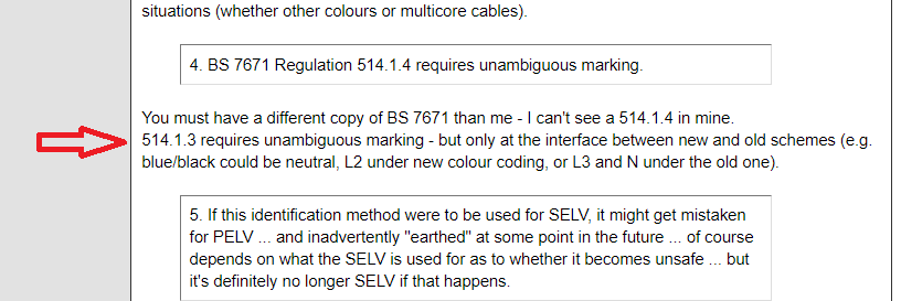

HOWEVER, I have just now realised that RF and myself have been quoting the wrong regulation, with the effect that EFLI, RF and myself have probably been mis-representing what the regs actually say...
Regulation 514.1.3 (which talks about "except when there is no possibility of confusion"), quoted by RF and myself and implicitly referred to by EFLI, relates specifically (and only) to the interface between wiring in old and new colours.
As far as I can see, there is no corresponding "except when there is no possibility of confusion" clause in any of 514.4 or its sub-parts (which is the section relating to identification of conductors).
It therefore seems that, with the possible exception of interfaces between old and new colours (which, as above, would seem strange/confusing) there is, in general, NO actual provision in the regs for omission of identification of conductors "when there is no possibility of confusion".
My apologies for having been part of the creating of this confusion and possible 'mis-information'.
