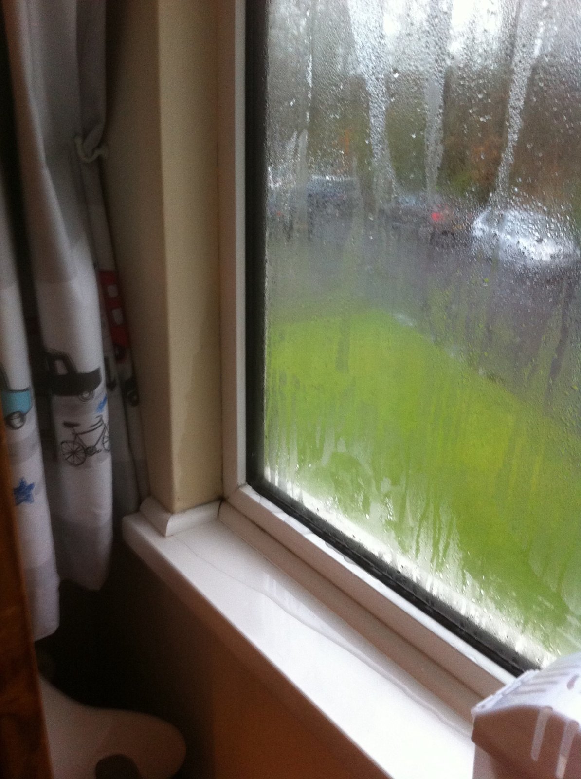

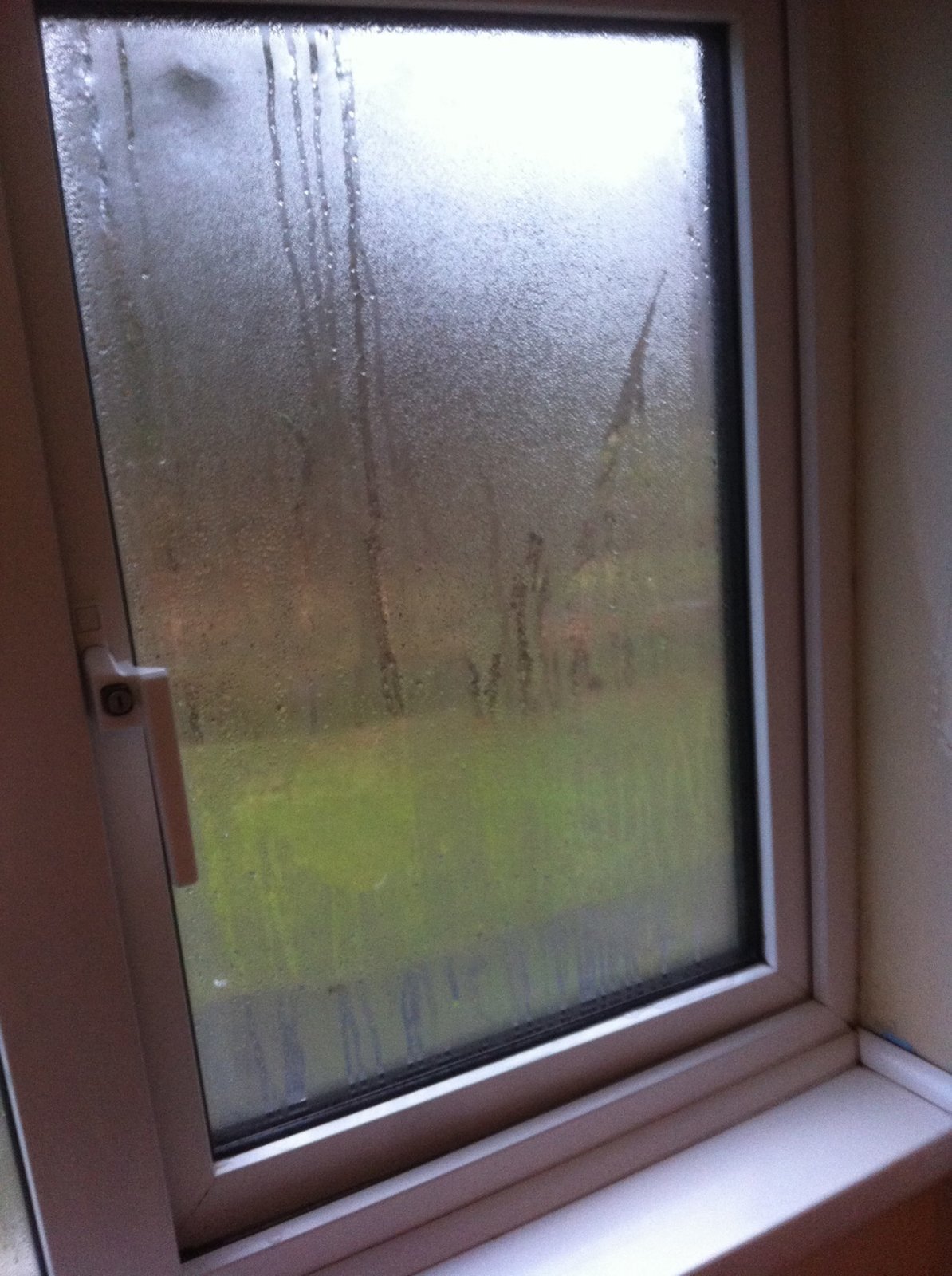

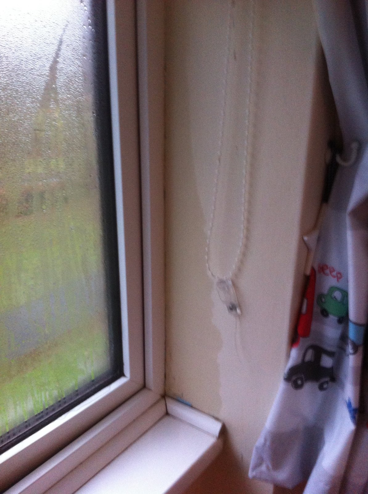

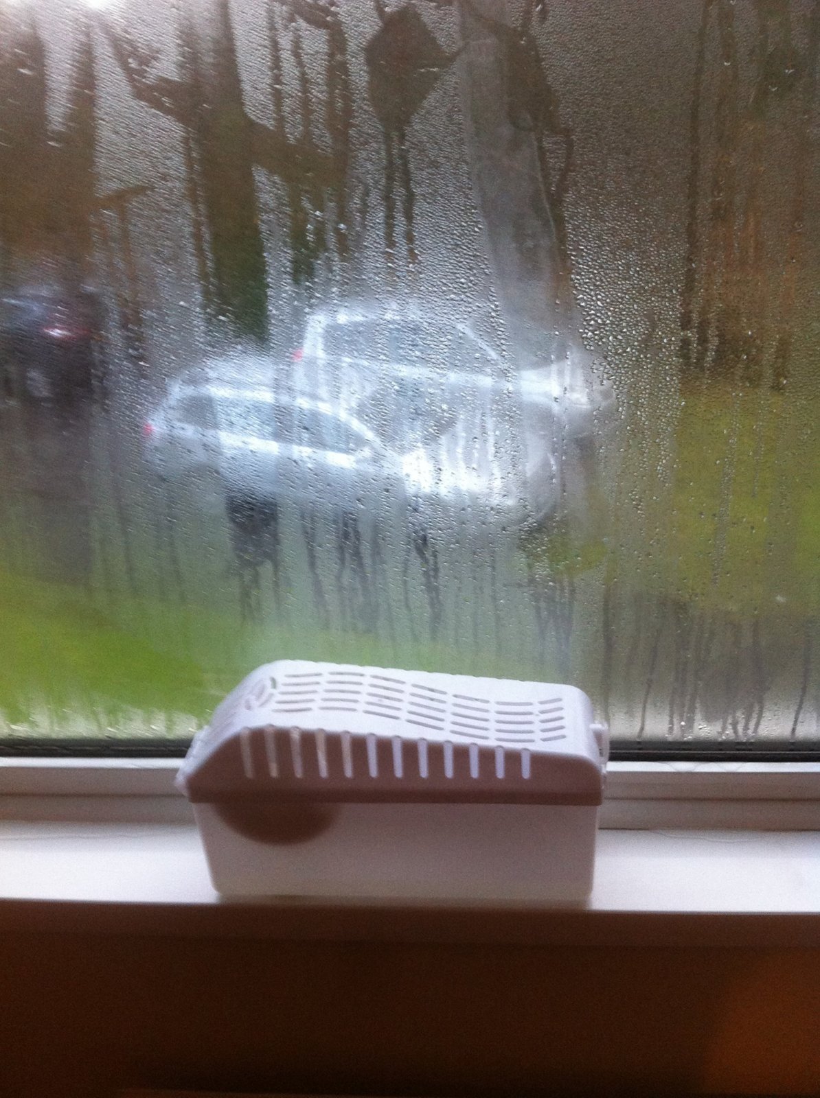

Many thanks to all. Just been reading through all comments and there's some great info there. My biggest hurdle is to get them to actually believe me. They pick out petty unrelated stuff and believe that's the problem. I did buy one of those mega moisture traps from screwfix a couple of weeks ago. As well as the current wet walls, window and puddle on sill, that moisture trap had half an inch of water in as well.
Unfortunately LeeFoo, you are fighting a losing battle with this type of tenants. If you can't get them to see reason, then nothing will work, because whatever you do won't work (unless there are enough gaps in each room to let the PIV unit do its job) as they refuse to consider they're at fault.
You certainly need to up your game in terms of landlords legislation etc, and find a new letting agent. Find out what it'll cost you to replace them, and then be tough with them and point out they are ruining the property, and will be in breach of their tenancy if this continues.
You could just replace one of the panes to prove it's not the windows, but looking at that, I'd just call then a bunch of effing liars, and kick them out. That level of condensation means they haven't opened the windows since the weather turned cold, and everything in that place will be filling with condensation. A new pane will work better, but you shouldn't be having to contend with those moisture levels.
