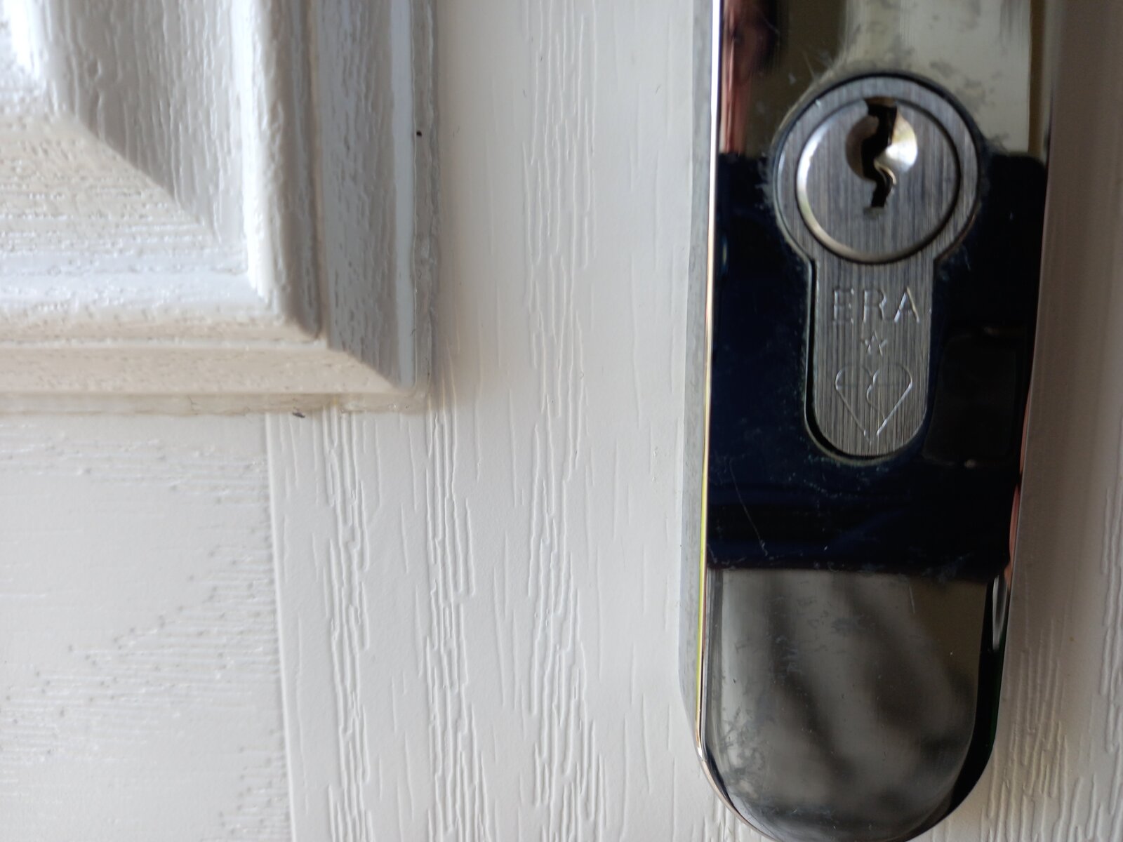

Photos of the key and lock would give more clues. Include closeup of keyhole.

The key goes in fine on some days...not on others. And once the key is in it turns freely, the issue is getting the key fully in and it is a random issue sometimes as normal and other times not. New door last winter, nothing worn, original key etc. Same things happen with spare keys given by the installer. So whatever it is causing this it is not the key/s

Suggest the key is not at fault but something has happened to the outside keyhole
For example dirt, glue, chewing gum, attempted forced entry with tool or deliberate damage with screwdriver
Or it might just be tight if new and hardly used
So, close-up of external keyhole, please

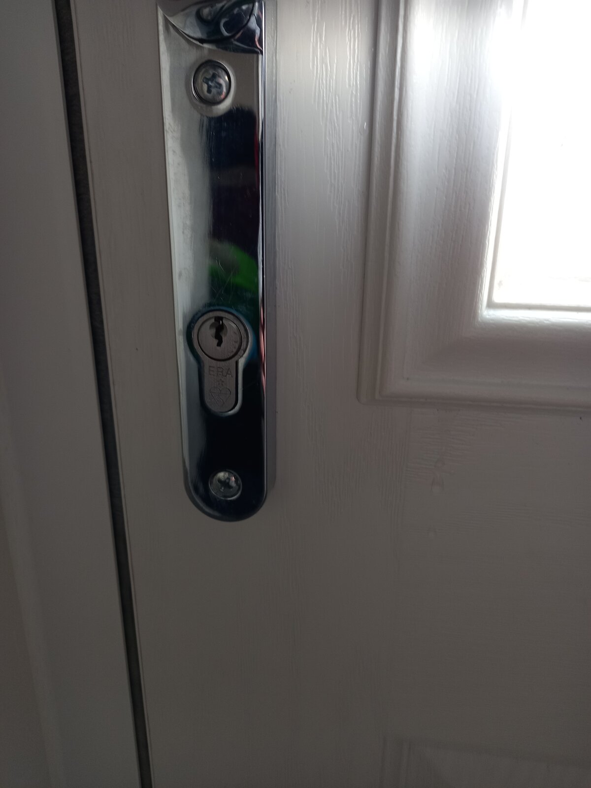

We cannot see anything in there.. and if it was chewing gum or something it would stick every time? maybe get the landlord to sort it out. We just thought if it was something simple we could sort it ourselves. The will go half in only sometimes, and needs a push to go right in, always turns fine once in. Some days it goes in fine.
I can't see any marks or damage. Some locks have a hinged shutter to keep out dirt, but I can't see one.
It might possibly need wearing in, if you repeatedly push the key in and out, it might wear smooth.
Look at the key afterwards for any traces of grit, as might occur from building work.
Might have happened if key was previously dirty, e.g. dropped in puddle or put in pocket with sticky sweets.
Don't use any oil, as this tends to hold dirt.
