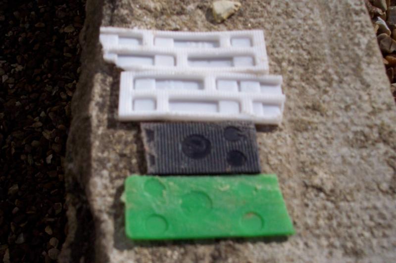

since the double glazing was fitted we have had mild cracking, which I was told was just settling. Could this be related?
Bays are a real nightmare in terms of their construction (shoddy comes to mind but obviously they are not) – yours actually looks a good one – slated over the top well impressed.
The trouble is they are single skin and a right nightmare to support if the windows are changed. I am sure the cracking was just settling but it should not have happened. It could be due to the construction of the windows, the support during the changover or as shytalz says simply down to the packers (believe me they are crucial to a good job). What’s important is does the window look right – if not get them back – it’s clearly not a top notch job and not what u paid for.
These cracks will definitely let moisture in and be the cause of the mould. They need repointing. also check the sealant has no gaps all the way round the window - just a small gap - a few mm will let lots of water in when it rains.
My sentiment is with shytalz. The trouble is your up against it unless the firm is a national with a name to protect. If not I’m afraid if u can live with how the window looks ie levellness than my advice would be to dig out and repoint the cracks, put a mould killer on the wall followed by a stain block and wait and see. I think and hope that will sort it.

Uhoh, alarm bells...still, they might redeem themselves. There is no excuse for any cracking: adequate shoring-up beforehand and packing after installation is all that is required. Oh and the installation of baypoles in circumstances such as yours...
