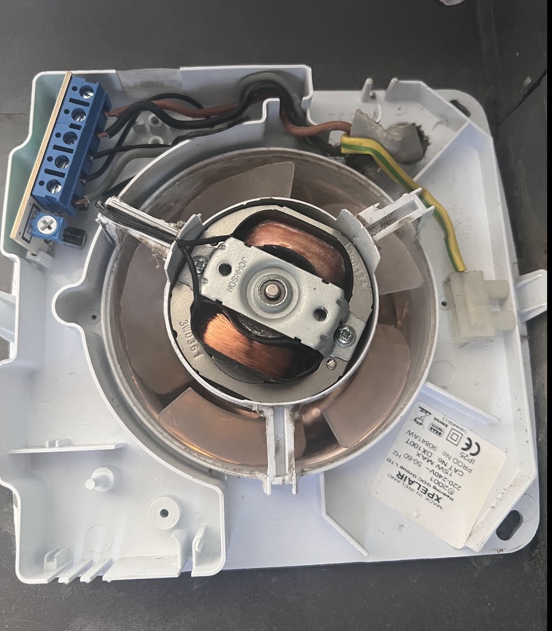

My old extractor fan is giving issues and I got a new one. It has the usual 3 marked ports for L, N and T. But the old wiring uses the 3 core and earth cable, which has a black, brown, grey and yellow/green wires. Does anyone know how to wire it properly? Thanks

If the old fan is still connected then you should be able to determine which wire is which by the labels on the terminals they are connected to on the old fan.
Thanks @bernardgreen On the old one, brown goes into L, black in N and grey goes to one marked I. Attached is the picture. I am struggling to understand what I stands for.

It is common to use cable with cores of red, yellow, blue, or brown, black, grey, but really they should be red, red, black, or brown, brown, blue, so in general the wire colours mean nothing. May be lucky and some one has used red or brown sleeving but in the main it is look how old one is wired.
So if you make sure black goes to N, if other two wrong way around unlikely any harm done.
Seems likely Brown again will go to L.
So grey to T instead of I.
