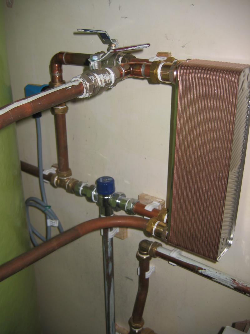

I have connected an external plate HE
What size? (ie. dimensions and how many plates) if I may ask.
Can you post an image?

Regarding your other question about the PHE. It is an Alfa Lavel and using it for heating mains pressure water for the HW. I need another PHE for heating the store via the boiler.

Its looks a decent plate anyway.
The flows seem to be parallel though and would be more efficient counterflow.
Is this your work?
The larger the plate the better and you can lower the store temperature and no need for the tmv. Tmv's at point of use if required.
Connect the flow from the other plate lower down on the store if you have an appropiate tapping. That way it will prevent cold glugs being dumped into the top.

Does the green Wilo pump do its pumping upwards or downwards?
